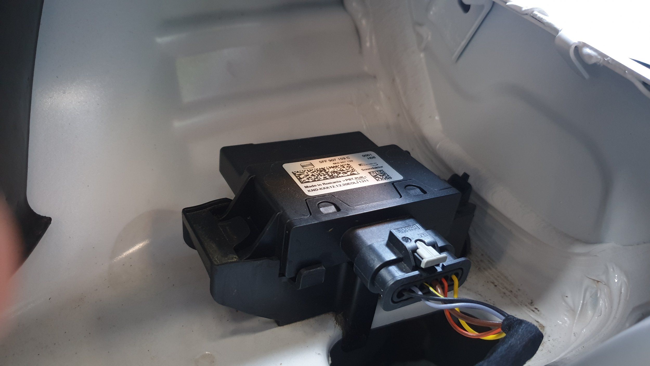

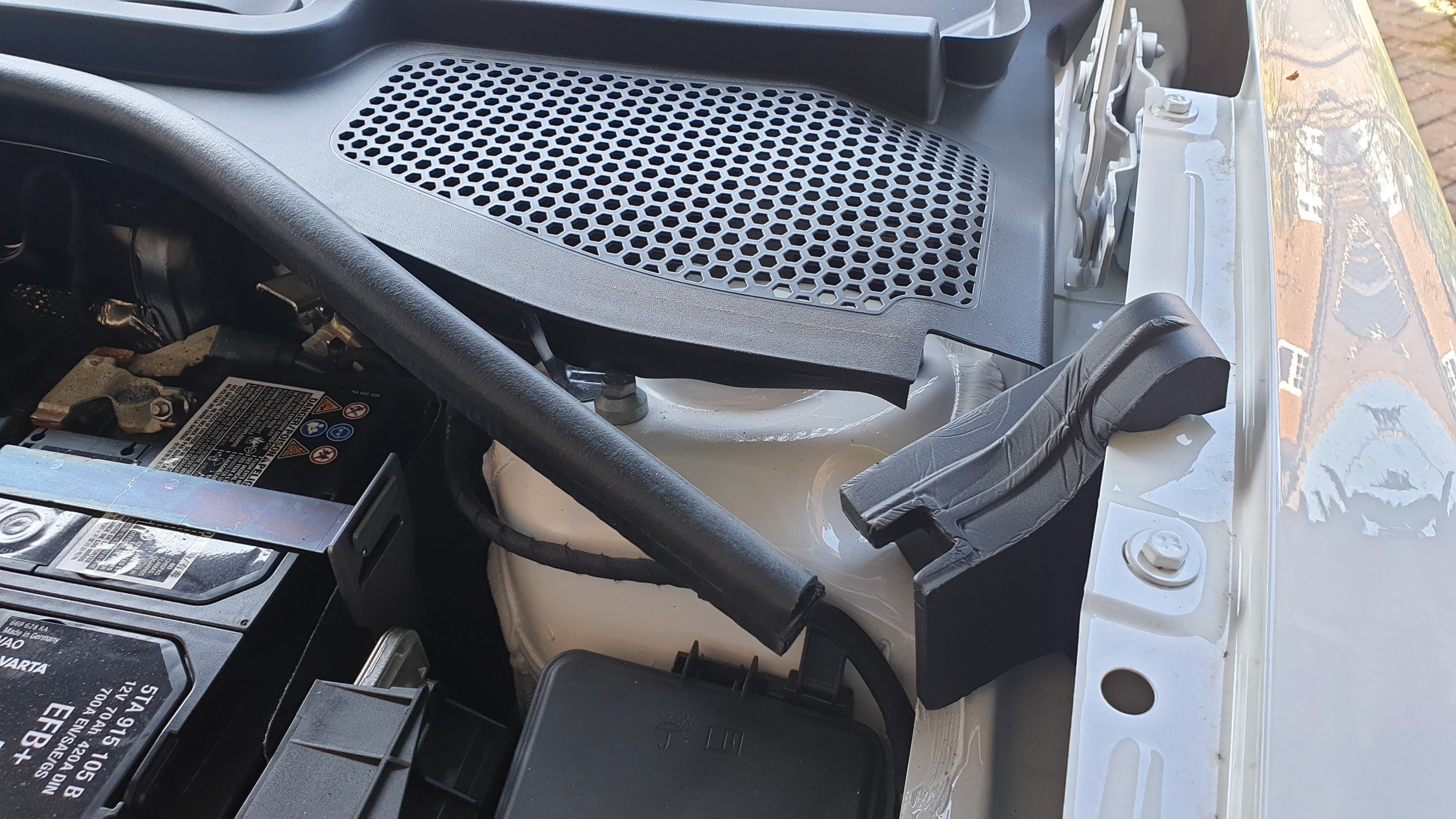

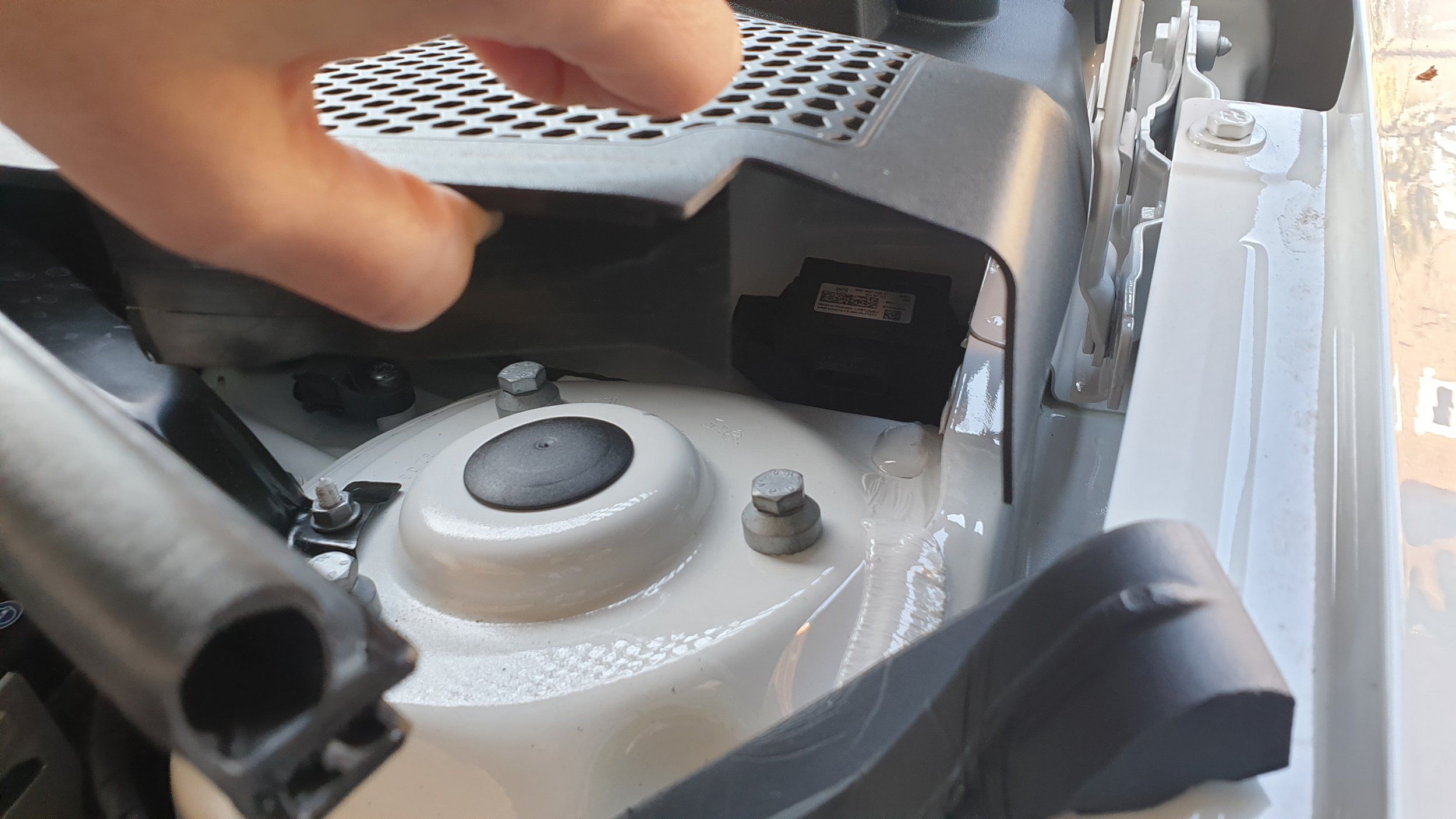

Here's the manual how to physically disconnect Sound actuator.
It's located on the passenger's side of the car. So when you open the bonnet, for RHD cars it's on the right side and for LHD cars it's on the left side. You have to pull away foam, to allow access under the plastic cover.
You will be able to see sound actuator under it. There's no doubt it's the right device, as it has part number and name on it.
Small grey part on the plug requires pulling towards front of the car and the plug can be removed. And that's it. Having small hands helps. You can alway ask wife/gf to do this.
There are no errors when the car starts and no annoying, fake noise.

@Agnes.Surrey thank you for the tutorial! If I understood correctly, first you pull out the "gray/white" part to unlock the plug and then pull the plug?

Yes, small grey part needs to be pulled to unlock the big plug.

Thanks, I've managed to unplug it. For my LHD car, the Soundaktor was on the passenger side, apparently it's opposite of the driver. It seemed to be bit harder to reach then it looked in your photos, but in the end I managed after pulling a bit of rubber protection to improve access to the area.
Plugging it out took a while, I could easily reach the white part to unlock but the plug stayed attached, had to wiggle it out and suddenly it released. Not sure what is the proper motion, perhaps pushing on the white part after unlocking?
