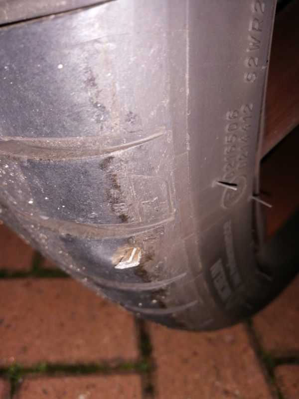

So I'm currently on my knees in the driveway and can't find what to inflate the spacesaver tyre to. Sidewall says 60psi but is that a max? It's currently got about 38 in it. 60 seems really high.
Need it to get me 2 miles in the morning.

I know this sounds weird... but the spacesaver feels rock solid as is. I figured 60psi would blow it up like a tom n jerry cartoon. Also, I assume this is too close to the sidewall? (Not sure on depth as I've left it in for now - but 0psi in it).
Ohh the pain I’m afraid that your correct mate if that tyre is punched then it’s too close to the edge and it’s a new tyre needed as can’t repair

When they pulled it out... it's actually worse than it looked... even though I whipped the wheel off as soon TPMS came on. The bit in the pic is sticking out... the rest of it is actually sticking in the interior side wall. £162 and I can pick my wheel back up at lunch. Just annoyed as I'm trying to wear out the two year old two fronts and had the rears for 3 months.
