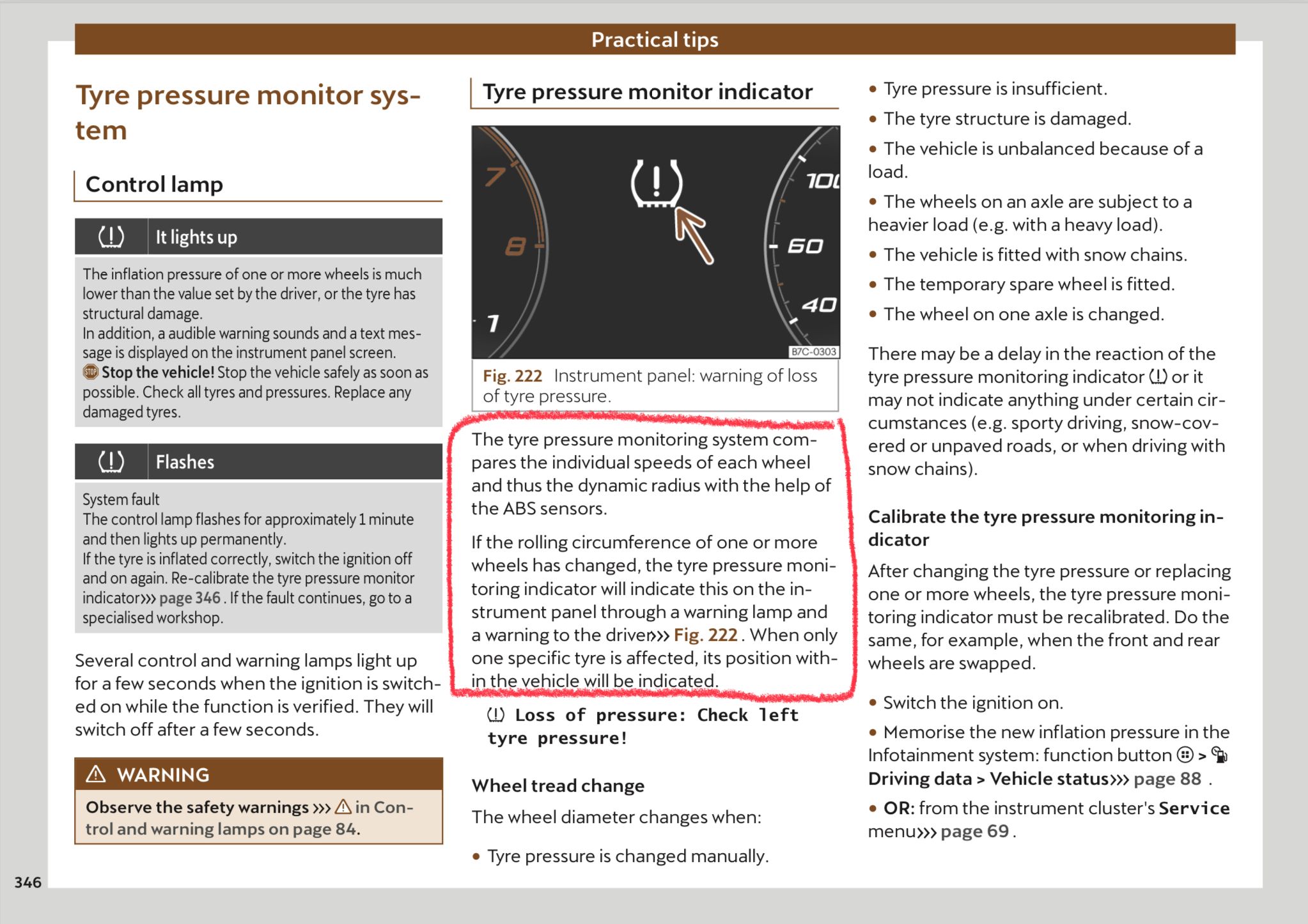

There is an official spare wheel kit (assuming the car isn't an hybrid). Part # for one without Beats is ZGBBOM224SE.
The only thing I can think of which would cause a 'software' issue, is if the Tormenter has full TPMS with sensors in the wheels. Dunno if it does; most SEATS I've met use the ABS sensors.
Reactions: Tell
SRGTD
May 26, 2014
2,720
1,572
The owner’s manual suggests the Formentor also uses the same indirect TPMS as most (if not all) other VAG brand
cars;
