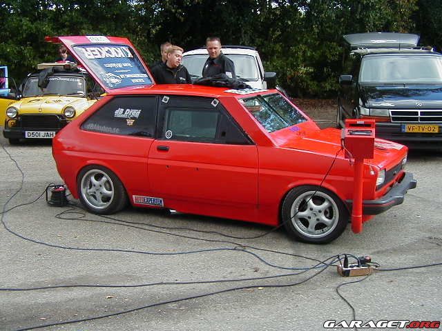

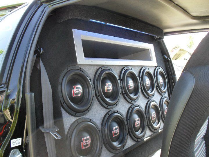

Of course I agree with the impedance, I have been competing in car sound for a few years (dB-dragracing EX1 2004 and Bassrace 2006. I was just wondering if anyone knew about the cables in the doors. Maybe it was a bit unclear in my previous post but anyone who knows where the impedance is on the original speakers, it is 8, 6, 4 ohms. just wanted to know in advance so you do not have to put in unnecessary work ..
