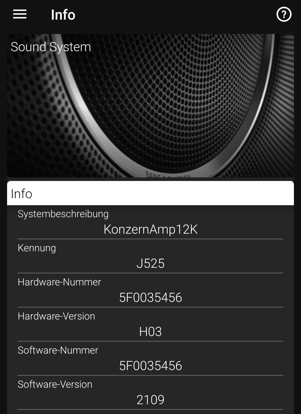

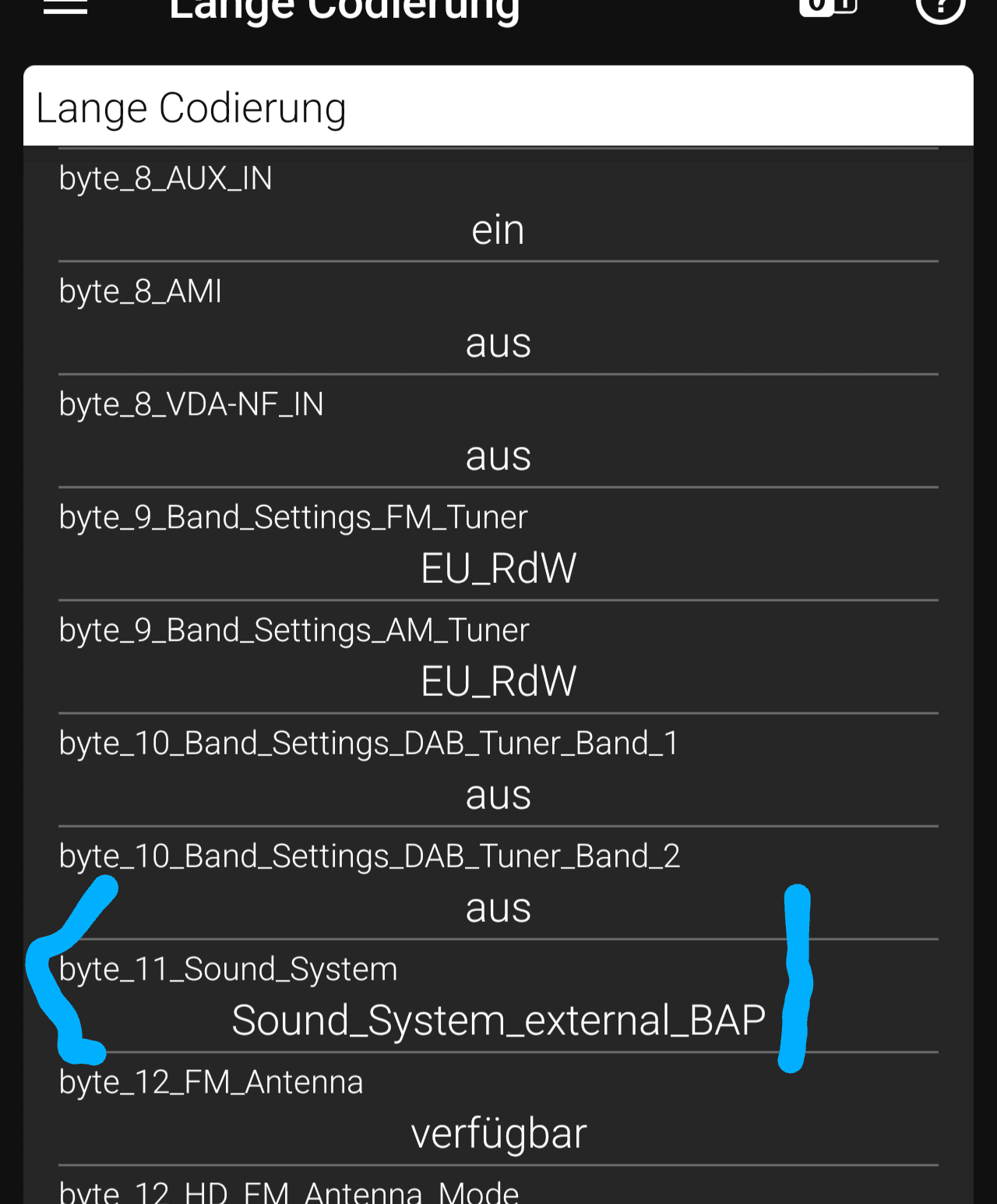

The Beats sound system was also available with CAN control. We have it
