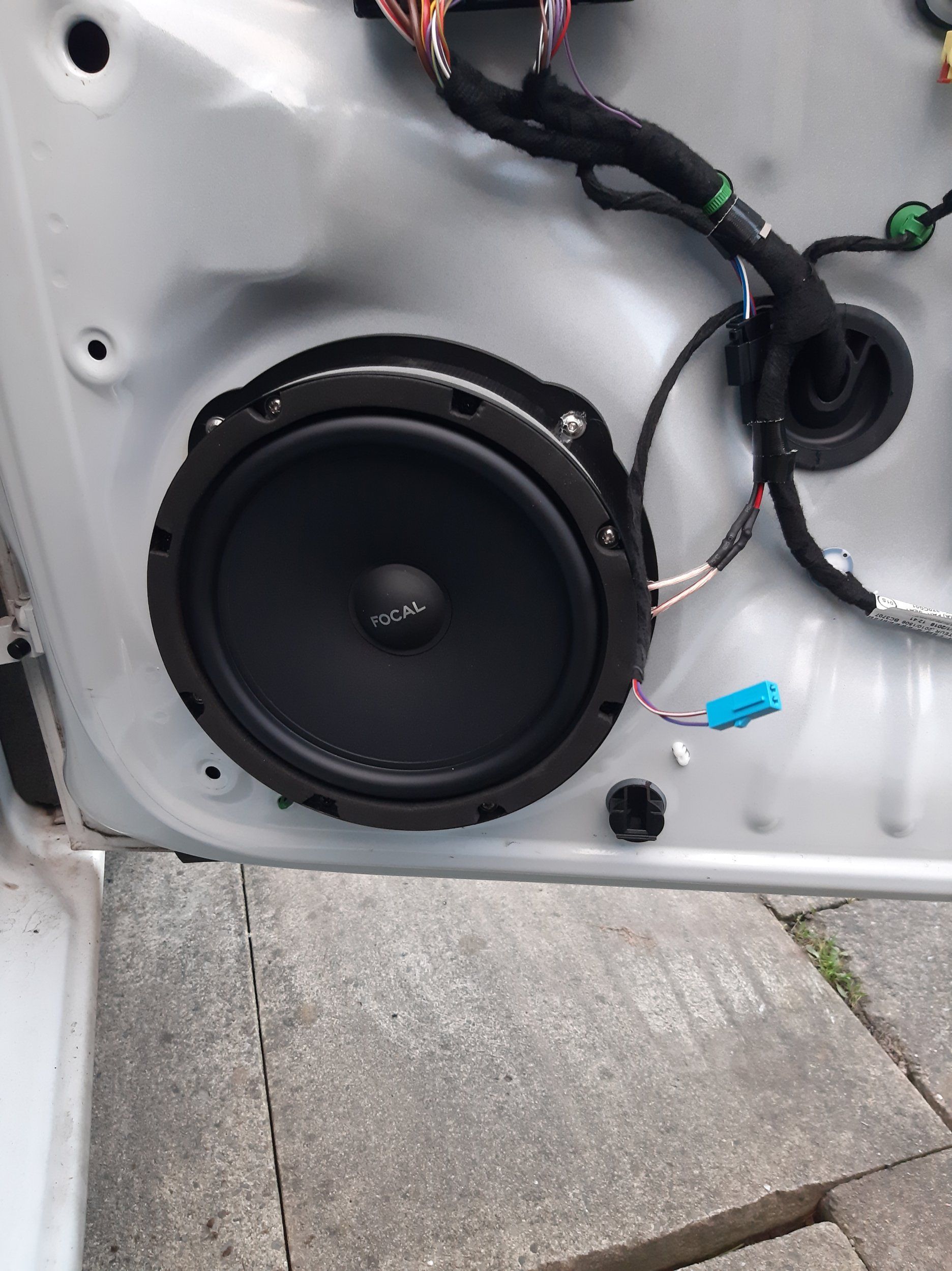

Does the VW connector from the Focal INSIDE plug in the OEM Seat Harness?
And how did you mount the woofers to the door? Do the screw holes from the woofers align with the stock ones, or did you 3d print something?

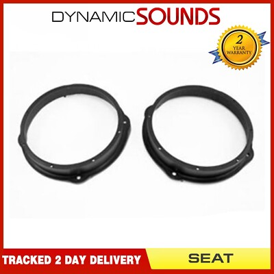

To fit another speaker you would need an adapter - either 3d print one;
or something like Connects2 CT25ST06 (which seems to be discontinued!)

I need to find some already made adapters since I do not own a 3D printer.
And for the wires, I really do not want to splice them. Do you know of any good adapters?
