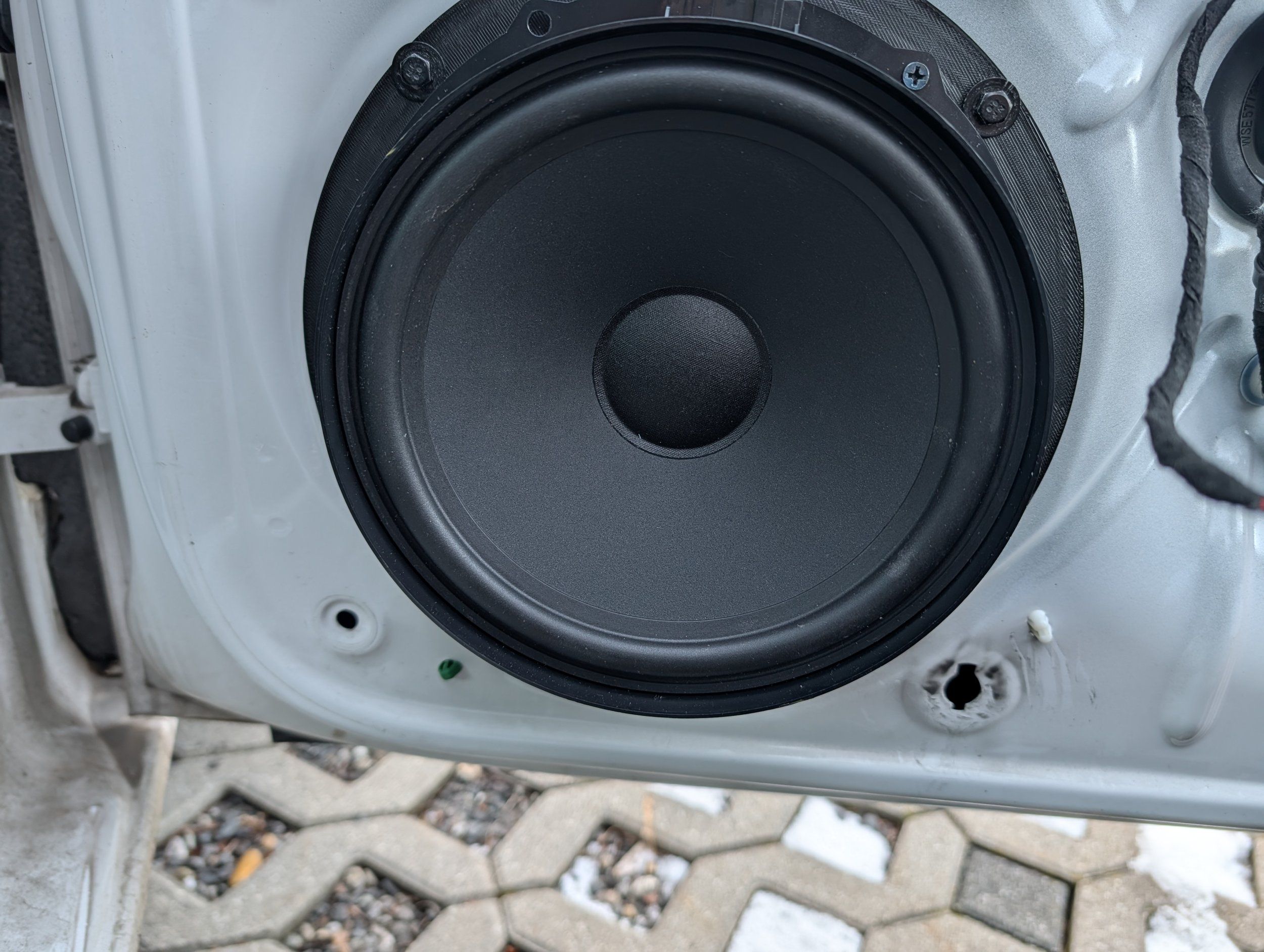

The tweeters have already been replaced. The INSIDE IS VW series is not officially approved for retrofitting in the Seat.
The 180mm Focal models will be installed in the front. The tweeters are the same, whether 180mm or 165mm...

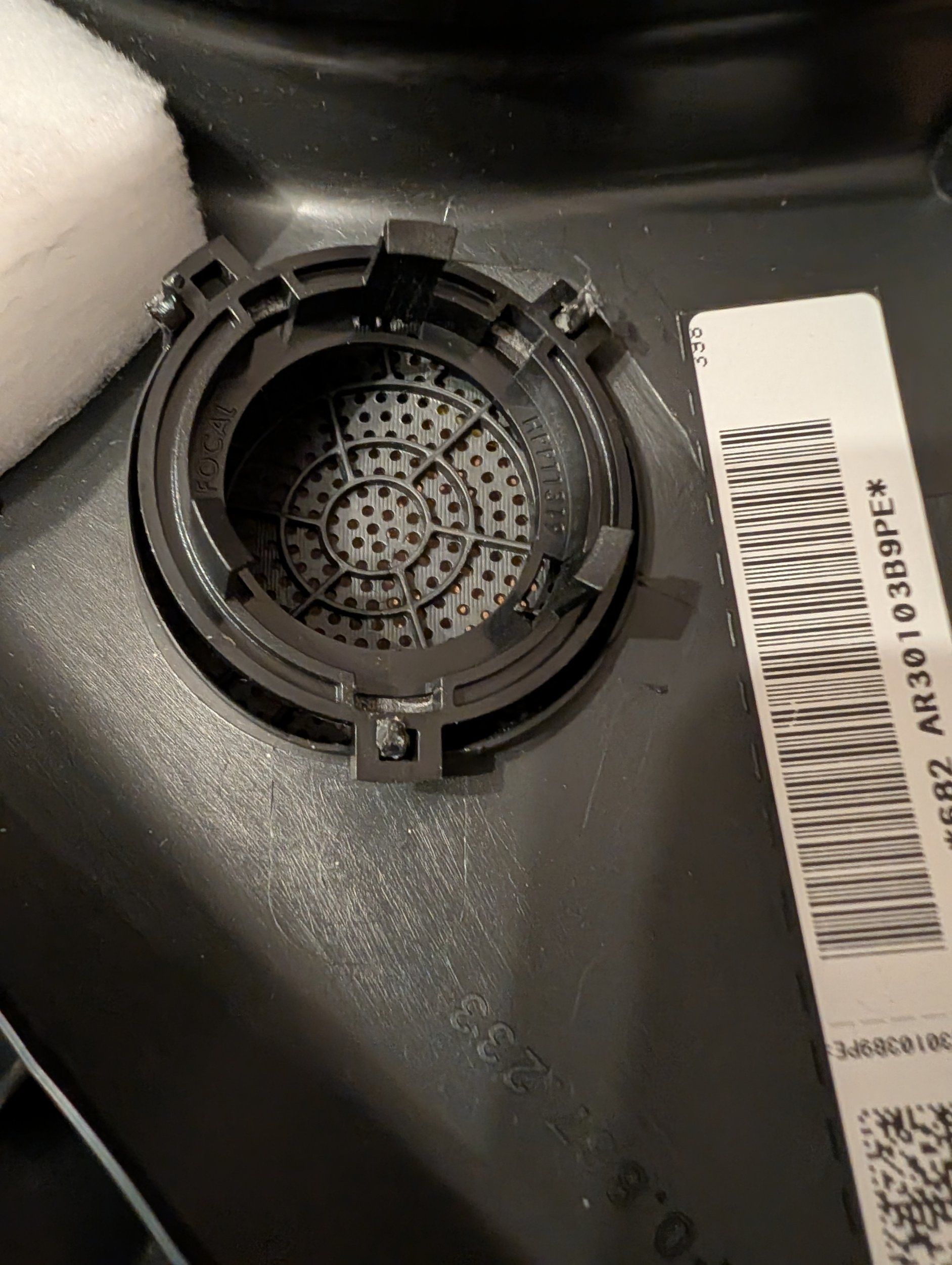

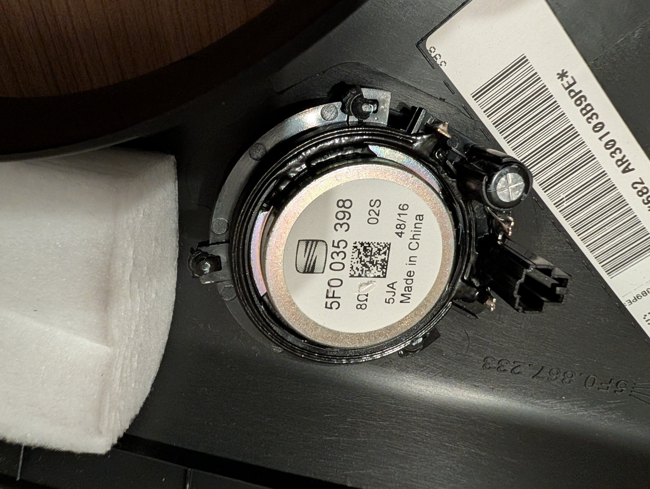

Remove the A-pillar trim, simply pull it off, disconnect the tweeters, and then you can comfortably work on the trim at a table.
- Remove the original tweeters
- Now install the brackets for the new tweeters.

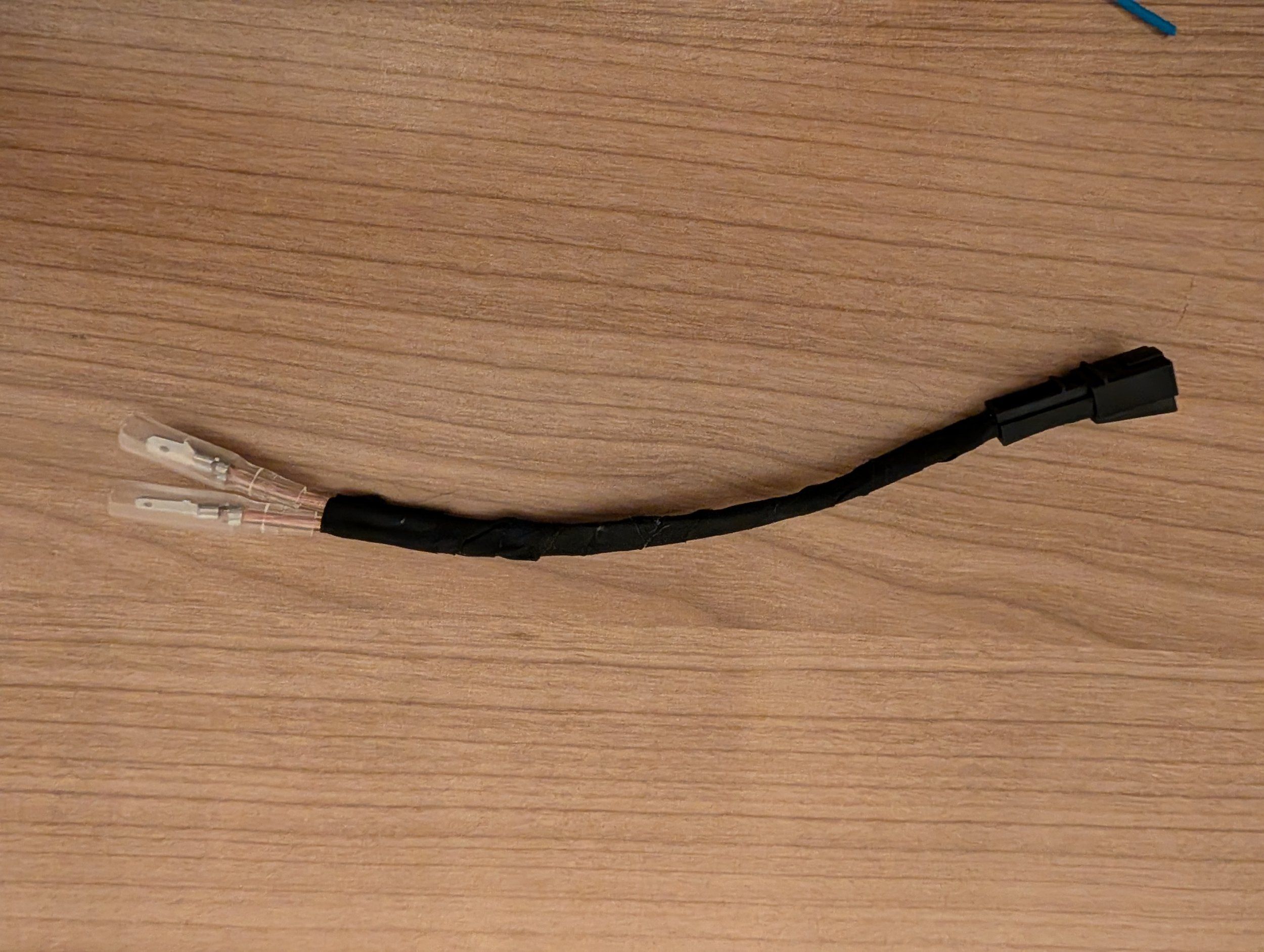

- Fit the existing adapter with the correct connectors so that you can connect to the OEM wiring.
That's sufficient for me for now. I've already installed both sides in the vehicle.

And belive, 180mm Focal are better then 200mm Seat Soundsystem
I've made a small change. It will now be equipped with the CRE400.4DSP-ISO.

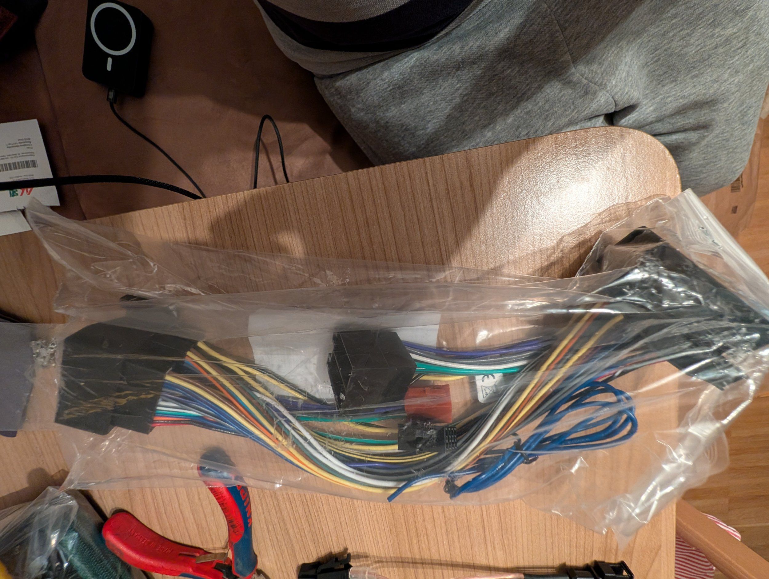

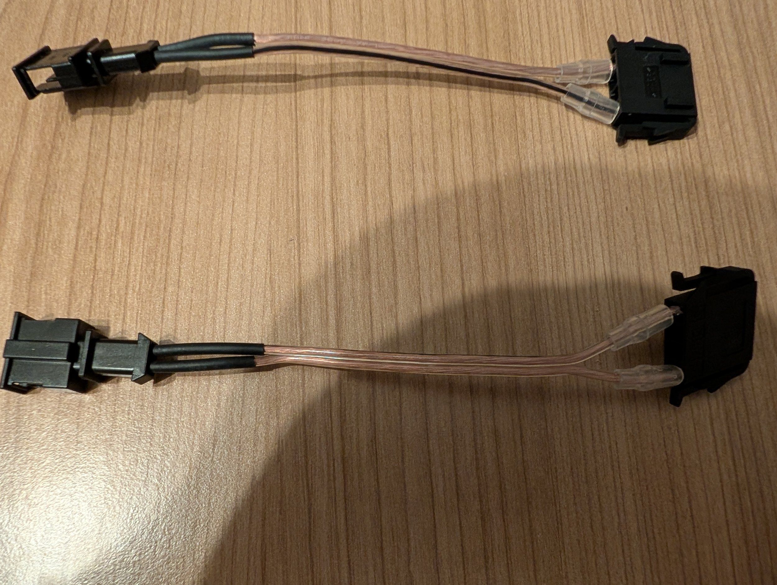

Next Parts
Speaker adapter
MIB---> DSP adapter

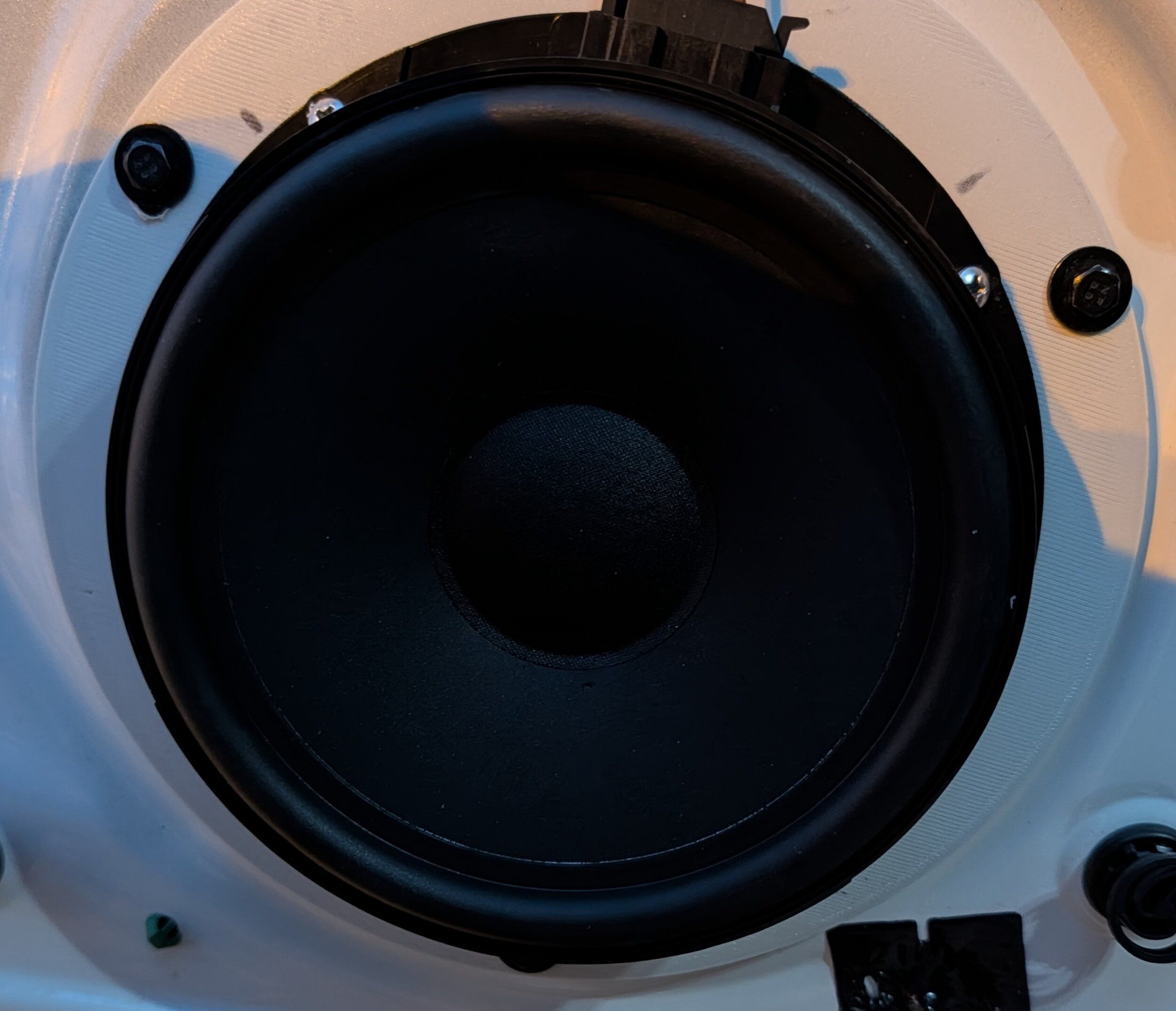

So, the starting signal for part 2 of the VW Focal INSIDE VW project...

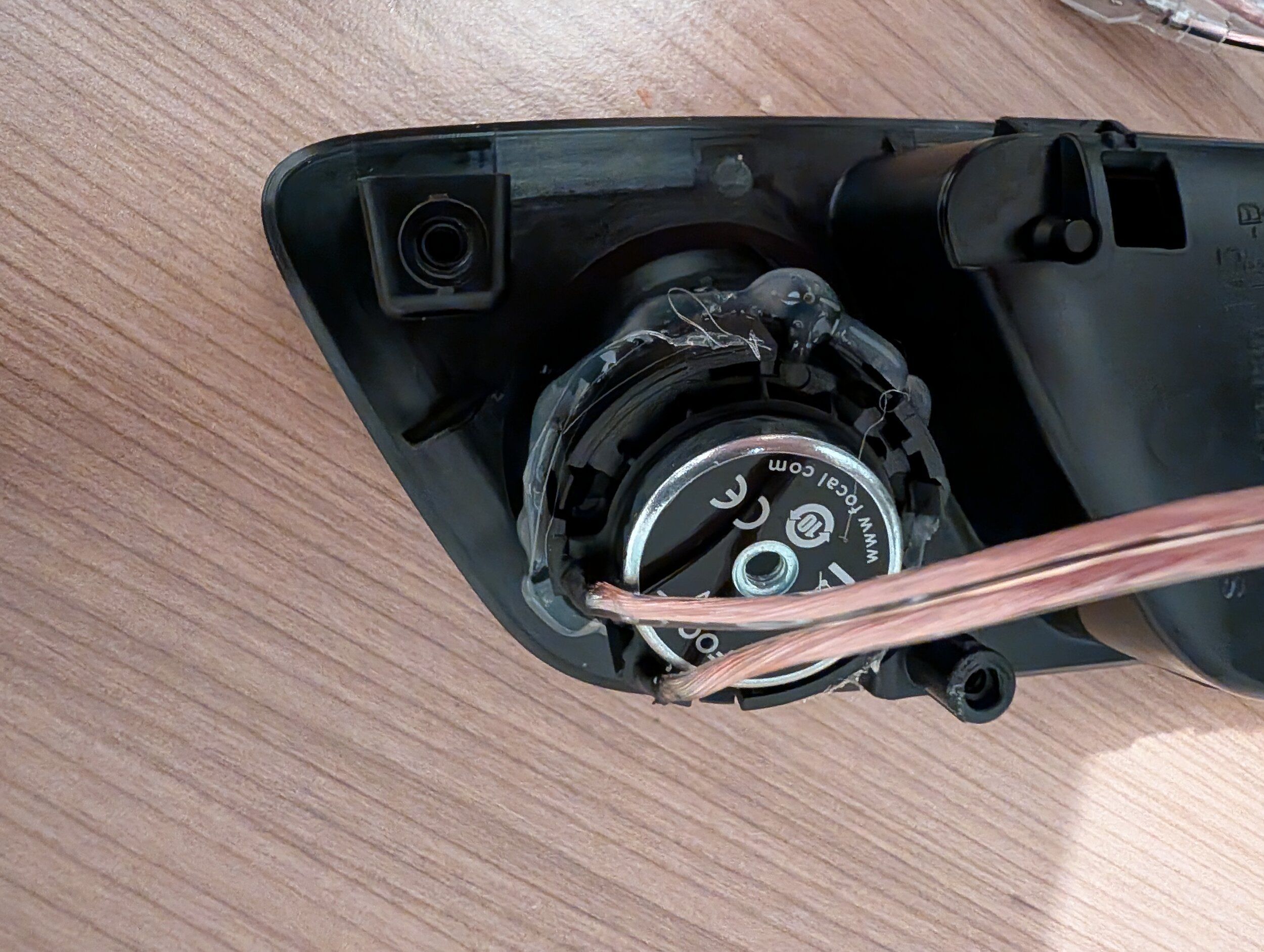

the first try-on...
The tweeter has already been modified.

Are you using hot glue?
My daughters made their grandad a wooden 'ship' from wood scraps using my hot glue gun - they put it in their conservatory, to find it in pieces on the floor after a hot day!
