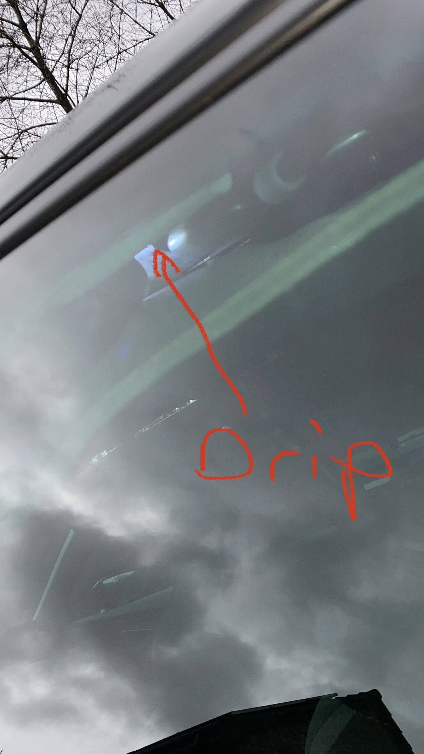

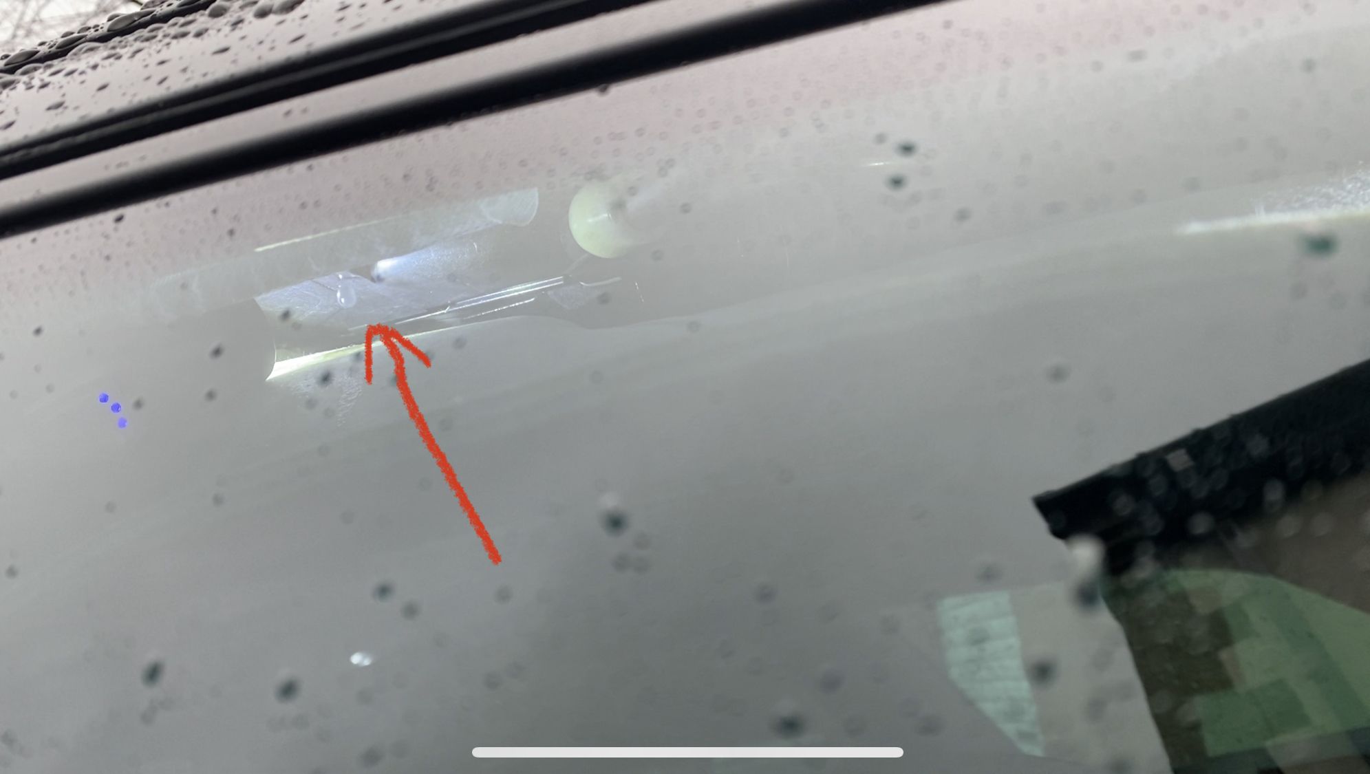

Hi everyone,
Having some issues with a water leak from the rear passenger side corner, leaking into the headliner and down the rear c pillar.
First port of call was obviously the drains, and whilst there was a small bit sludge, there was no water backed up, I’ve removed the sludge with a 2m pipe cleaner (from below, easy access) and the pipes drain well when teste.
For good measure I removed the red caps off the end of the drain plug on the rears.
Fronts I cleaned out from the top with a pipe cleaner, and they seem to drain fine.
However next time it rained, I had the leak again.
Drains are not blocked I’m pretty sure.
I peeled back some headliner and had a look when it was raining.
The water is dripping off a black plastic edge, approx 2 inches away from the drain plug and pipe (Brown pipe and White plug)
I’ve attached a couple of pictures.
These pictures are taken looking into the car from the window between rear passenger door and boot/c-pillar
Any ideas on what could be the problem or how to fix it ???

Yeah mate all fixed.
It was the rubber seal that runs all the way around the sunroof. It wasn’t stuck to the metal properly and was leaking down the back of the seal.
Cost £300 for a sunroof specialist to fix inc the new seal that was £98

Just as an update to this thread, my sunroof started leaking again in the same place as last year.
After investigation i found that the outer sunroof seal was again coming away from the bodywork, allowing water down the back, again
As it was still under warranty with the repair done by the sunroof company they provided me with a new seal, and as they couldnt fit me in until after the new year i decided to fit it myself !!
It wasnt that hard to replace to be honest and i was able to do a better job that the sunroof company who replaced it last year for me as i was able to take my time and do it properly.
I cleaned off all the old residue of the old seal by hand and the offical VAG cleane, primed the area where the new seal will stick, then installed in using a hear dryer to heat the bodywork and seal up whilst i stuck the new seal down.
Complete success.
