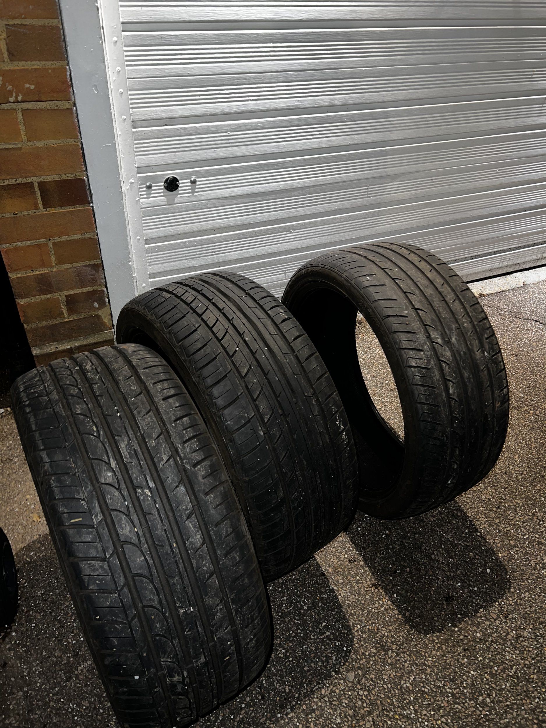

I want to turn off the fake sound also in the inside because I prefer the real engine/exhaust sound but I'm not sure if to go with Ramair induction kit or Racingline because price wise there is a big difference £200 but they are also different but racingline sits at the whole front of the bonnet but ramair is more similar to the stock intake, also if anyone wants 3 tyres I have them since I just upgraded all my tyres to micheline 235/35/zr19

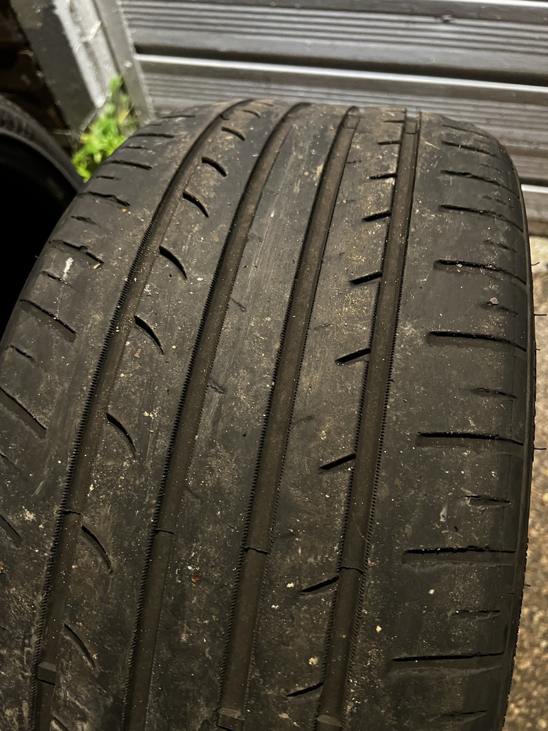

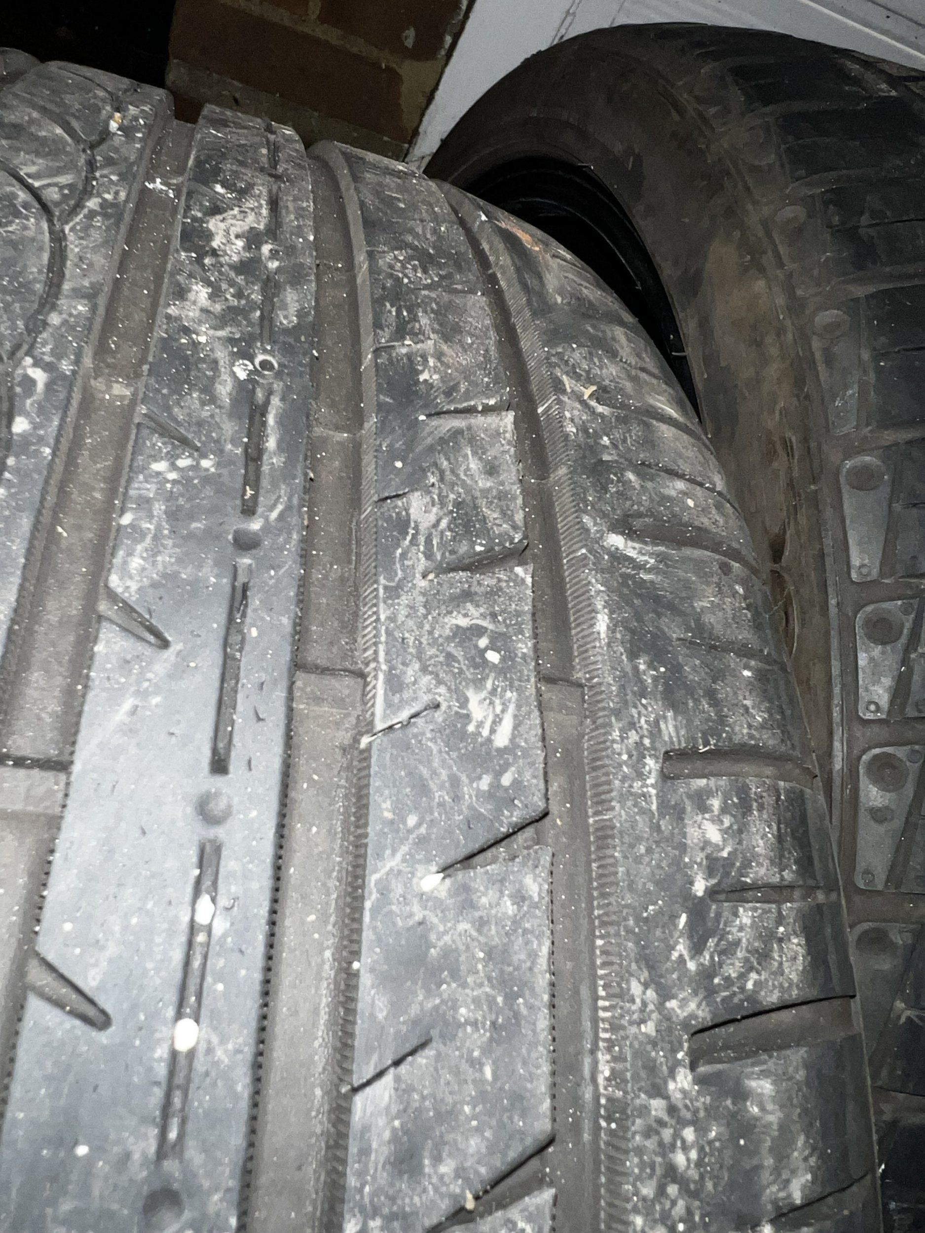

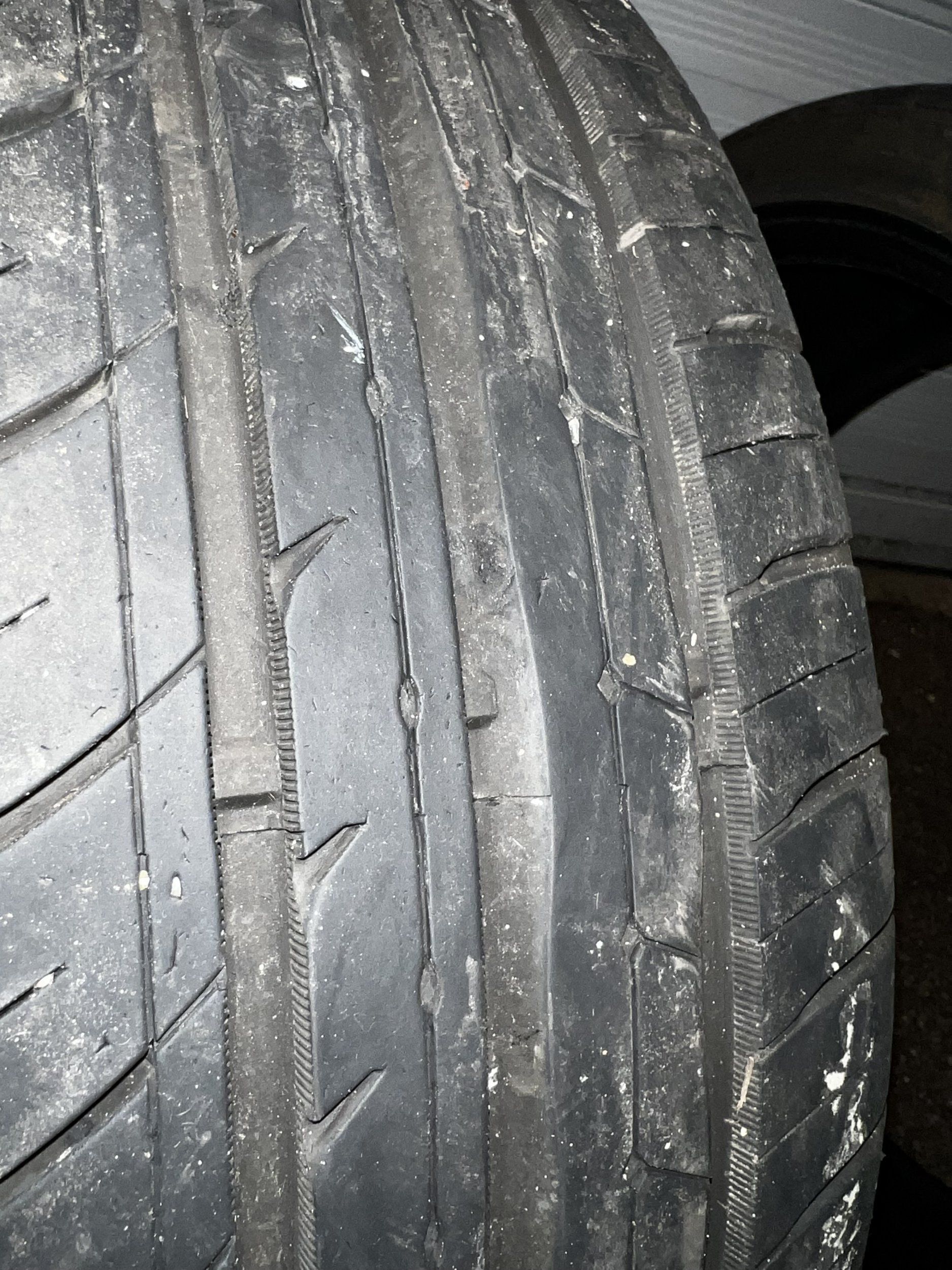

Why not go stock intake box, and Ramair hose and elbow? What tyres, tread?
Yeah I am considering that maybe would be the slightly cheaper option but similar gains, I have three tyres the Road X and Dynamo at the rear so their tread is around 6.5-6 they’re technically new from previous owner, and front right tread is like 5 because it’s still very good too. I have them up for £250 for all three because two are technically new and front right partly worn
