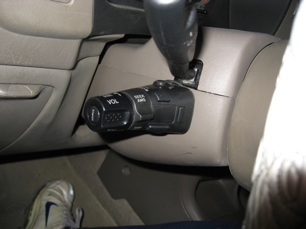

If you had a Sony stereo then you could fit the RM-X4S remote.
Fitted it myself in a few minutes and blimey, it's useful.
Looks sth like this
