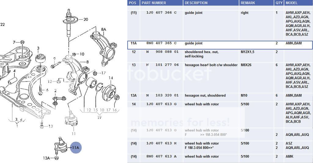

Look good Pete but no good for the LCR as we have the studs coming from the ball joint down where these are for ones where the ball joints bolt onto these.
Theres adjustable top mount braces that give you -ve camber that i have my eye on from INA/034 motorsport
There are other ball joints listed on shhh you know what.
Ho ho I wish, Nah i saw them a while ago and have been waiting for excuse to show someone (sad I know) they are listed for front wheel drive TT and quattro and our front end is basicaly the same! Doubt you'd have to cut anything just plug n play by looks!
