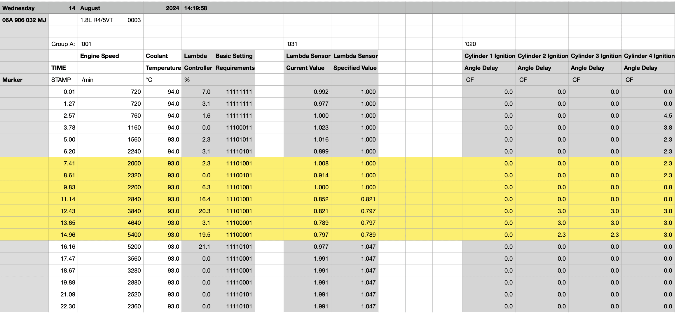

Im open to logging whatever needs. Ive attached a 4th gear pull (before i ran out of road) to get the ball rolling

All looks ok from those logs, i take it it's a stage 1 AUQ?
Could log the O2/lambda values for the fueling, think it's group 031 or 032
3rd gear is OK for logs too, 4th is a bit impractical seeing as your well into triple digits on whatever private road you use :)
What fuel are you using?
Would be good to log the knock/ignition delay too, can't remember what group that is off the top of my head, but the values are titled KW and the measurement units are in the format of 0.0degrees etc. Cylinders 1,2,3 are in one group and cylinder 4 in another

I checked the fuel trims on 032 last night, that was at -0.2% / 9.4%
using 99octane, tesco momentum or v power
i'll find out what blocks are knock/ignition delay and get back to you with some logs

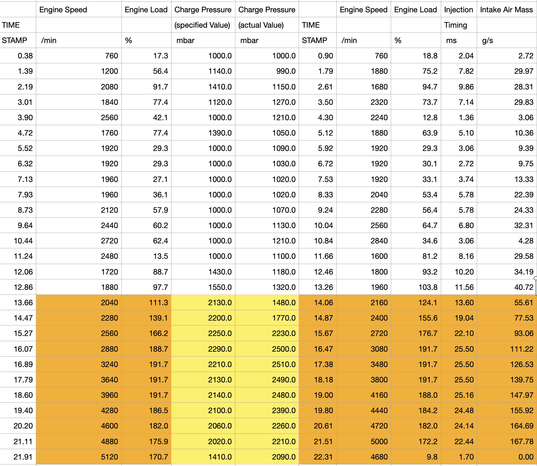

To return to this after a lot of crap got in the way.
I managed to log fuel and timing with no visible issues. its not leaning out and its not pulling timing
I still cant figure out what could cause a low maf reading without it being the maf itself. Im wondering if its the ECU asking for less of its mechanically choking somewhere.
Does anyone think it could be my turbo? I make 24psi when cool but the power delivery is so flat, doesnt throw you back in the seat, and is slow to build back up after shifting.
The other thing to mention even on a 23c day of town driving the car gets stuck at 5psi and stays that way until a long drive cools it down. Im thinking its heat related but everything in the ecu is reading correctly, so maybe the turbo/wastegate/actuator getting hot for some reason?
might explain the low air flow the maf is seeing...
Sorry if you've already tried this, but a sticking N75 valve will cap the turbo at 5psi.
I will try borrow my mates n75 and see if it changes anything. Mines only a few years old from the stealers so i hope its not that lol. I think at this point ive swapped/replaced most sensor parts except the throttle body and n75.
