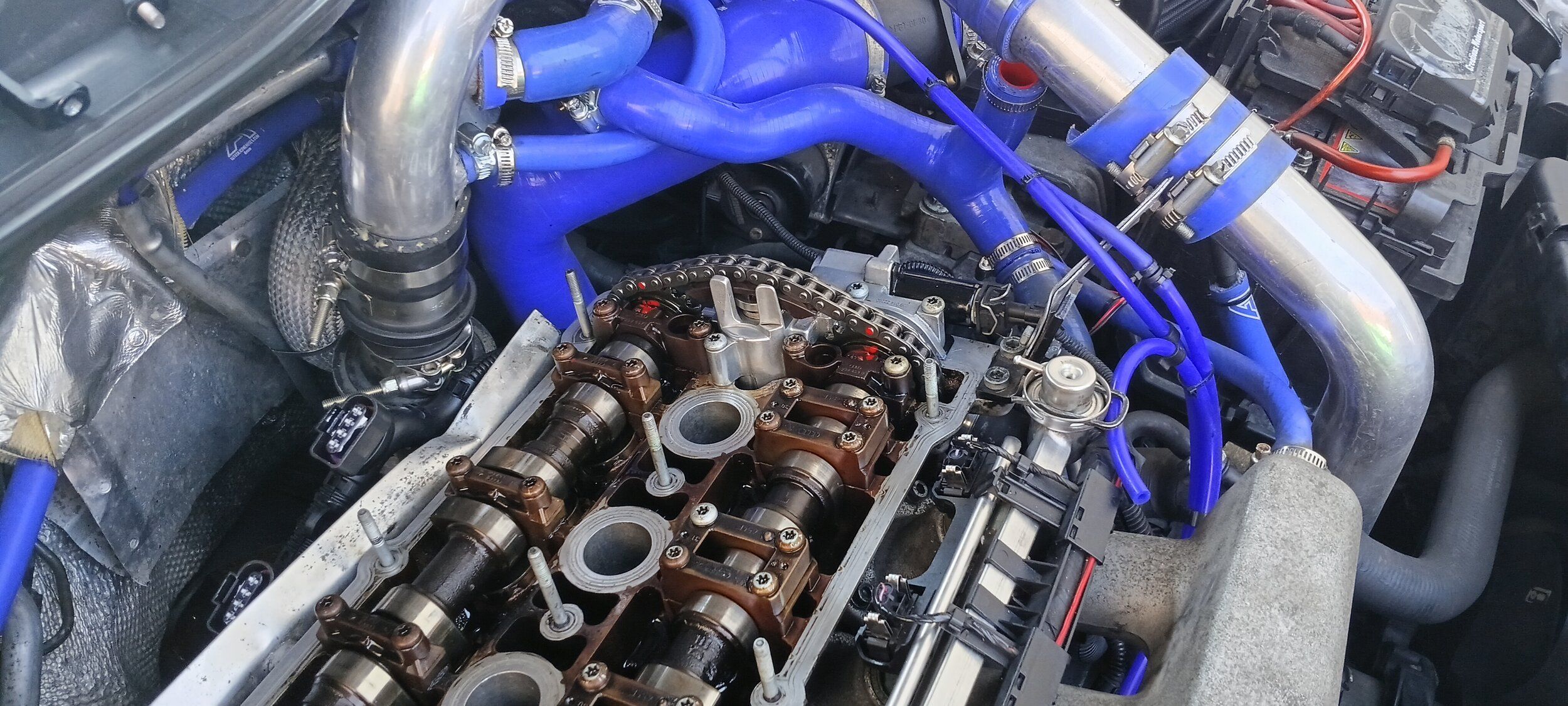

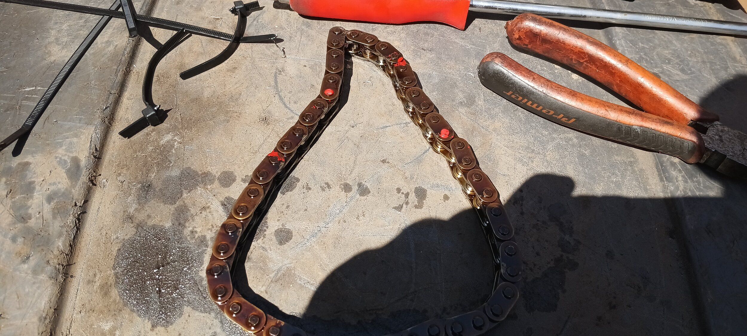

well the chain and tensioner is done, runs spot on, really feels so much smoother and its throwing me back in my seat again, i dont know for deffo if its brough the maf numbers up yet as my laptop is out of charge so ill get on that later and post the results. also managed to do the chain and tensioner without removing timing belt, just cable tied it to the pully tightly, loosened all exhaust cam caps off and the cam popped up enough to get the chain out, then just being carefull to tighten bit by bit to get the cam back down again, all in took 45 mins.

im deffo a bit lost with this, checked everything and all seems good and since doing the chain it seems to have given it a burst of life now its not -6 degrees retarded constantly.
yeah seems like it, all i know now is that its deffo got its kick back and feels much quicker than it did with basically the same maf numbers, so i think i'll leave it right now and maybe get a couple dyno runs at some point see where its at.
How to Check Phase Position via VCDS
  1. Start the engine and let it idle until it reaches a full operating temperature of 80°C–90°C.
  2. Connect your diagnostic interface and open the VCDS software.
  3. Click on Select Control Module -> Go to 01 - Engine.
  4. Click on Meas. Blocks - 08 on the right side.
  5. Type 093 into the Group box and click Go!.
  6. Look at Field 3 (labeled as Phase Position or Camshaft Adaptation). [1, 2, 3, 4, 5]
Reading the Results for the AUQ Engine
  • Ideal Spec: A perfect reading is 0°KW. The official acceptable factory specification tolerance is between -3°KW and +3°KW. [1, 2]
  • Stretched/Worn Chain Warning: If your value drifts significantly into the negative range (e.g., -6°KW to -9°KW or lower), it means the intake camshaft timing is retarded. This is usually caused by a stretched cam chain or severely worn plastic shoes on the cam chain tensioner. [1, 2]
