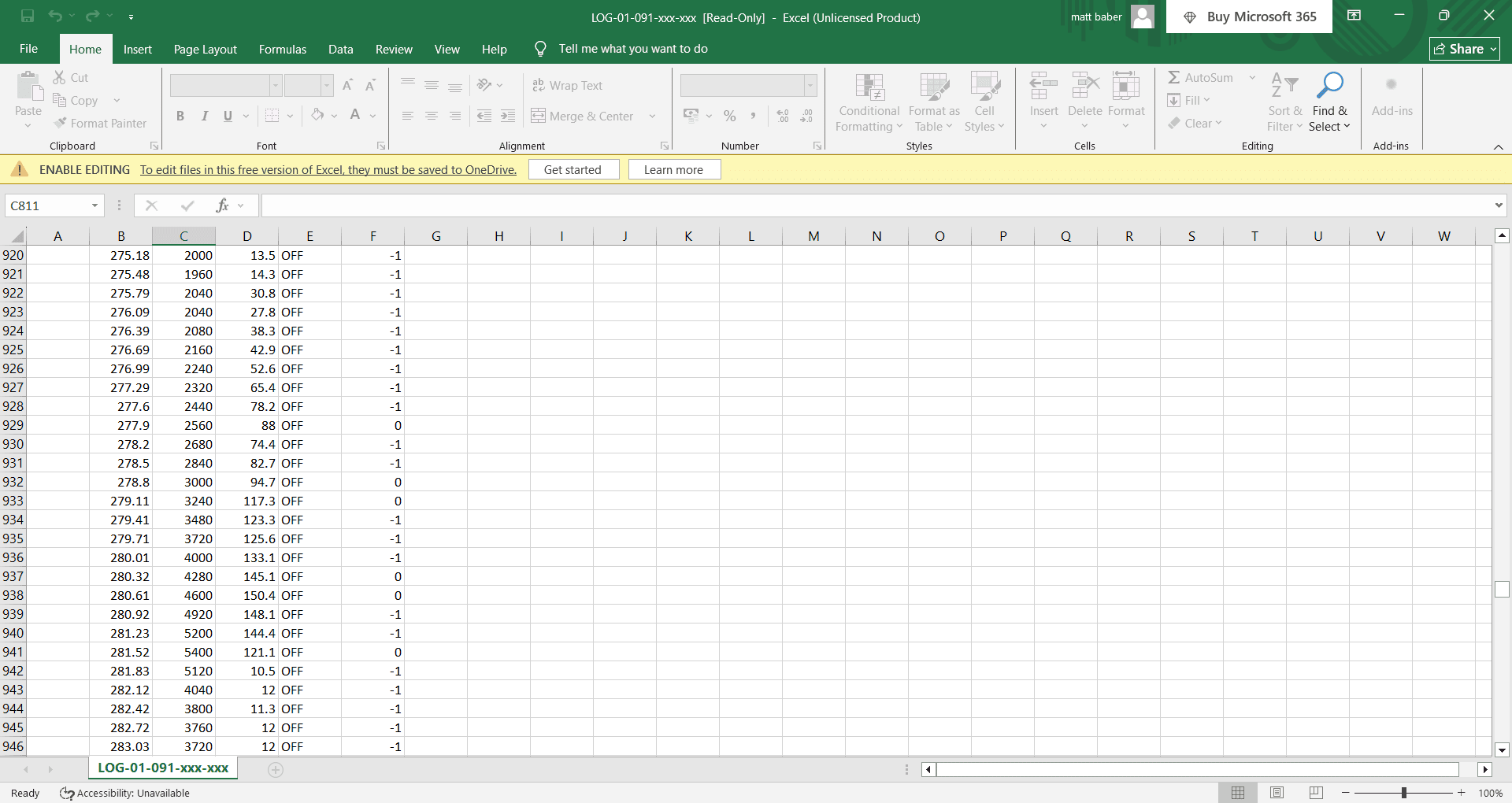

Just ran the logs for you now buddy, took her from 1.5k to 5k rpm on multiple pulls, the VVT stays firmly off at all times. Load was over 100% on multiple occasions and nothing. Seems it only functions at cold start and that's it.
Happy to run any other logs you need.
Damn, when you're right you're right! Thank you so much for proving me wrong. That was the last thing i could find, i am at a total loss now. Guess i better start saving up for another leon. Not many around anymore either :(
Tbh i was realy hoping i was wrong for your sake, but at least we know for sure now.
