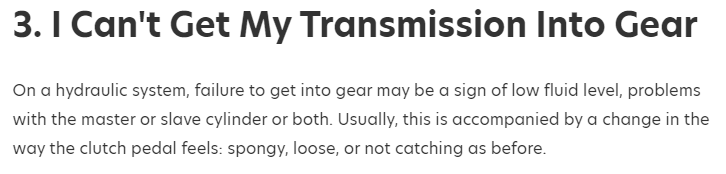

I had a courtesy car while it was in which was a brand new Leon with 500 miles on it, after driving it and getting back in my car I suddenly noticed how much less "springy" my clutch is than the new one. It's not like when they fail and don't come up but there is very little force pushing it up it feels like. The new one was very springy, probably too much for my preference but mine is definitely quite weak which makes me wonder if there is some underlying problem there, possibly with the clutch cylinders?
Edit: Random google result (https://axleaddict.com/auto-repair/Bad-Clutch-Symptoms) suggests these could be linked:

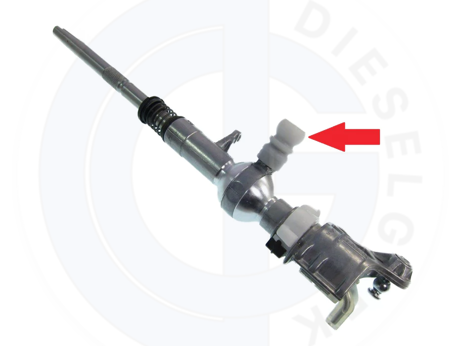

I think i found the solution, meaning that i am 99% sure that this is the problem.
These guys are incredible, i think they are gearbox doctors, ive been wathching their videos for years now.
One of the many videos on the subject:
