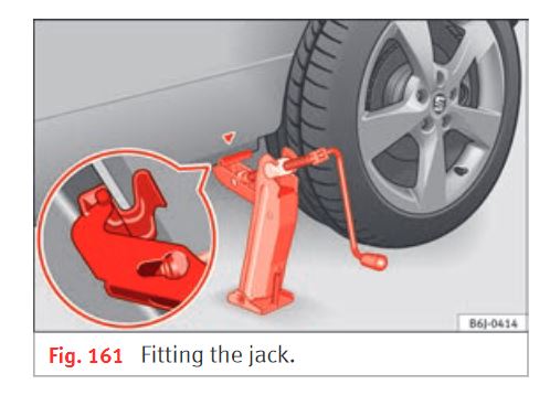

Also is the jack for the Seat Ibiza 1.2 FR (2016) a scissor jack or something else ?

So the jack looks unusual is it a specialist fit or something - hard to see from photo
Ah from online manual it is a bit different
