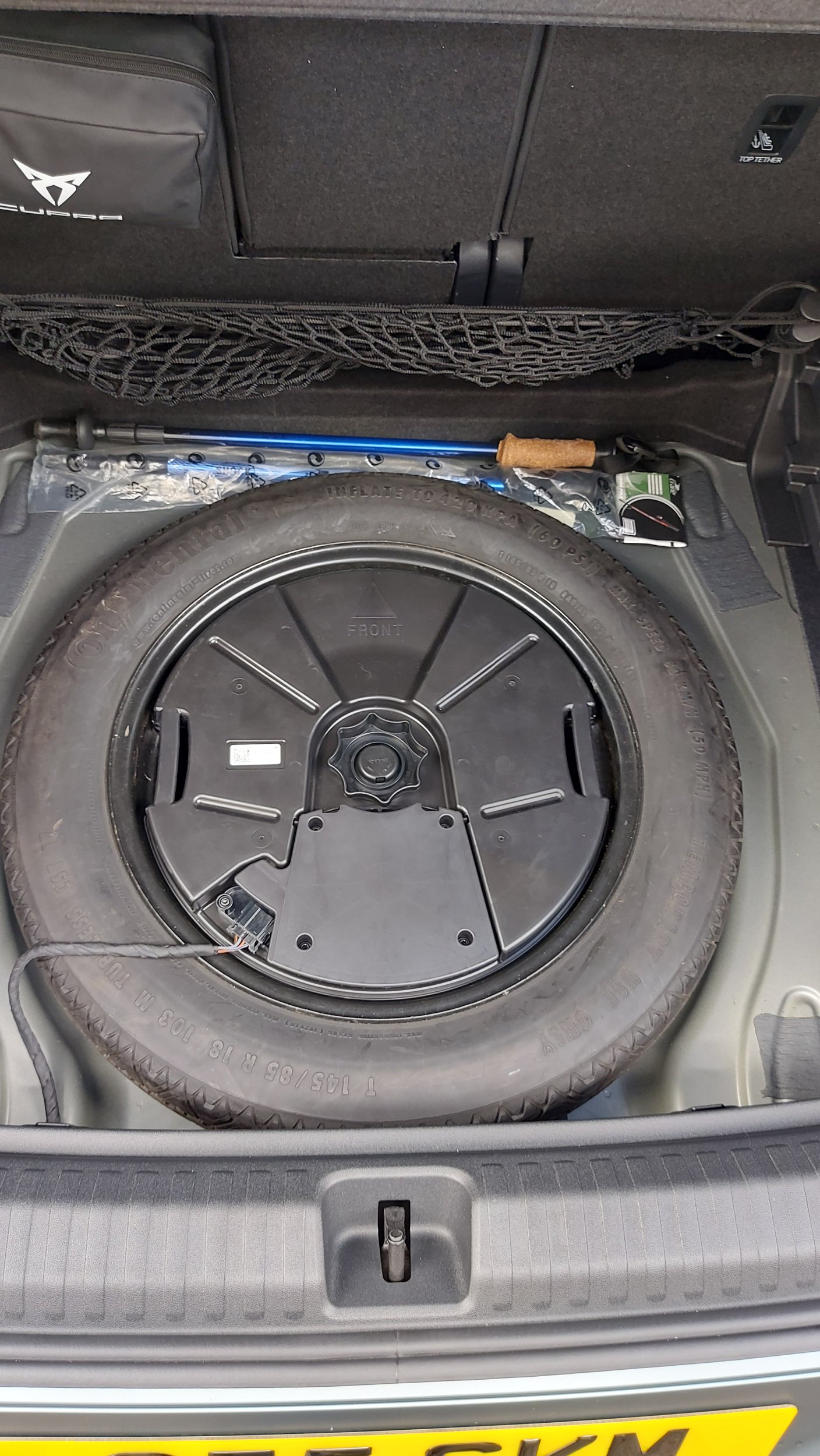

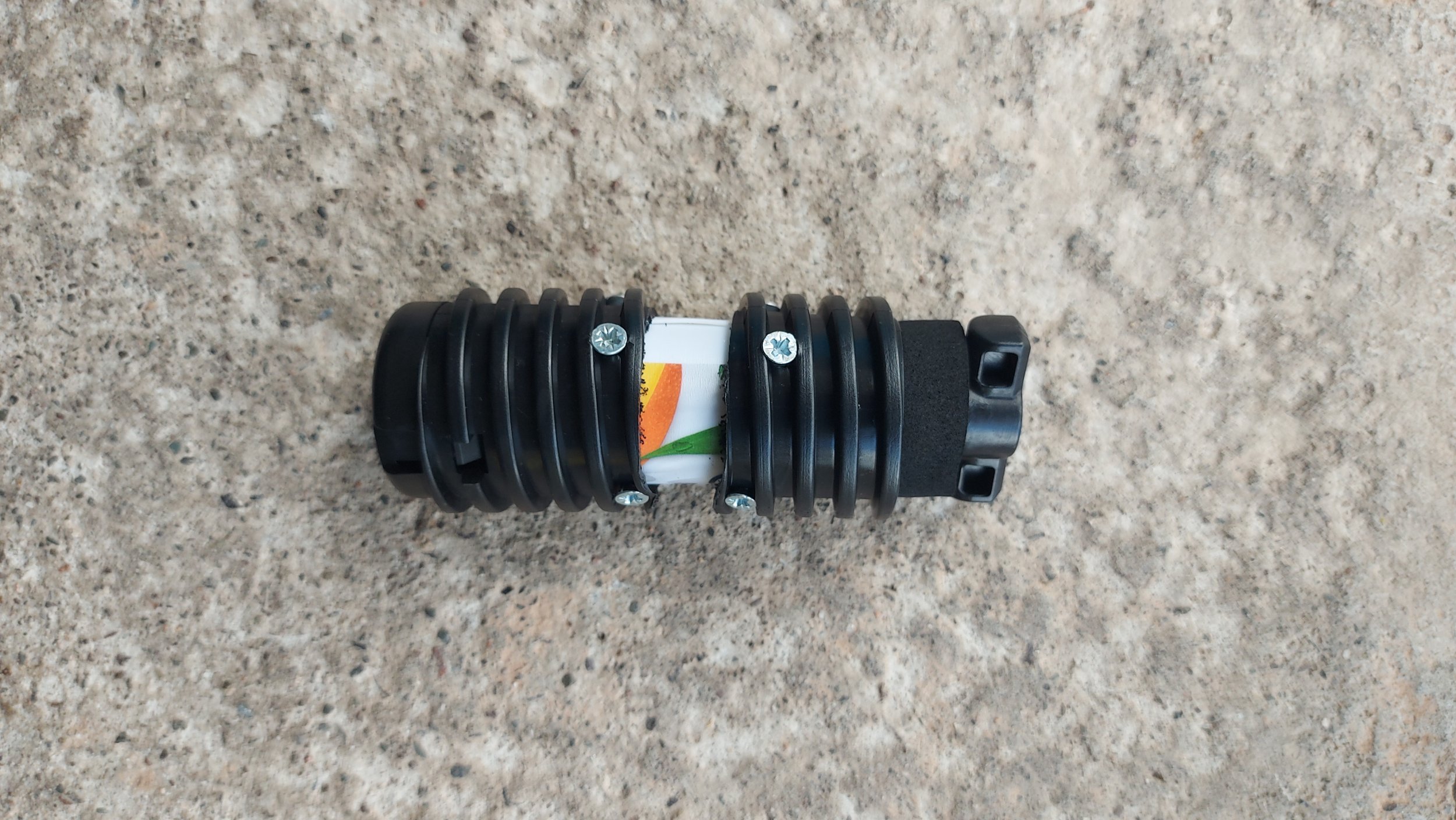

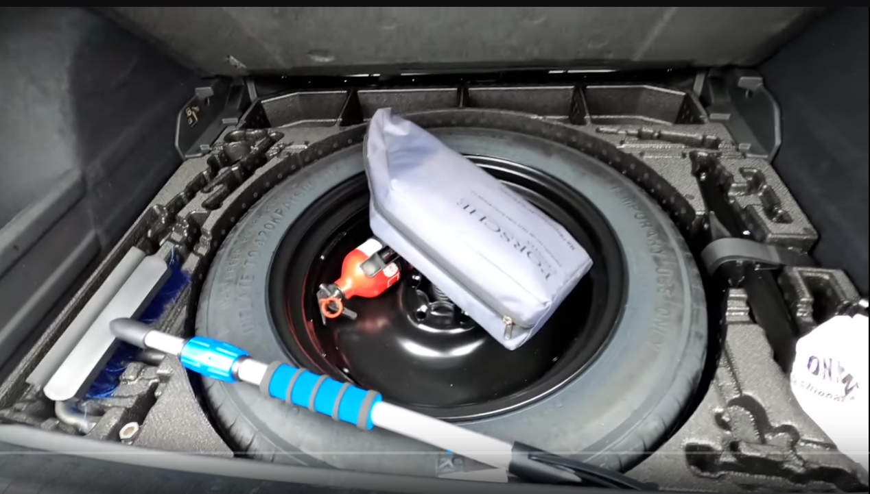

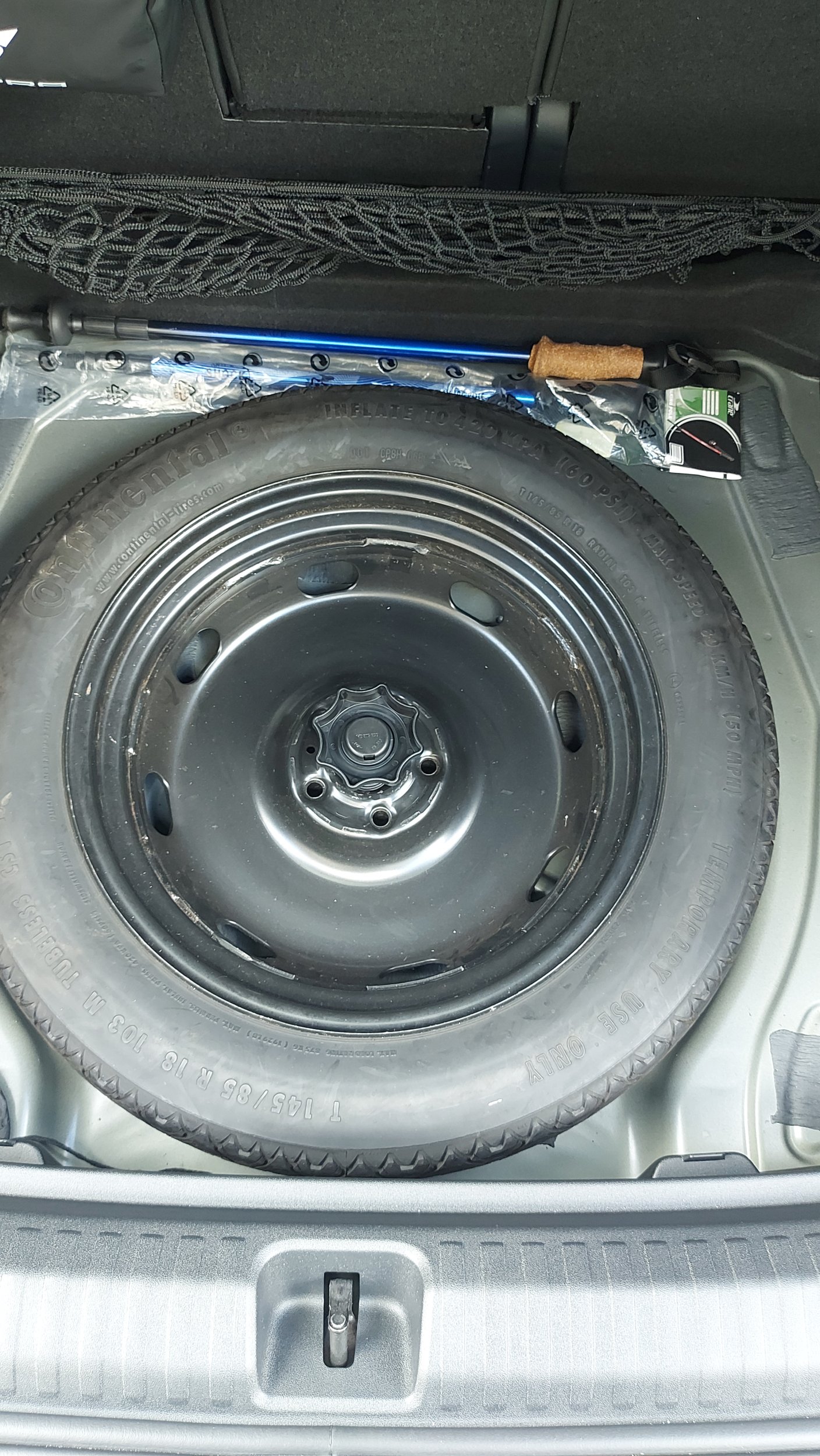

Yes it is possible to do , I purchased another plastic bolt that fastens the subwoofer in position as I found that the one that is holding down the subwoofer at the moment does not have enough thread on it. I had to extend the plastic threaded bolt by cutting it in half and inserting a plastic pipe inside it and screwing it together to extend the thread by around 20mm. I do not have any of the tools and jack in the bootspace. If i am going a distance I have a small trolley jack and extending wheel brace which i place in the footwell behind my seat as there is usually just two of us nowadays travelling.

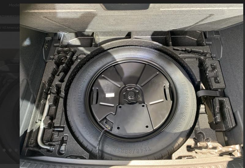

I have been recently looking into this, how did you approach getting the foam surround sorted? Part# appears to be 83A012109N, which is shared with the Q3.. price is steep at ~£130 for just the foam, when the entire kit option from manufacturer is £200..
I came across this thread particularly because of the mention of modifying the bolt, how are the VZ2 with the Sennheiser audio system setup in the boot then? Noticed you have the America's Cup edition, but the layout would be the same in this case. This 'official' bolt states "without cupra sound only".

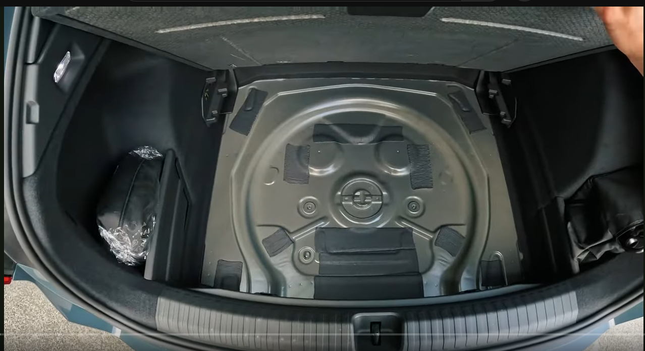

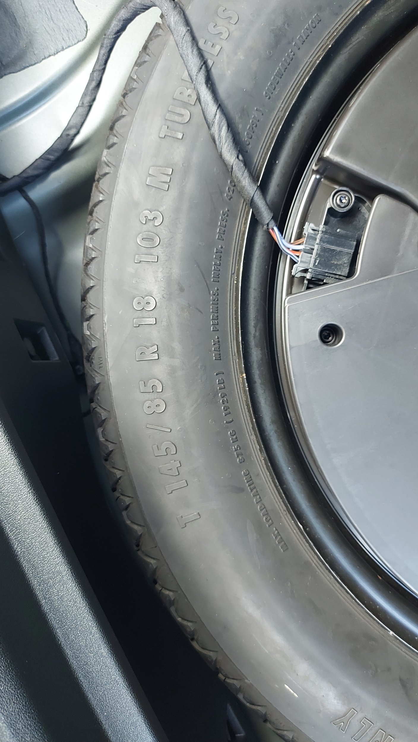

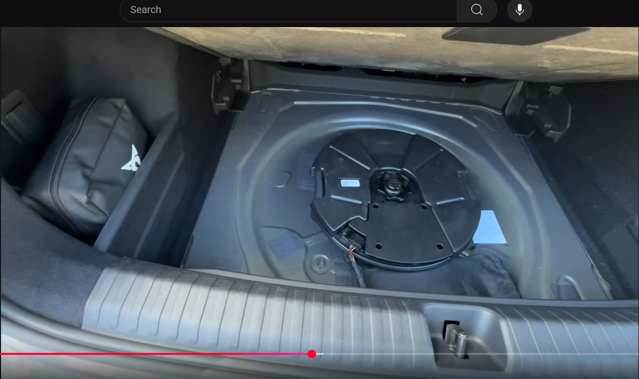

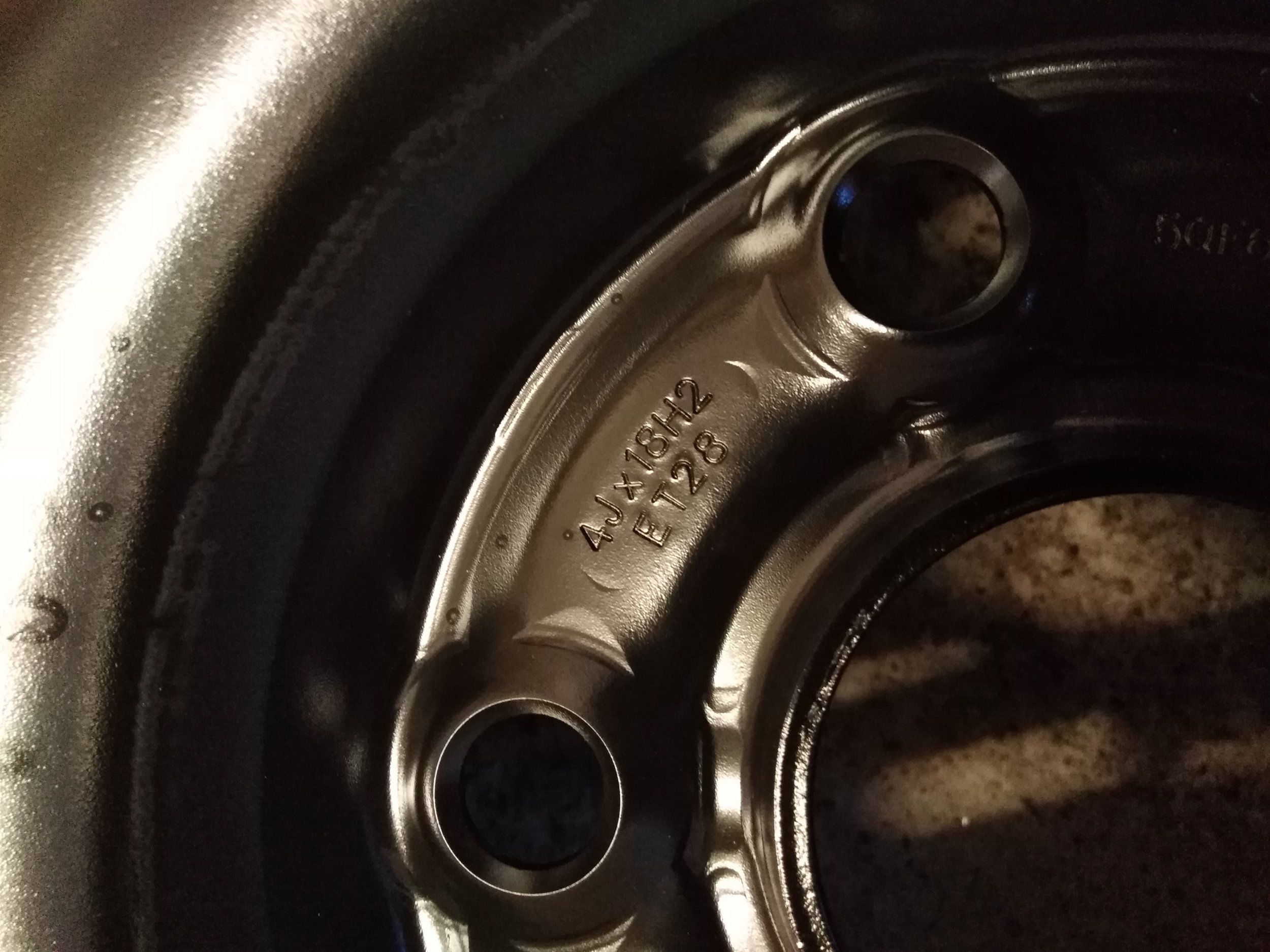

Not sure if anything else would be required, though I'm unsure how the face of the wheel fits below the sub enclosure/plastic middle trim, do you have any photos that you could share, what tyre size did you get? 145/85 R18? @GavinM

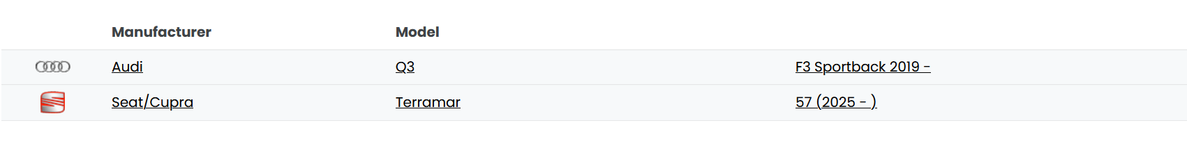

Edit: Found another site sharing compatability, on looks alone the foam appears to be the same:
1 - Empty = No Sennheiser audio
2 - No space saver, with black plastic in the middle = Enclosure for Sennheiser amp/system
3 - Space saver (unknown if Sennheiser is below)
4 - Space saver with clear wiring that matches sound sytem enclosure
I don't have the foam insert, just plenty of other, just incase stuff. Hope they show you what you need to see. Maybe not very professional looking the threaded bolt, but I made it to see if it done the job and seems to be okay, maybe some black tape would tidy it up a bit, just never got back round to it. It's never seen in there.

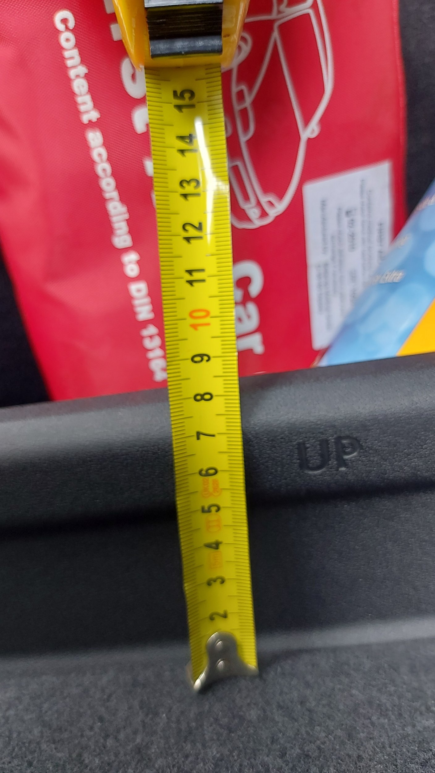

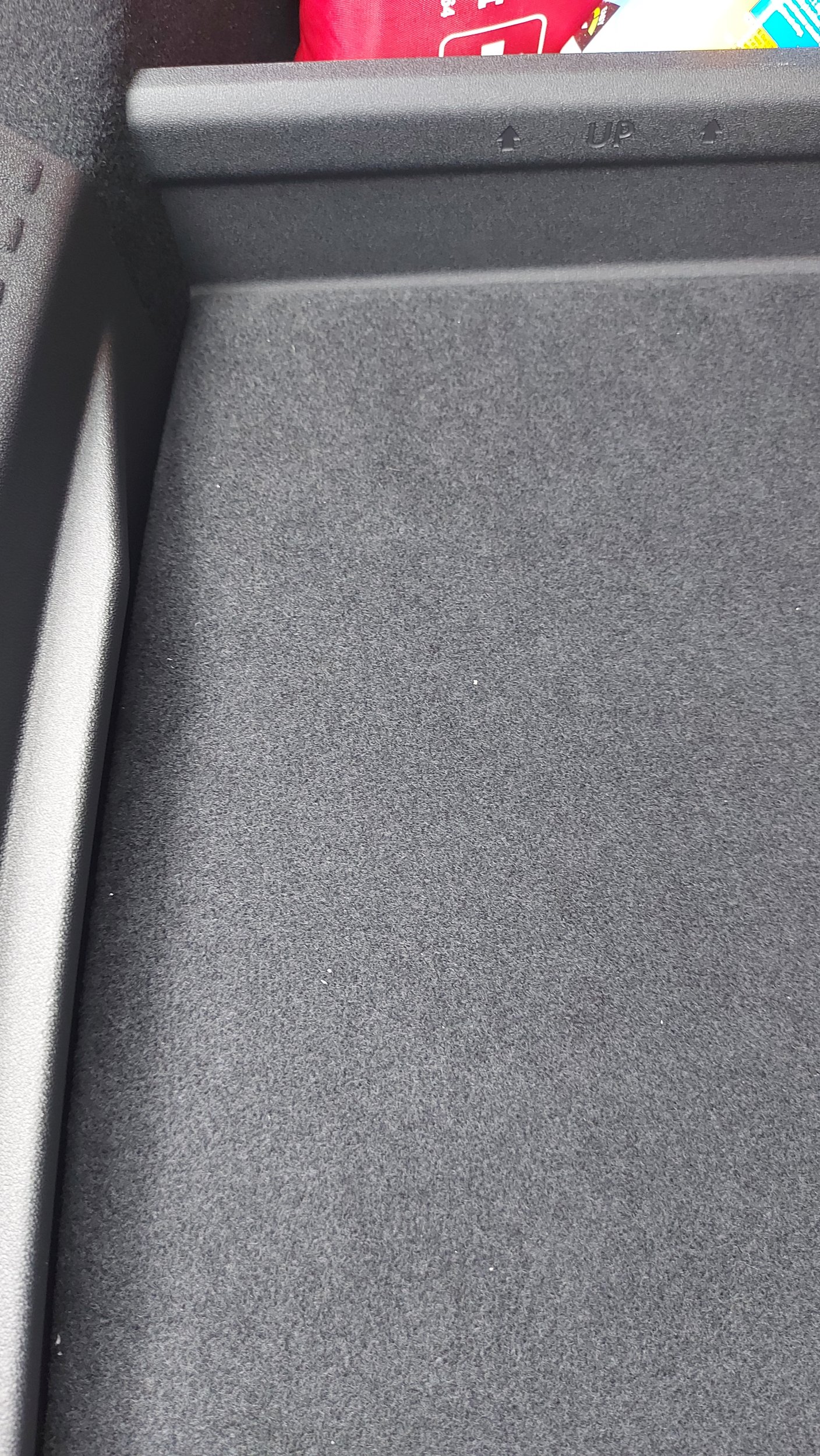

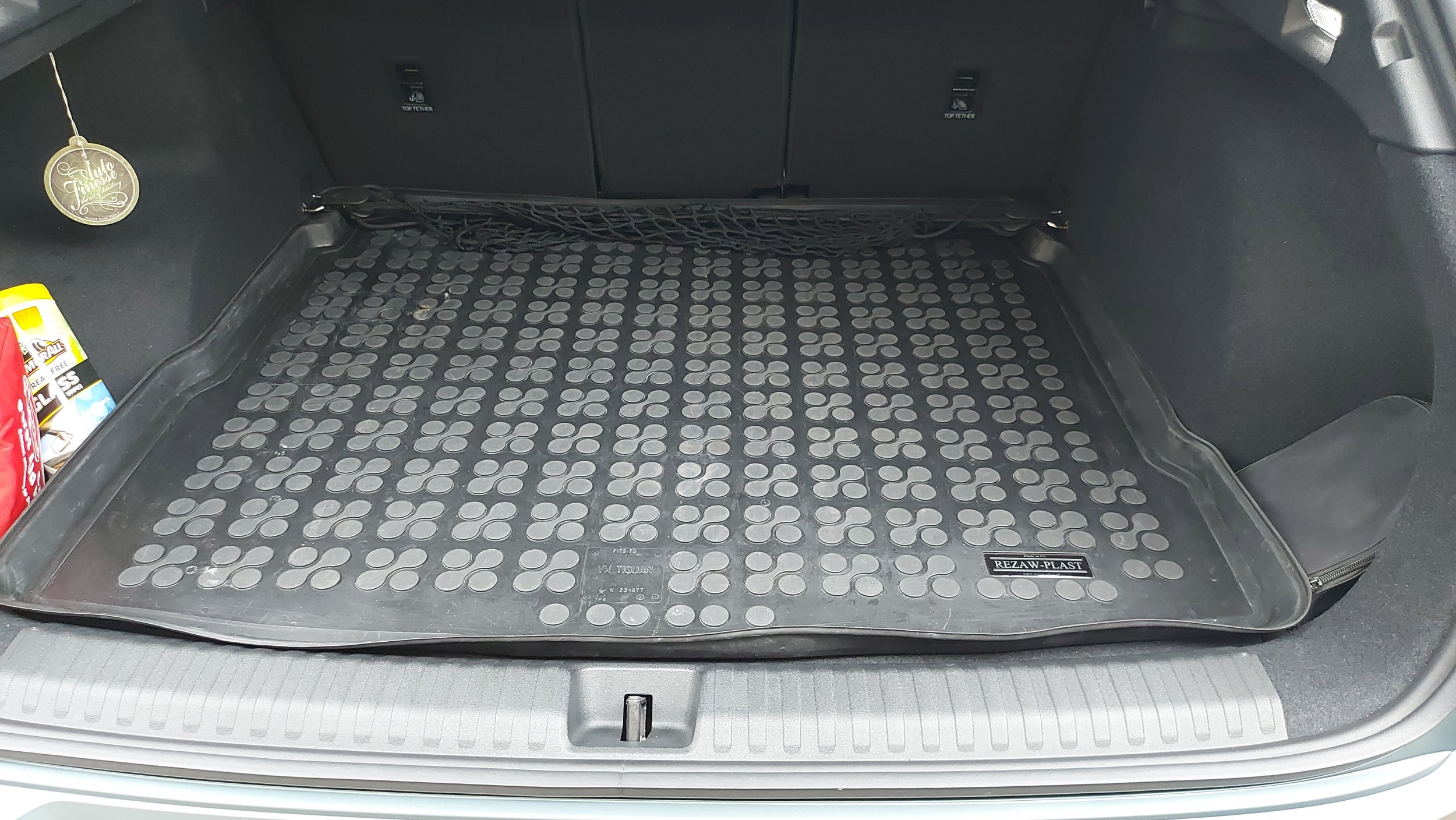

Can I ask please, with the space saver in place, is it no longer possible to move the boot floor to the lowest level? What does that do for boot capacity? It's difficult to tell from the photos how deep the wheel well is (my car is on order)
I can move the floor down 1 level with the spare wheel in place, not sure if there is another level or not but it won't go any further. The last picture is of my boot liner which is from my previous Tiguan which is a fairly good fit.
That's really helpful, thank you!

Looking to do something similar, what part number did you use for the tyre and assume it’s just the 18in even with 20in alloys ?

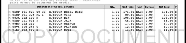

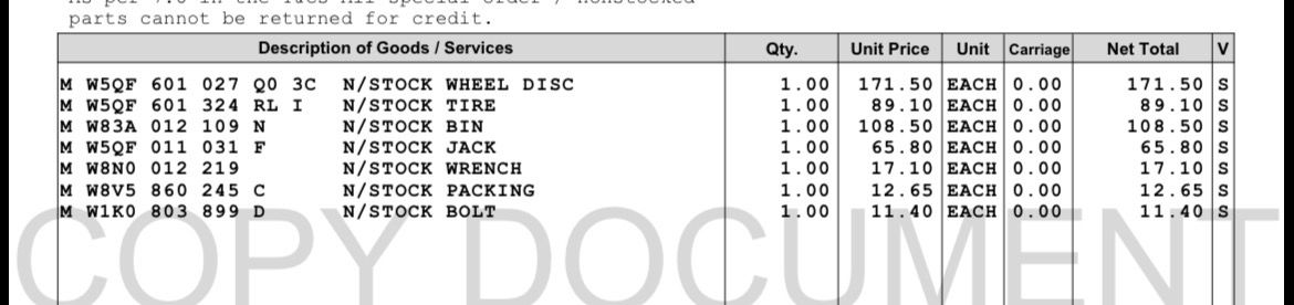

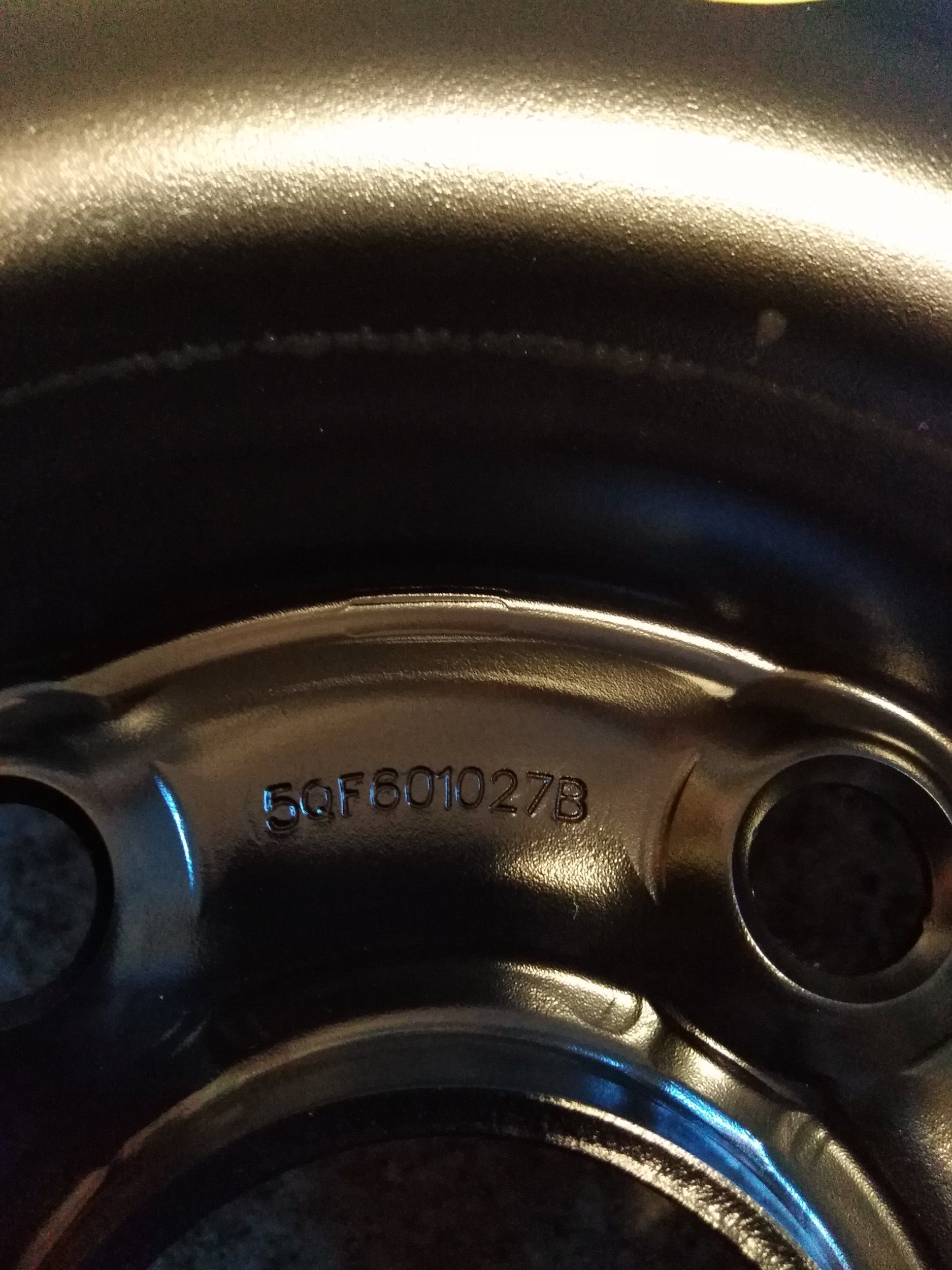

Been some time, but wanted to share what I found out. The Q3 foam insert (top part) is a shared part, so readily available should you want it.
In terms of parts list, use the below which I was kindly provided by a useful main dealer.
Ignore the pricing as this was months ago.
M
W5QF 601 027 Q0 3C
N/STOCK WHEEL DISC
1.00
171.50
EACH0.00171.50
M
W5QF 601 324
RL I
N/ STOCK TIRE
1.00
89.10
EACH0.0089.10
S
M
W83A 012 109 N
N/ STOCK BIN
1.00
108.50
EACH0.00108.50
M
W5QF 011 031 F
N/ STOCK
JACK
1.00
65.80
EACH0.0065.80
M
W8NO 012 219
N/ STOCK WRENCH
1.00 17.10EACH0.0017.10
M
W8V5 860 245
C
N/STOCK PACKING
1.00
12.65
EACH0.0012.65
M
W1KO 803 899
D
N/ STOCK BOLT
1.00
11.40
EACH0.0011.40
