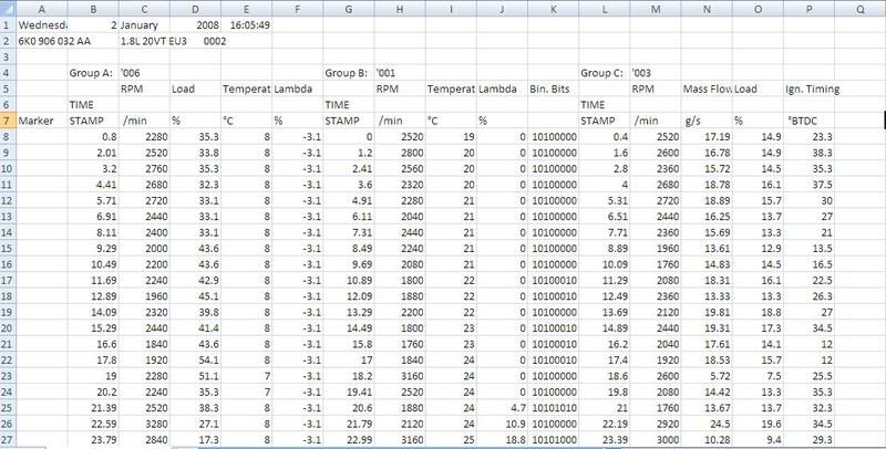

1st off you have some misfire, you may want to monitor which cylinder its misfiring, 1,2,3 or 4.
You have the shareversion, you would need to get the full version. Try measuring the mass meter and lambda and boost . After you sorted the misfire
003 + 020
115 + 031
118 + 032
