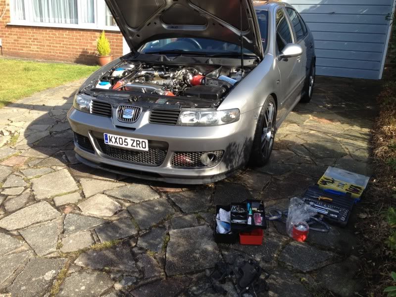

Right quite a bit done today been a great weekend LCR wise... And yesterday I spent most of the day fitting a 3" TIP to my mates standard LCR, removing the standard TIP was a right PITA! Anyway got there in the end and he's a happy chappy.
So today was the turn for my LCR and it was pretty much allday spent on it!

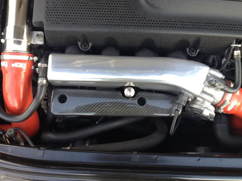

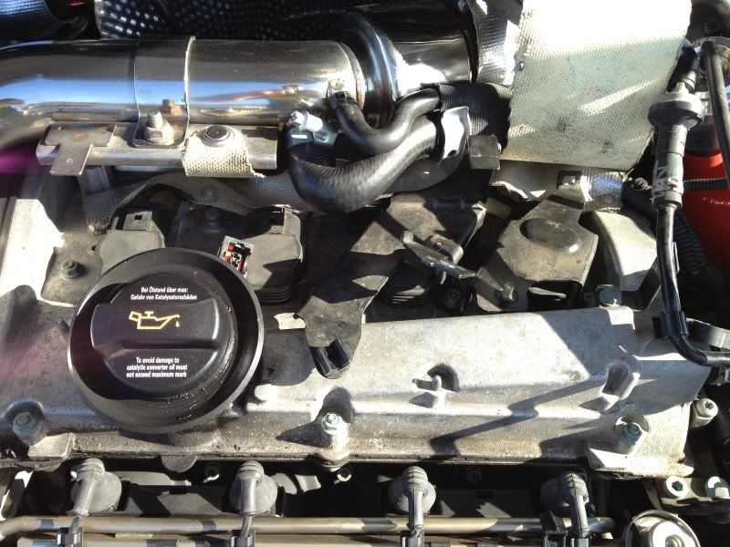

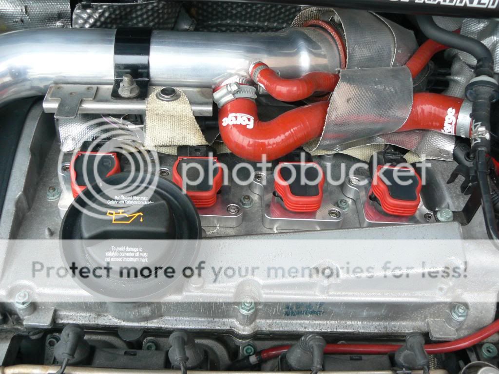

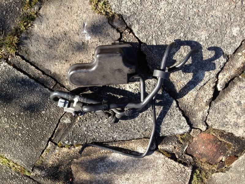

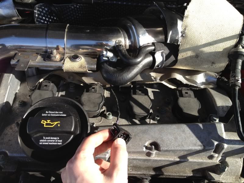

Started with the N249... It has always been bypassed but I wanted the whole thing removed. See the pics..
N249 removed but metal plates above coilpacks still in place, these got removed also.
I need to get a resistor for this N249 connection as the N249 fault code has come up but the car runs the same it's just because it's disconnected.
Work in progress..

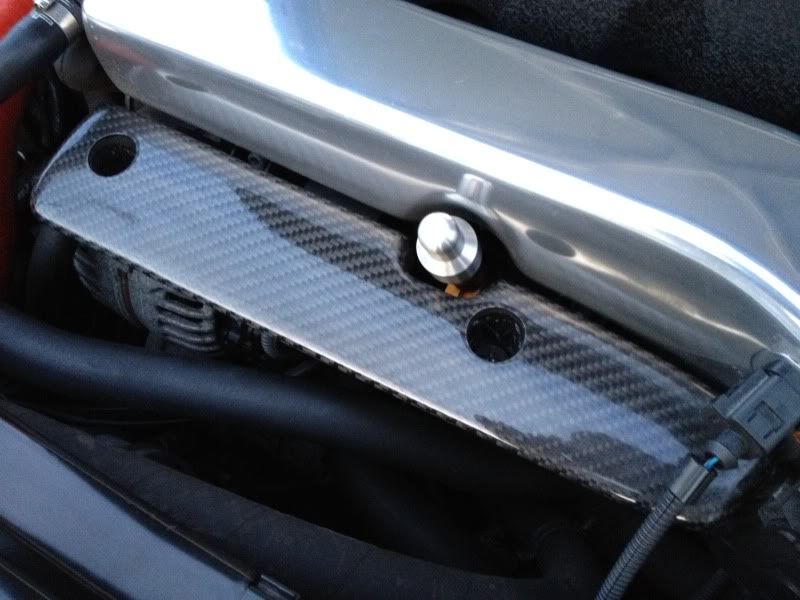

Darren popped round with more carbon that he's been working on for me :D Really pleased with the results.
Just leave the N249 plugged in and hide it somewhere, thats what I did.
edit - under the charge pipe, to the left of the red forge pipe. You can just make it out:

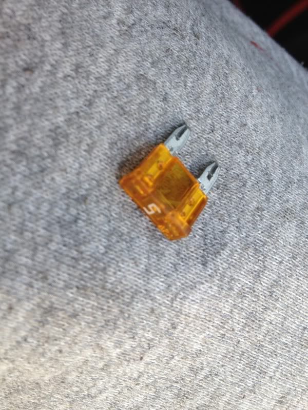

My sidelight stopped working and also my rear tailight, same side (passenger) so I swapped the tailights and still the same side didn't work. So I thought fuse? Sure enough it was...
Fuse 23 was dead and I managed to get down to Halfords just as they were closing and they gave me one for free! Sweeeet. Lights all back on! :) Was worrying that my new LED sidelights were giving up already..
Nice one mate I have tucked it somewhere can't remember exactly where but it's not flapping about now lol.
Do you get the fault code at all?
No mate because the valves still plugged in :)
Sorry mate should have concentrated when I read your post! So did you remove the actual N249 from all the pipework? Might do this Wednesday as it would save buying a resistor :)
