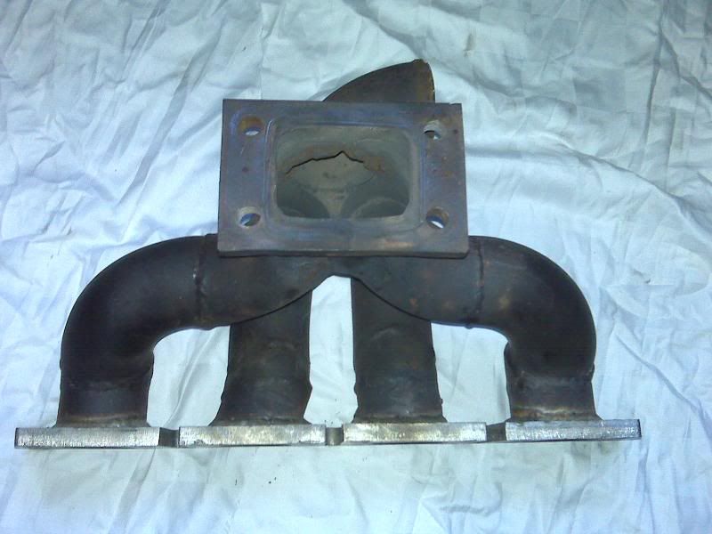

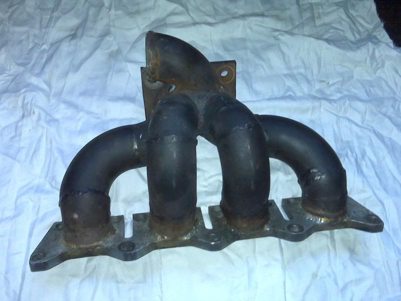

This is the manifold, the flange for wastegate has been removed so shall be getting one welded on once decided on wastegate - shall be paying for manifold tommorow

Sounds awsome, you should have had the turbo to go with the manifold :D.
Changing the flange on that manifold would be very simple as its nice and easy to see all the way round it (for welding), a custom flange shouldent cost much either, if it was say 20mm thick you could use that as a transition from the current collector size to the T25 size you require, assuming the turbo sitting say 10mm higher than what it would have is not a problem?
