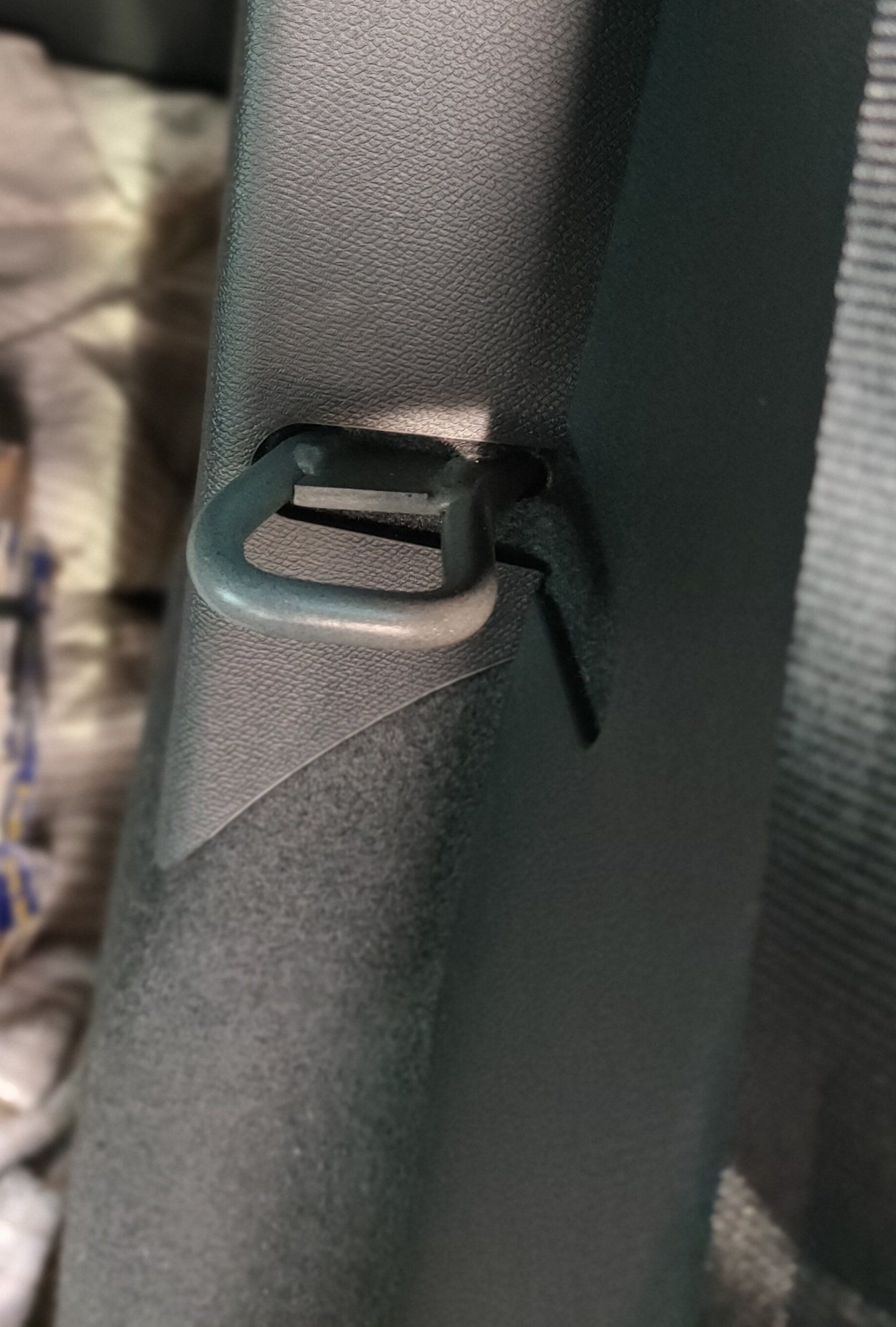

Just an update guys. I tried the insulating tape trick this morning and It actually worked. No more irritating tapping noise while driving.
Thanks again for all the replies and advice 👍

Mate can you photograph what you did and where you did it… cuz i think i have the same irretating thing in my car 😂😒
Just fold down the rear seats and where the seats lock back into place just wrap some insulating tape around the metal catch where the seat latch locks back into place.
This Is the side where I haven't put any insulating tape. But It shows the metal catch where you need to wrap some insulating tape around.
Thank you very much! ;)

Seat adjust the catch that the rear seat locks into so just book it in with them to sort it out.
Mine has been great since they did this and it’s under warranty.
for anyone else that have this issue or can hear a knocking / rattling sound from the rear, just drop the seats and if it goes away, then this shows what the problem is and Seat are fully aware of the issue.

Hi M8! Thanks for idea. The rattling noise been gone. I did it with ice hockey stick tape around that metal. What dealer could do and find. I, thanks to you, now solution works perfectly.
