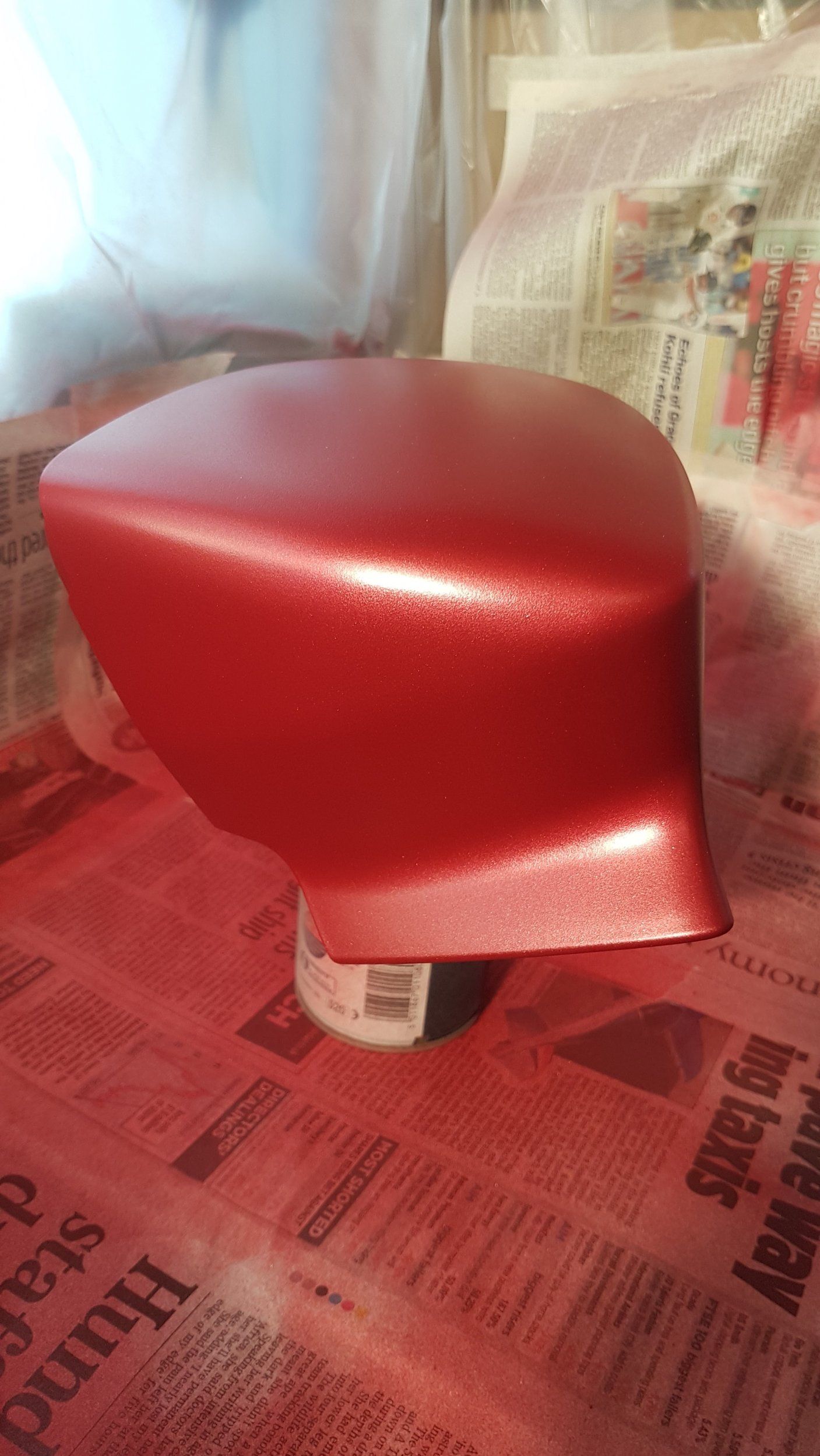

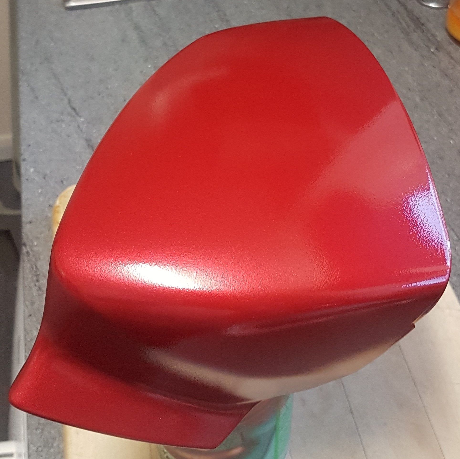

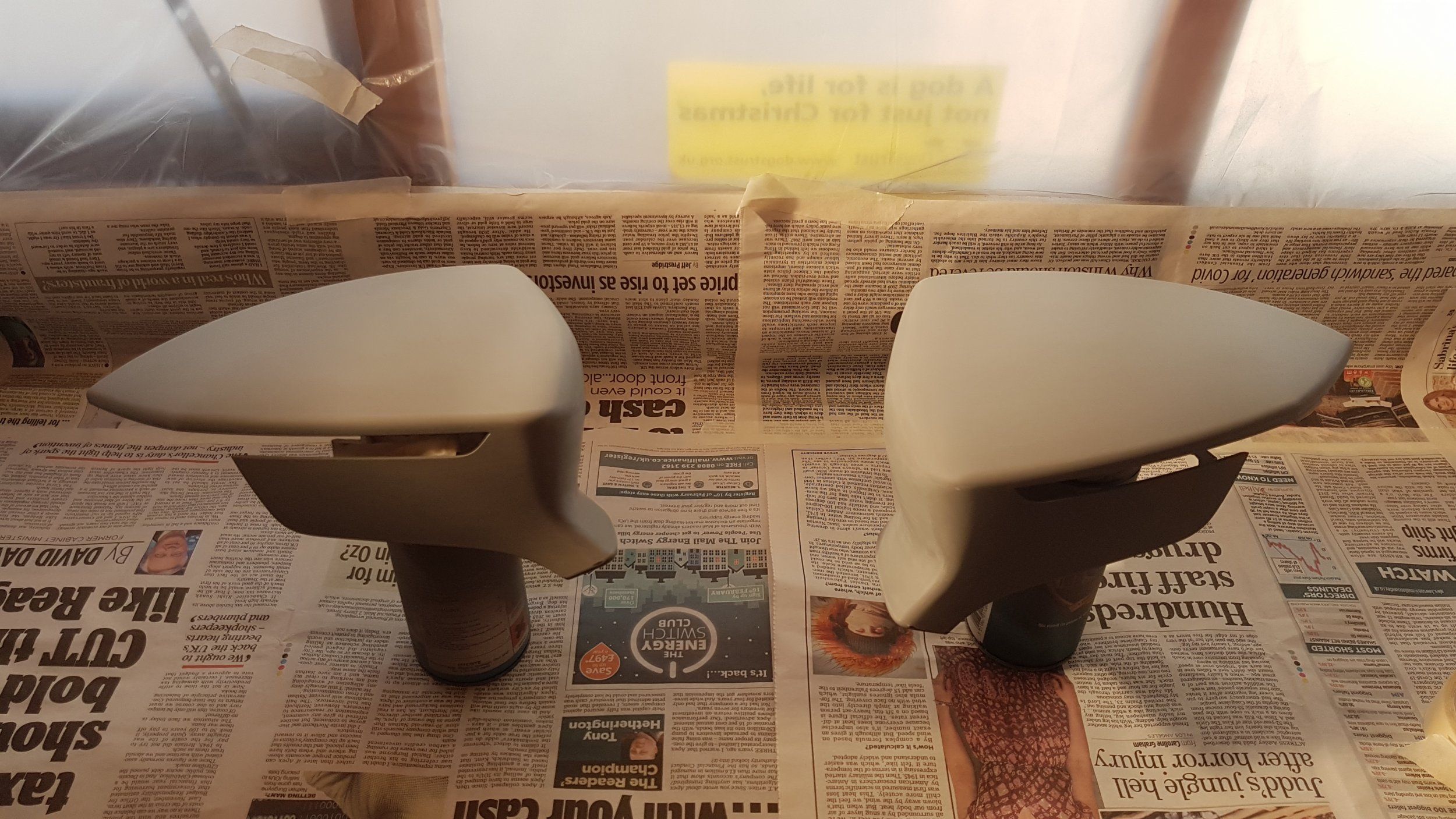

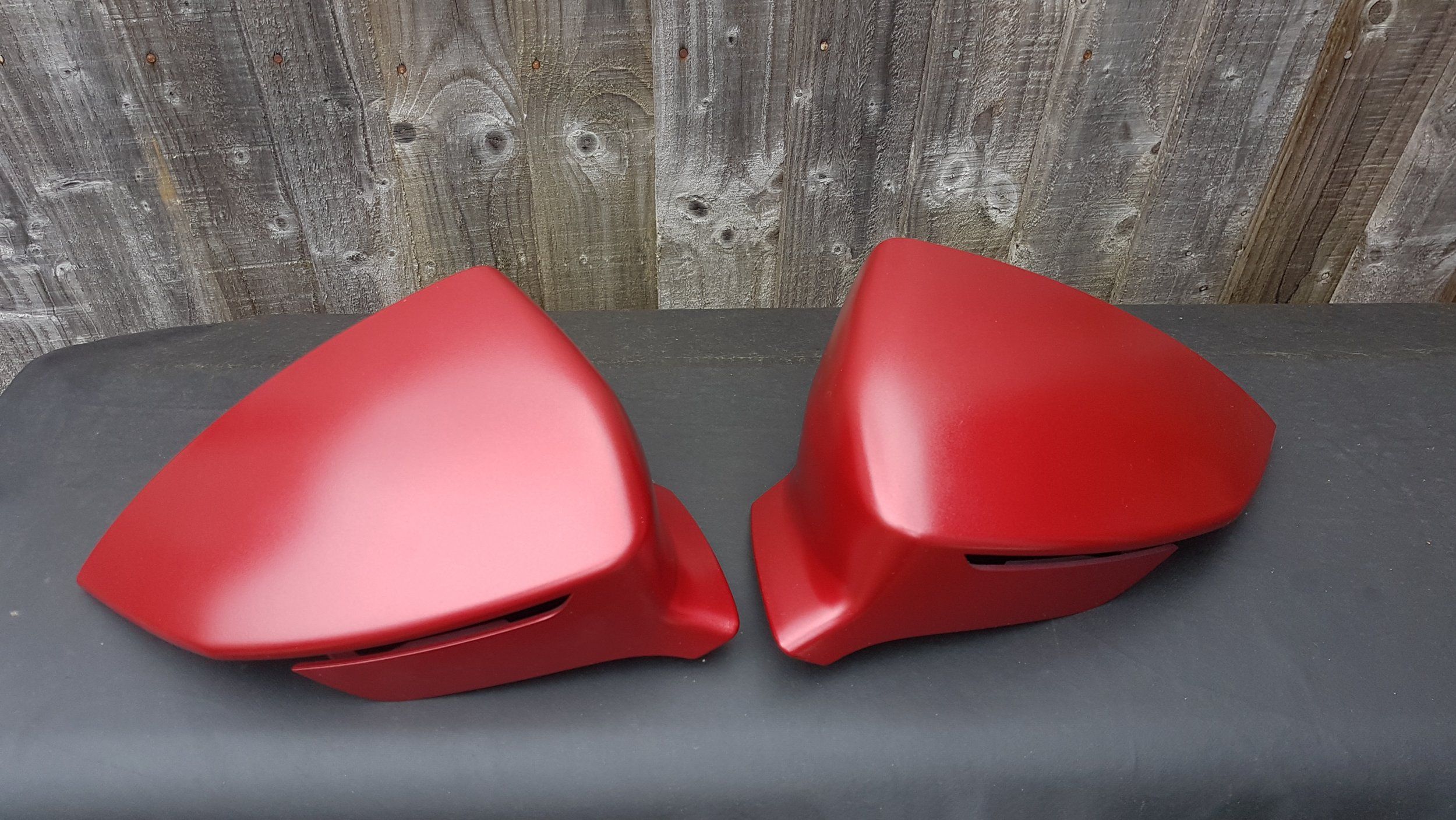

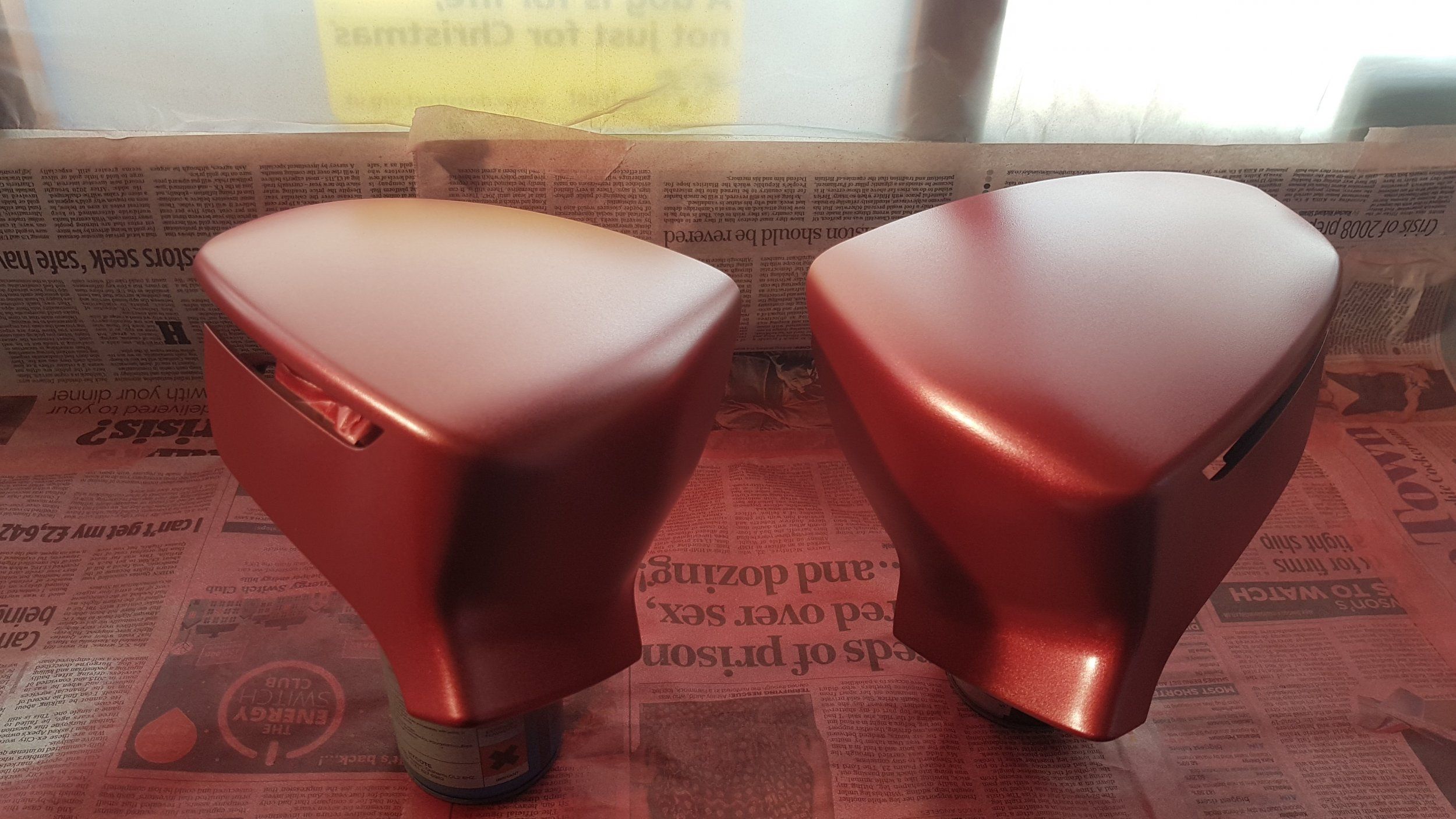

Nearly finished my little project with the wing mirror covers. Got both original parts of Ebay for £46, Seat wanted £171 for the pair!! Got the Merlot red paint code from Seat and had the paints made up by Automotive paints in Brighton. It comes in 2 parts, a ground coat and top coat reds, followed by a clear coat. I'll give a couple of days to fully dry out then sand back, fast cut then polish, that'll get rid of the orange peel effect. Will post the finished covers when done. Really pleased as I've never done this before.

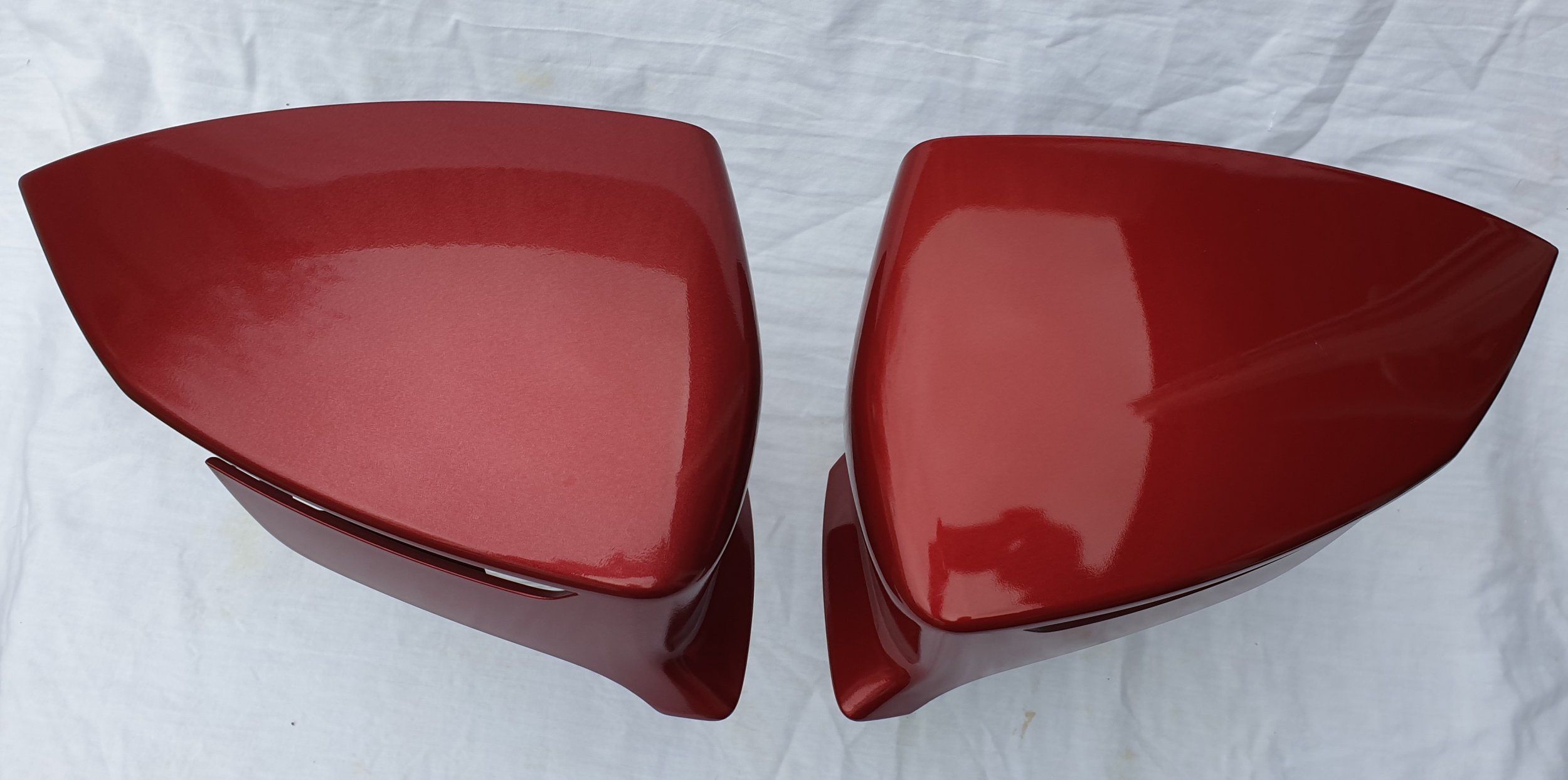

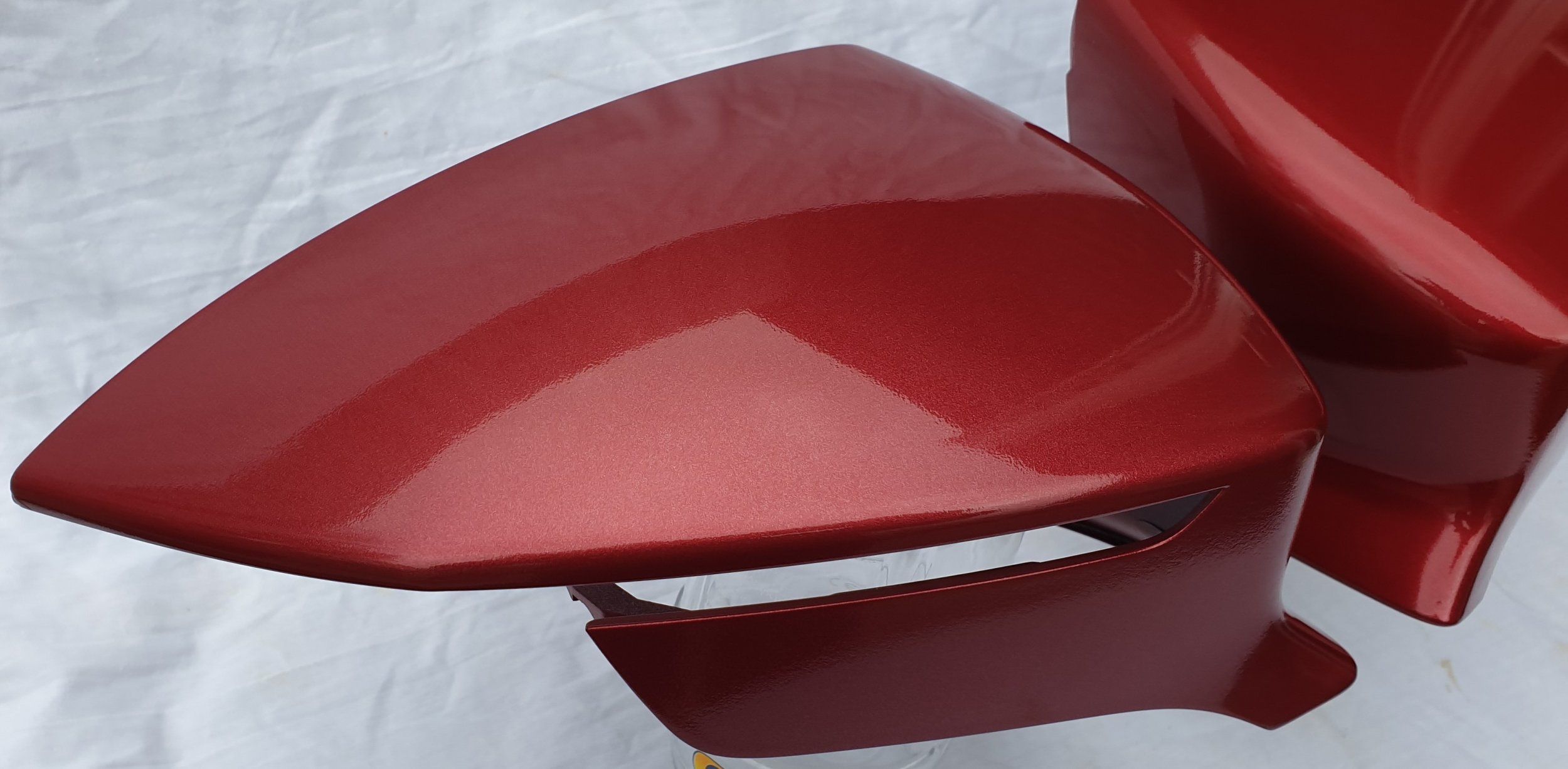

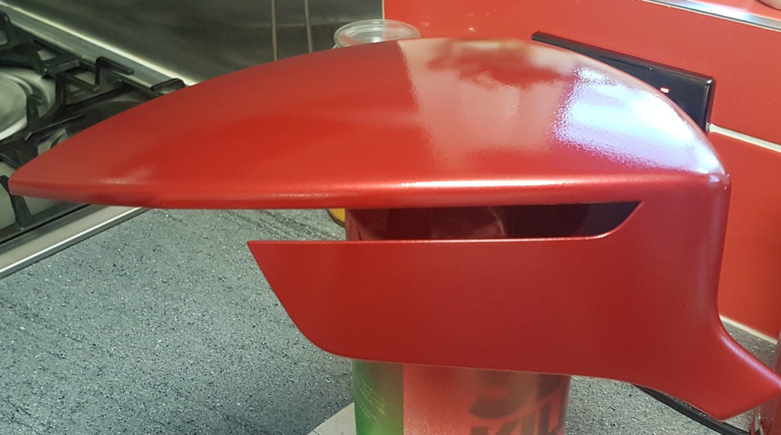

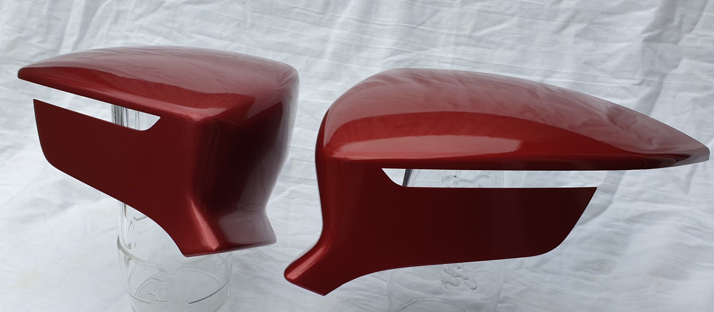

Finally finished the wing mirror covers. Really pleased with the finish article, just hope they match the colour of the rest of the car when it arrives:ROFLMAO::ROFLMAO:
