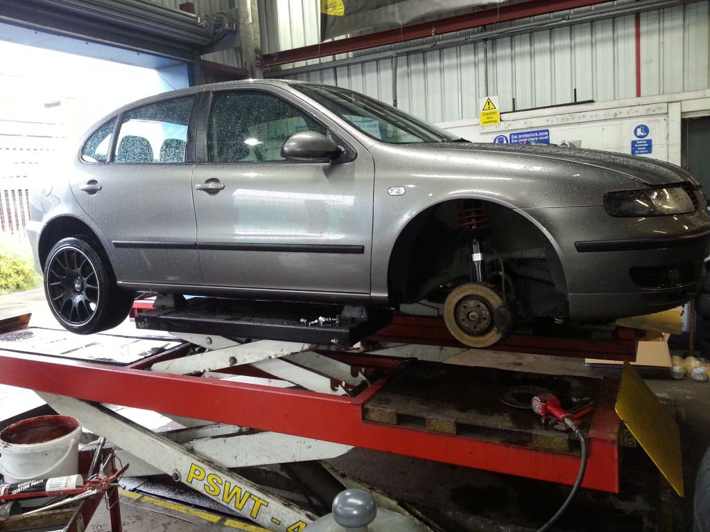

My Coilovers turned up today as did my interior. We were quiet so I fitted them.
The set up that came off is brand new Billy B4's and -35mm jamex springs that are all for sale if anyone is interested....
I'm happy with the ride height and feel. for cheap coilovers they feel great and i'm well happy.

I fitted my Audi TT 312mm discs and callipers while i was fitting the coilovers but am struggling to get a pedal.
Ive bled them twice now but theres defo still air in the system. Anyone had simular?
Also ordered and paid for a solid flywheel and sachs race clutch kit today. Whoop.
I've sorted the brakes out today. Just needed to bleed the M/C first then the calipers.
Bigger brakes do feel great now!

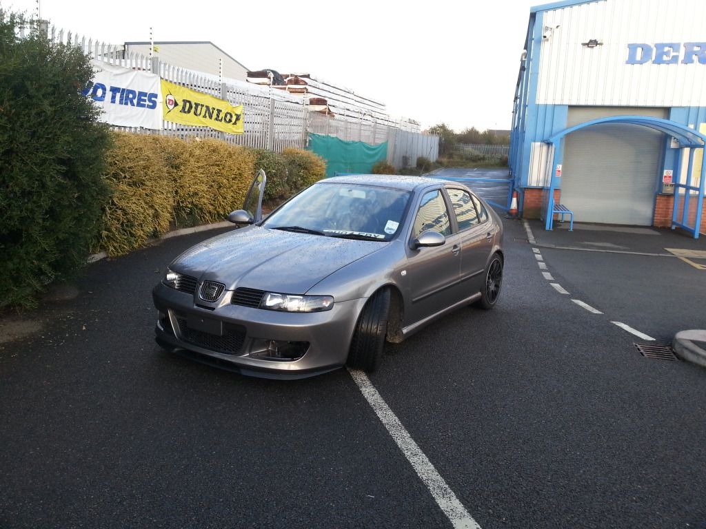

I've also retracked the car and set the ride height to where I'm happyish with it!
Pic's of the FK coilovers
And the car sitting how I want it

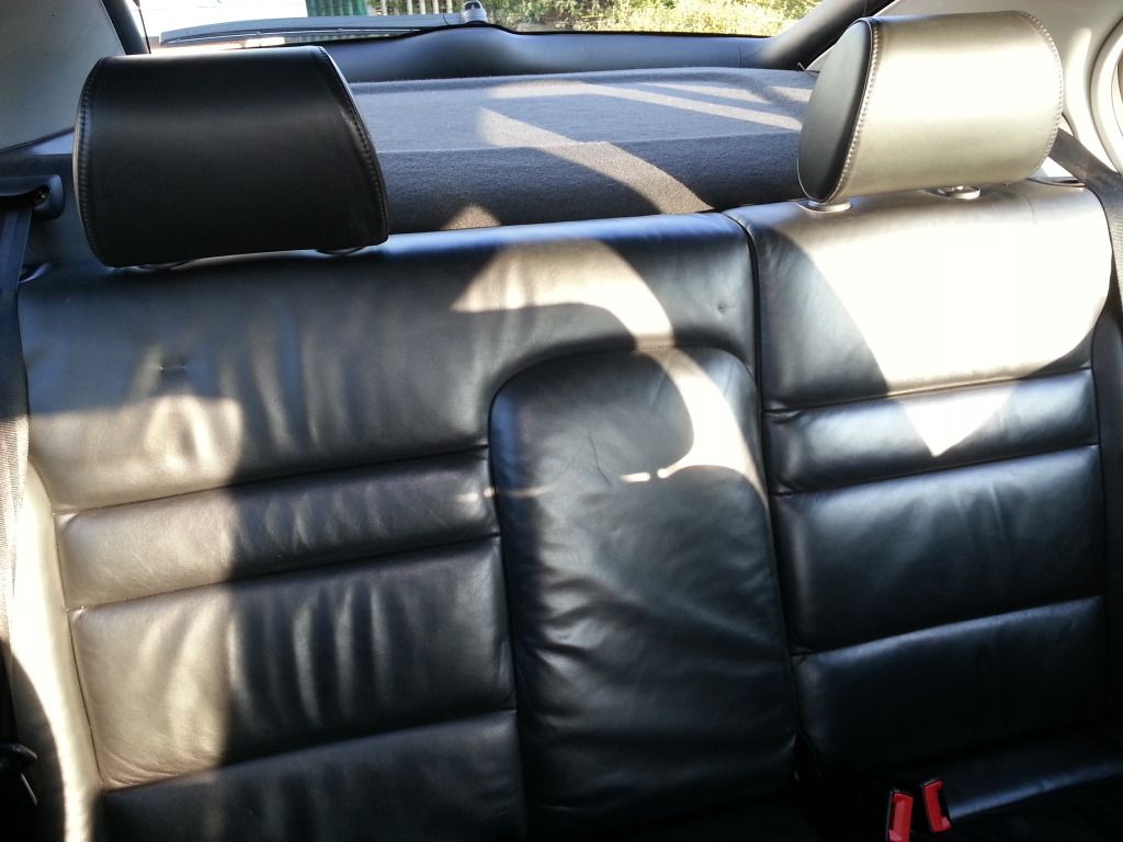

Right I haven't figured out the loom for these yet but got the lot out of the Audi. Once there fitted properly I'll post better pics.
All the seat are mint and the runners leather arm rest and runner cover came included. Oh and leather handbrake.[B)]

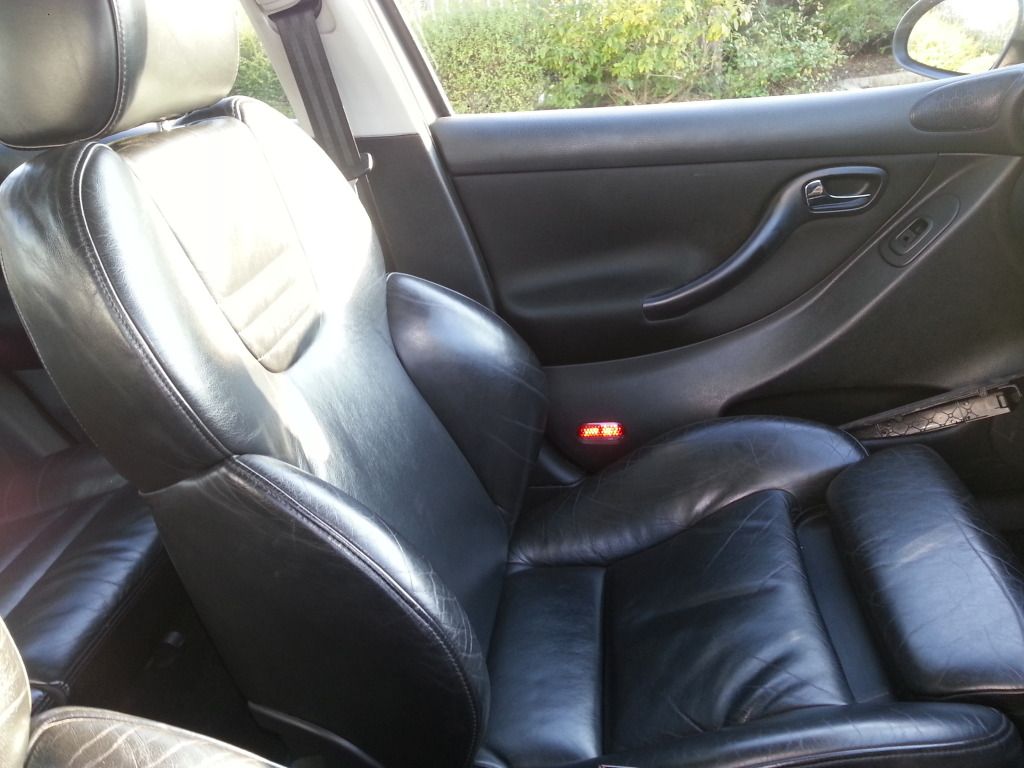

Well there in and they look great. These are soooo much better than standard seats.
Not the best pics cos of the sun but....
