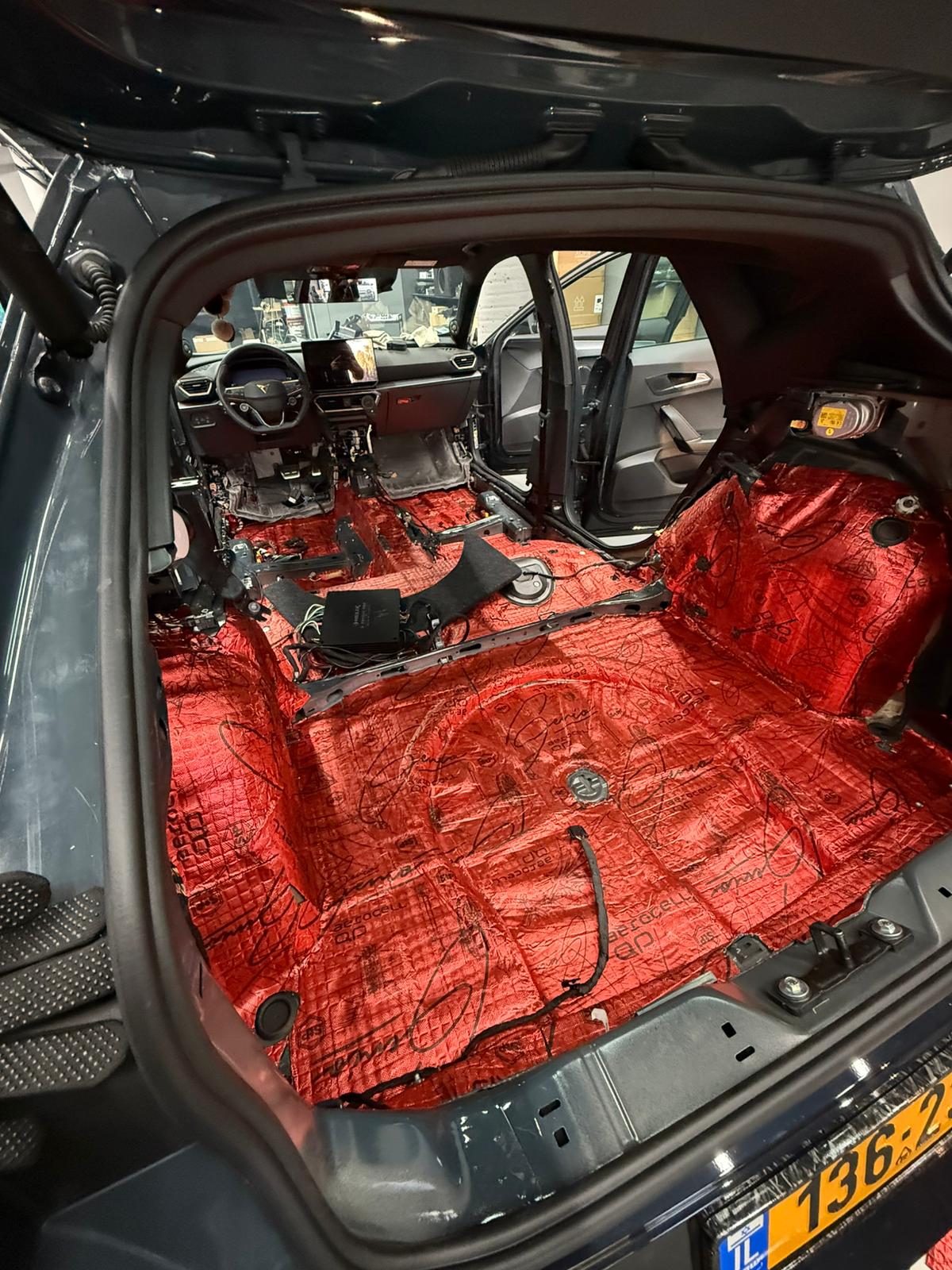

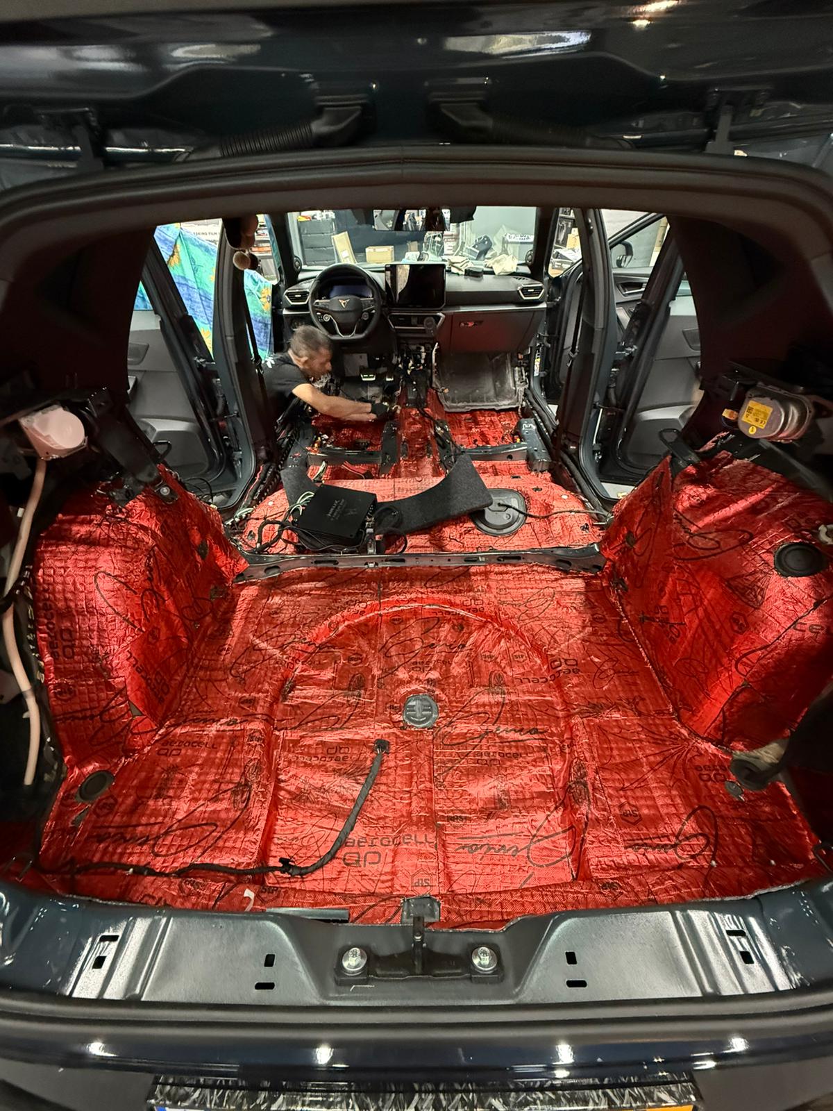

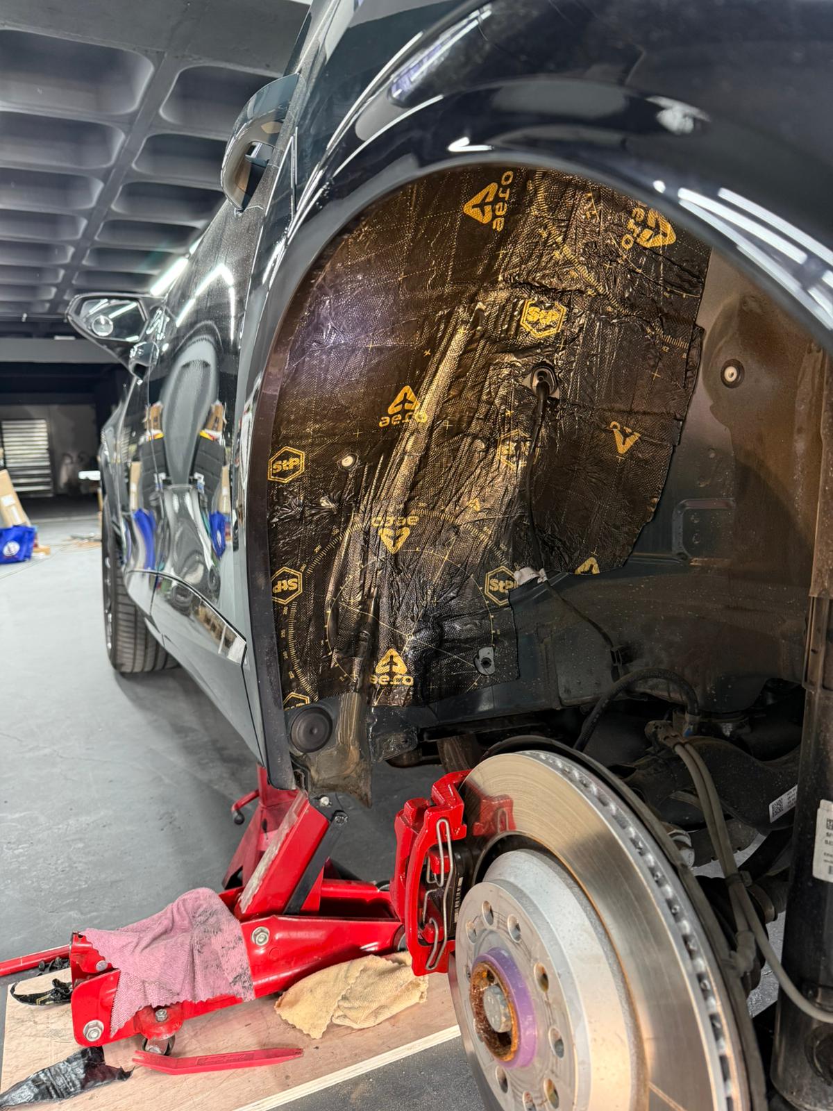

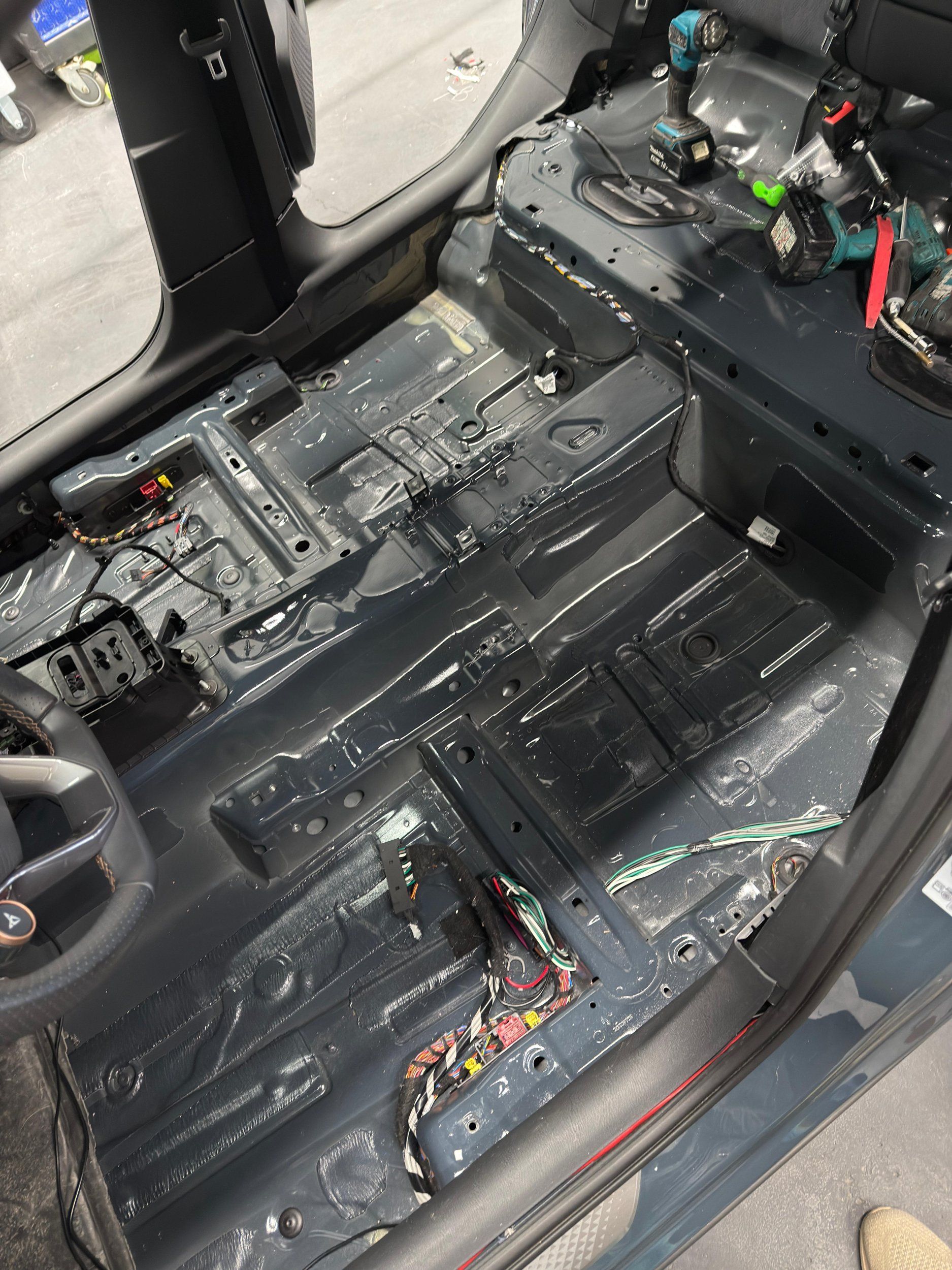

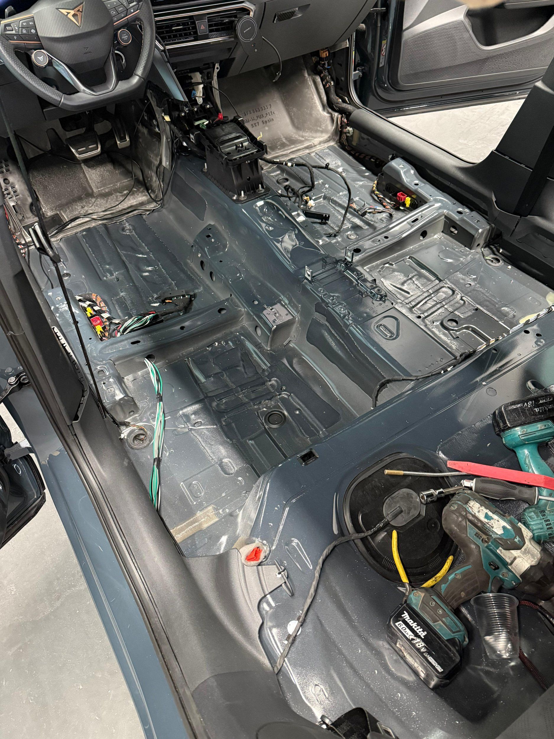

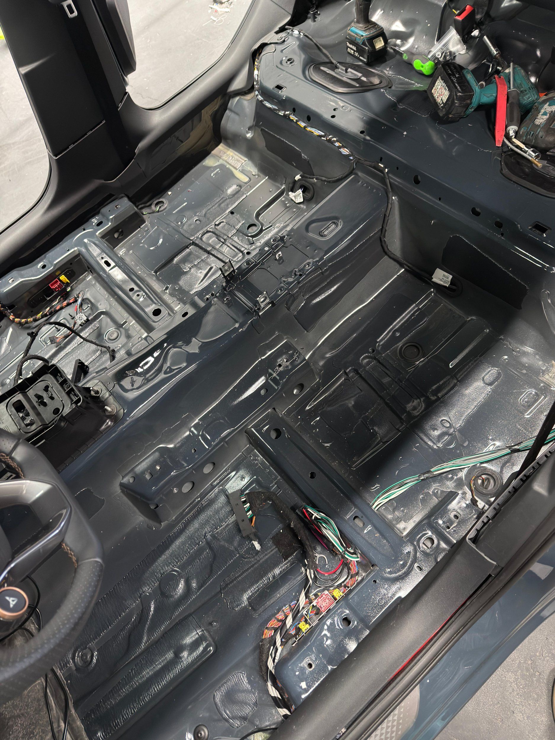

This car is very noisy in stock form, interfering with music listening and overall driving comfort.

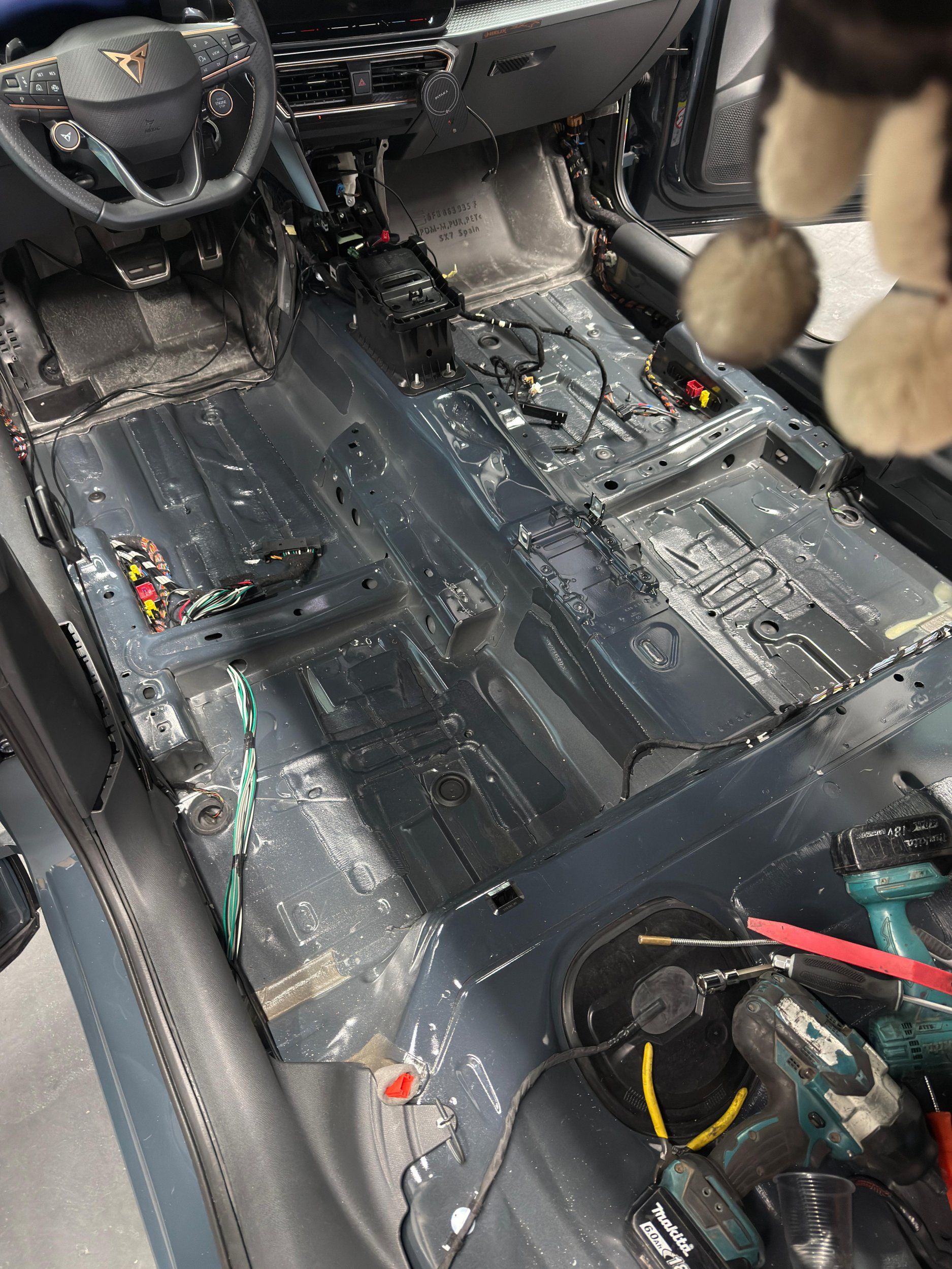

We're using Aerocell QP Genio soundproofing for the floor, trunk, and wheel arches. Note the funny little patches on the underside of the stock soundproofing.

Perhaps I will add more video/photo materials.

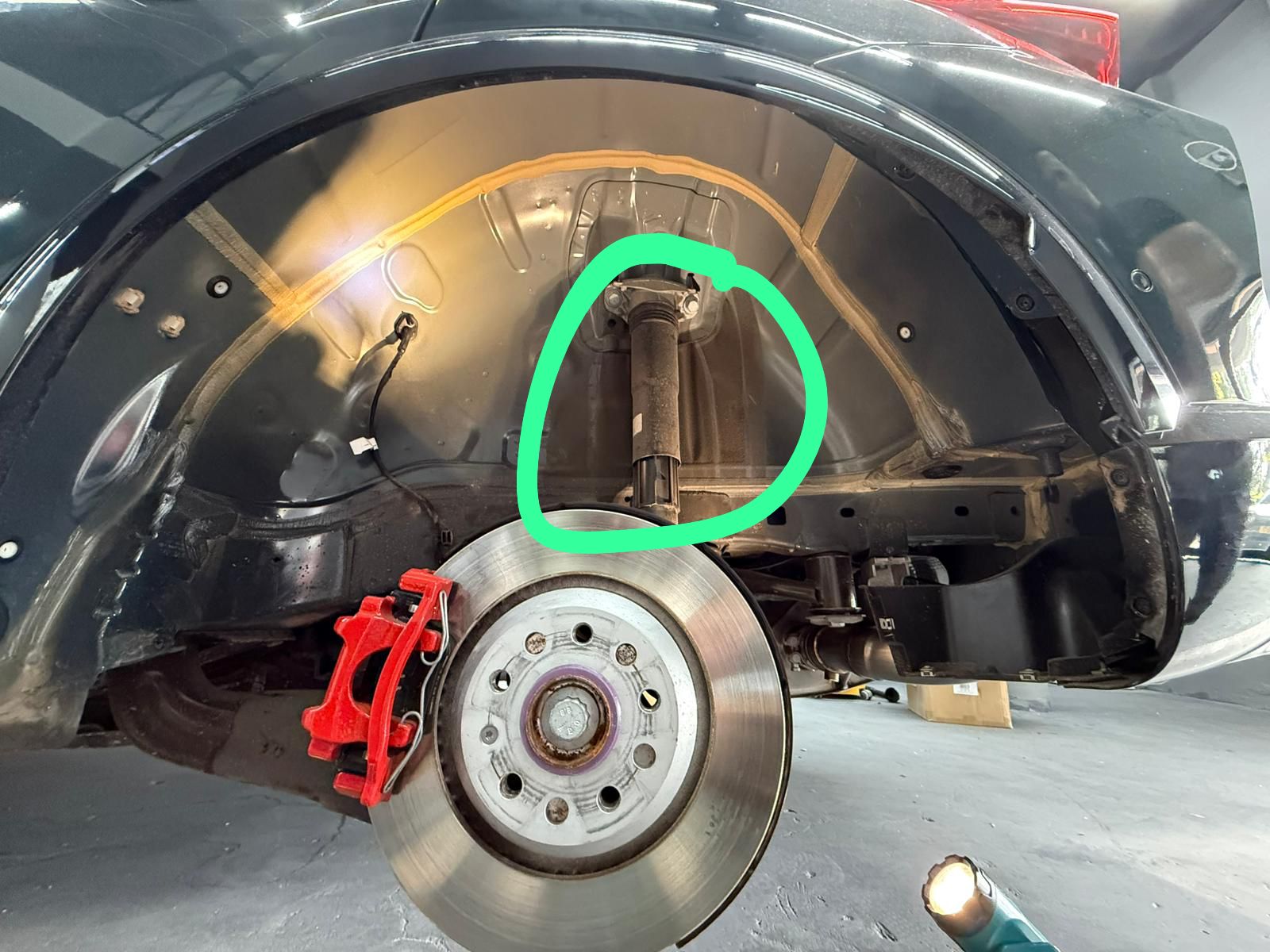

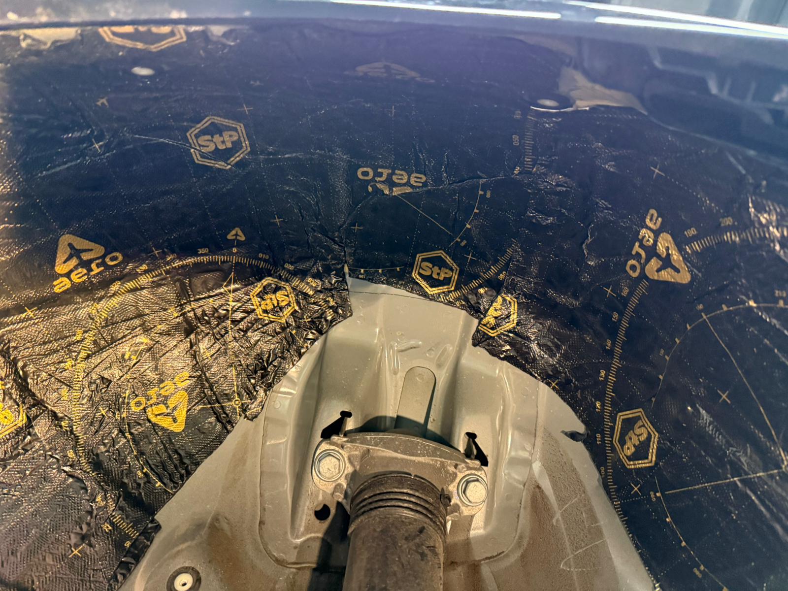

Where it's circled in green, there's some kind of thick anti-corrosion coating applied, but they didn't touch it. Besides, there's a cutout in the mudguard there, and the glued-on material would have been visible through that cutout, which isn't pretty. But they generally said that was overkill; what they glued on top is pretty standard.
