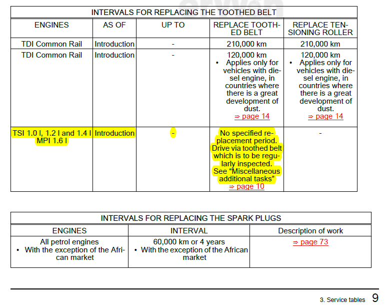

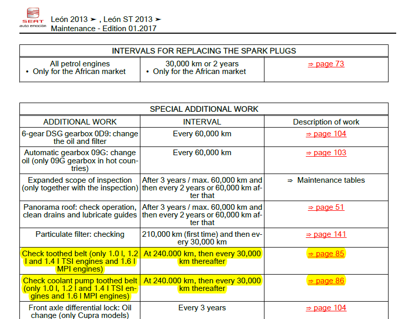

@GTunney,
I have the same engine on my Skoda Octavia 3, !.4 TSI 103kw, code CHPA. In the maintenance manual, for our engines, it 's not specified this interval for changing the timing belt. Probably, the dealers and the guys from auto workshops know better than those who built the car and made the maintenance manual.

@GTunney,
I have the same engine on my Skoda Octavia 3, !.4 TSI 103kw, code CHPA. In the maintenance manual, for our engines, it 's not specified this interval for changing the timing belt. Probably, the dealers and the guys from auto workshops know better than those who built the car and made the maintenance manual. View attachment 586 View attachment 585
I can’t find anything like that in my actual car manuals. Do you have a link to that documentation?
