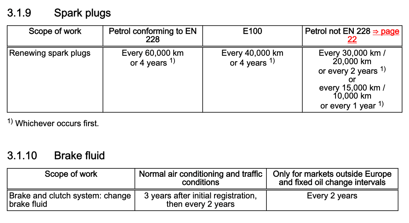

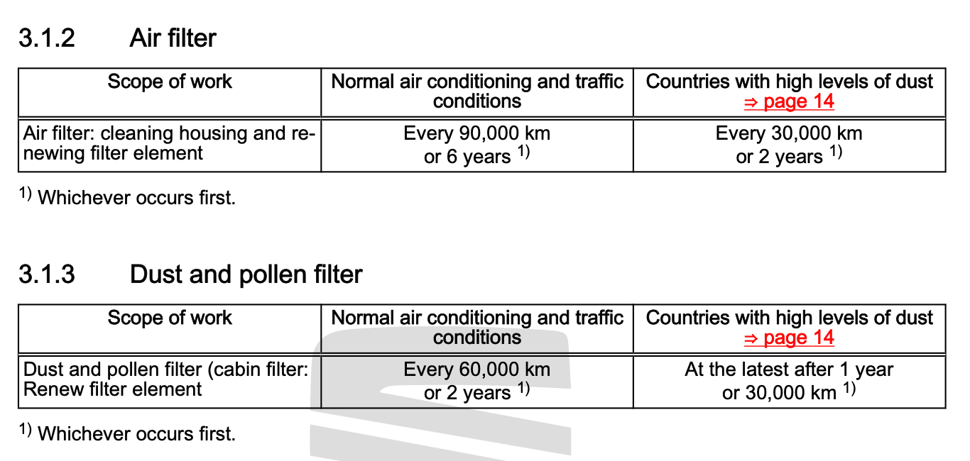

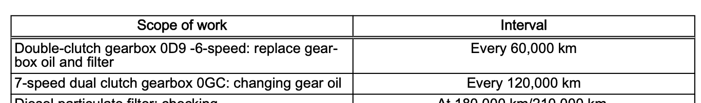

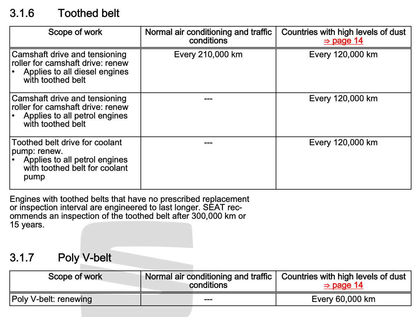

Here is everything that might interest you:
Thank you very much @grabania ! As I do not fully understand all the above points ... is the "timing belt" the "toothed belt" or just the timing belt service is not included in the ordinary maintenance, like says @Walone ? Thank you for your time guys.

The water pump is driven by a toothed wheel at the end of one of the camshafts, at least it is on the 1.4 engine (CZEA).

One big reason to change the water pump along with the cam belt, when it was driven by the cam belt was, the load on the water pump bearing was huge, now that the water pump, on all EA211 family of engines and maybe some others, is driven by its own small toothed belt by the "rear" of a cam shaft, the water pump can be made differently as the load on its bearing is only the load that its own drive belt exerts on it. In other words, it was the load of the cam belt that was killing the water pumps early and as changing the water pump, if left out when replacing the cam belt, just lead to paying for another cam belt change along with the failing water pump.
