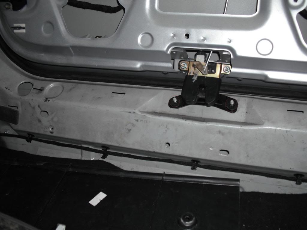

You have to get into the boot area by folding the rear seats flat, then you have to loosen the screws in the boot trim.
[/URL][/IMG]
Then i just pulled the trim out (it's not easy, but it will come out and you'll break the part near the lock but it's the only way i could get it out) Then this is what you'll see.
I just loosened the two nuts either side of the lock and then you can open the boot.
Hope this helps.
