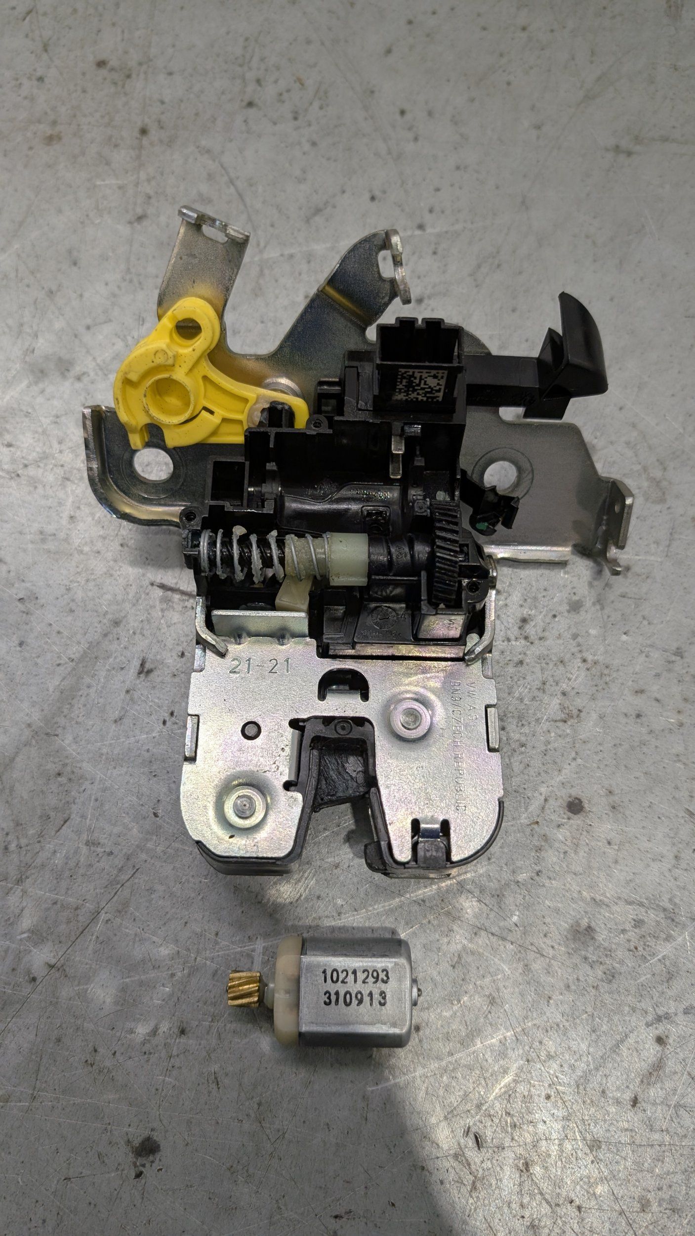

Happened to my car two weeks ago, scanned the car and boot lock motor was short circuit. Replaced it and all good now.
So to be clear it's the latch on the boot lid, was about £95 ISH.
Hope this helps

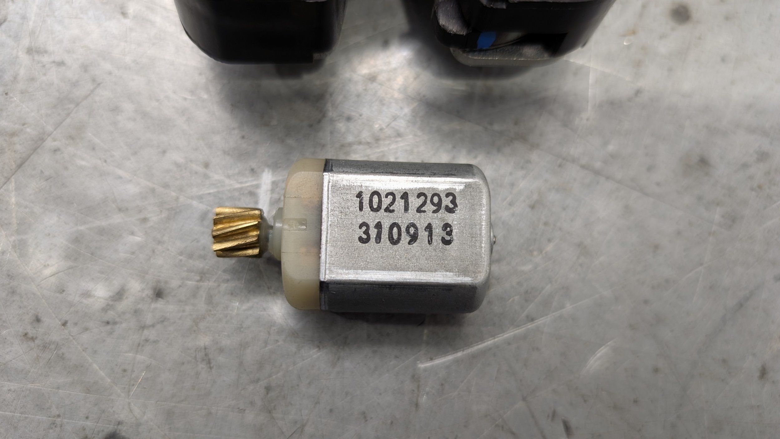

I replaced the whole latch, if you Google the number on the motor it does come up on AliExpress but you have to buy 10 for £60!
The motor looks like it's out of a scalextric car,?
There is a little plastic door where the cable goes inside the latch open this and then you can twist the cable 90 degrees to release it.

Morning oily yep sorted it out,mine started the same,every now and again wouldn't open,steadily gets worse til it opens no more,its just the boot release mechanism not the whole motor,my tips came off Matt,the previous post,n greatly received!!!easy fix,taking the plastic trim off can be a faff but its definitely a diy job,i couldn't source the part from cupra,its on back order there are that many failing,part is on all vag group cars,got the part code from cupra,the original part is discontinued,and sourced it from "parthaus" on net,cost £60 and a bit of faffin for an hr.
I rekon changing the motor would probably work too,tiny lil thing thats easily removed,if i just had the motor rather than the full mechanism i'd have probably given that a whirl 1st!!!
Not sure if photo of parts number uploaded,let me know if you need it.
Hi Dave... Thanks for feedback. I've just searched the web and it looks as though you can now get just a single motor for around £10. Think I'll order one and give it a go. (That's as per Matt's image with part number).
If you have any additional numbers they would be greatly appreciated... Thanks
