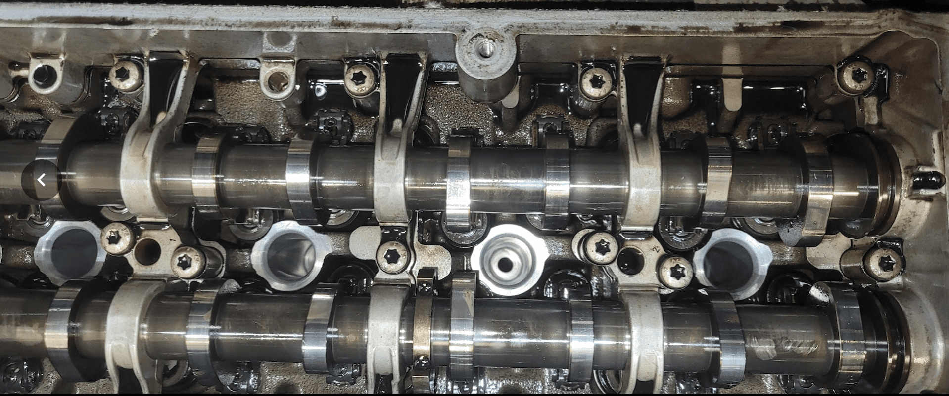

This is my cylinder head after 160,000 miles. Very clean -
So next you'll be on the DPF cleaning rabbit hole ;)

Yes that is definitely clean!....how many miles and oil changes has this had on the Valvoline?...btw i have just ordered some and some B12 for the soak.I get what you are saying about the flushes...still doing research on them at the moment as undecided...some people seem to have good results with the BG EPR 109.Regarding the DPF rabbit hole.....i need to not plunge down that one (if possible!) at the moment because i think its pointless while the engine is burning lots of oil... ;-)
I've only been running RP for 3 weeks, so that has nothing to do with how clean the top of the cylinder head was.
I was also surprised how clean my inlet ports were where I changed my air to water cooler. I had only 'unknowingly' seen pictures of Euro 6 engines which were generally all caked up with carbon in the inlet, so that's what I was expecting, buy my inlet ports/valves were also very clean! - but mine is a Euro 5 CUPA, and only has one low pressure EGR valve AFTER the DPF, so all my EGR gasses are very clean passing through the DPF. The Euro 6 engines have two EGR valves, also having a high pressure EGR coming directly off the exhaust which is NOT clean - so these tend to be much more contaminated.

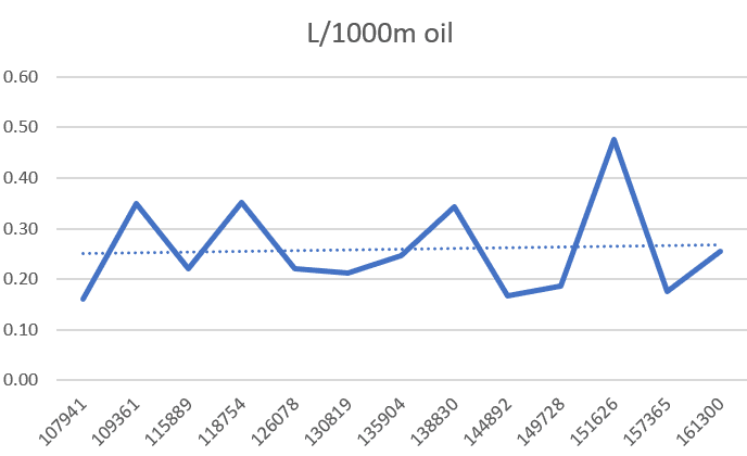

My average oil consumption has been fairly consistent, with only a slight trend in getting worse over the years. I'm still having to top up oil approx every 4000 miles which I feel isn't good enough.
Although my oil consumption seems 'common' on our EA288 engine and much lower than the ridiculous VAG 'allowance' I still wouldn't call it 'good'
My oil consumption over 55,000 miles:
