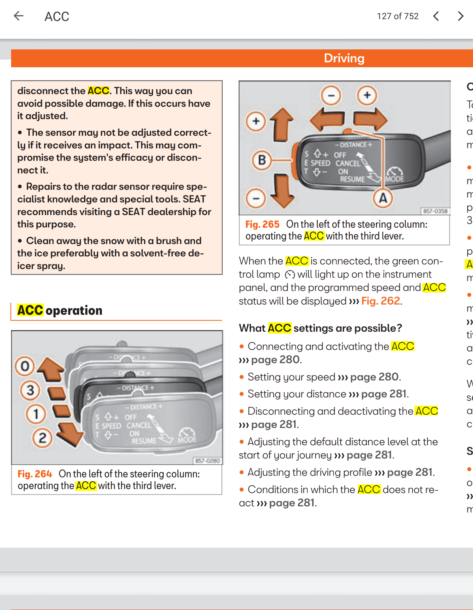

I believe with it available you tug the third lever as per the text below. Push the lever to the front of the car to turn it off then the offending graphic will disappear and you can then read what you want. Been 5 years since I did that but reckon that's the simple solution if you plan to use ACC just click it off to read.
That's "0" on the page below and I reckon it will vanish.
