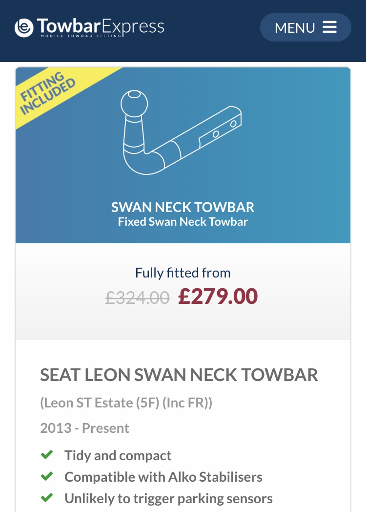

I've never had a towbar before so am learning all about it and have found a swan neck towbar and fitting at a price I can stomach from Towbar Express
But...
In the description it states “Unlikely to trigger parking sensors”
That phrase concerns me as I don’t want to get a bar fitted that ‘might’ trigger the sensors.
Does anyone here with an ST have experience with swan neck towbars (specifically from Towbar Express) and their parking sensors?
Will it bugger up my sensors? Or will it be fine?

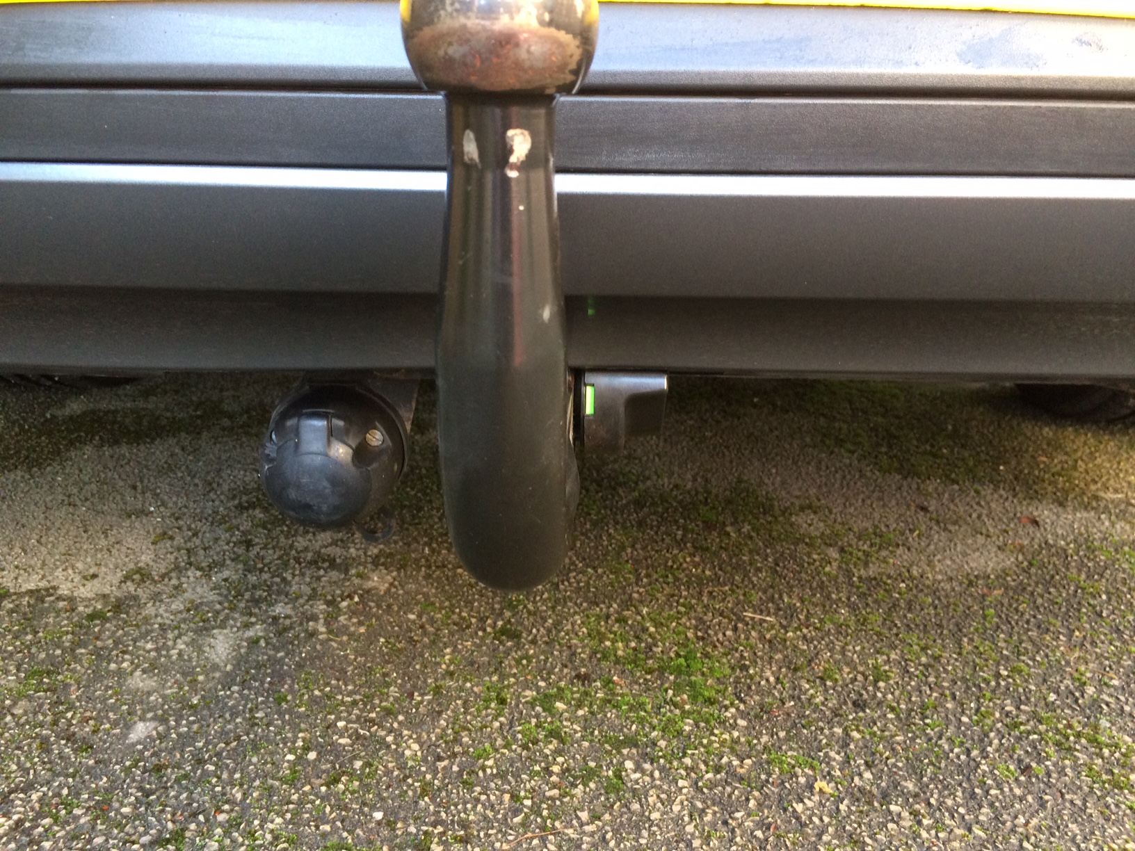

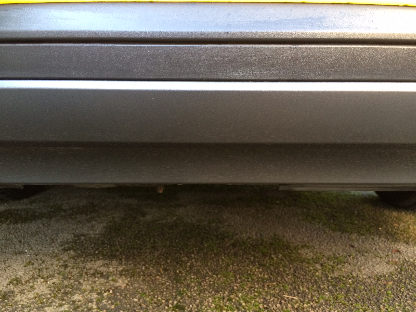

Any pics of your install.
Some images of my install, first image is how it looks from the rear without the detachable bit fitted.
