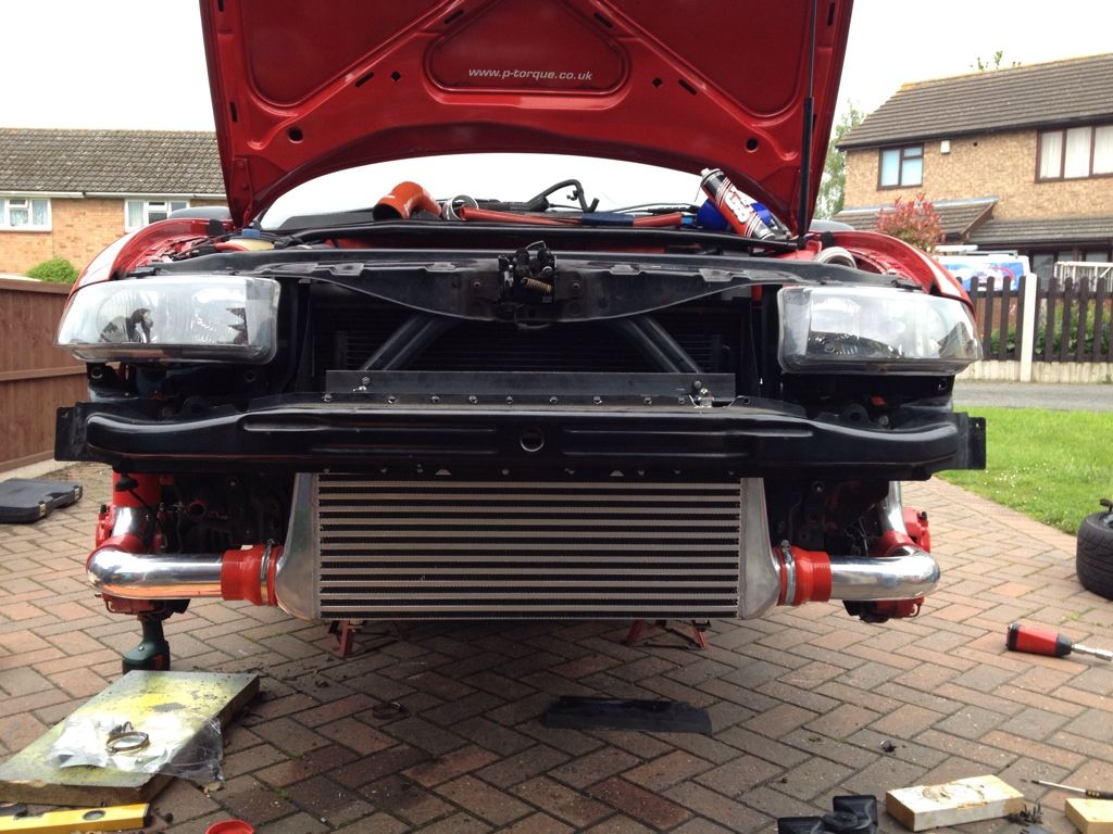

It's cheaper to buy a welly cooler and a universal piping kit. You get a huge cooler and cost no more than £200.
Excellent cooler for the money, a lot of people running it now, worth a look
It's become known as the welly cooler because a chap called Welly on audisport with an S3 first fitted one.

The only extra thing you would need would be a MAP sensor pipe, forge sell them or you could use your original one :)

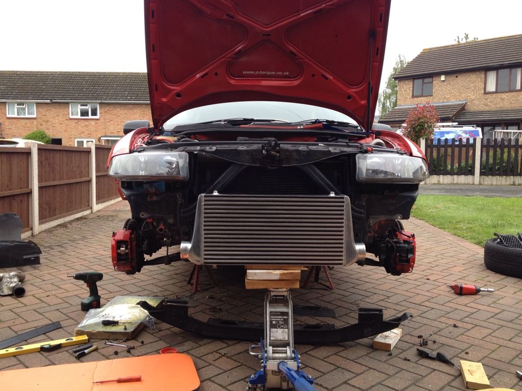

I'm running one, fitted it 2 weeks ago and it's been amazing ever since. My RR should have a load of pictures of the fitting.

No it was pretty straight forward to fit just time consuming. The hardest part being making brackets to hang the cooler from and getting it straight!

That piping kit wont fit surely....its for the 64mm cooler (the cooler below this size)
You buy 2 reducers, if you look on the first picture you can see the reducer coming off the cooler
