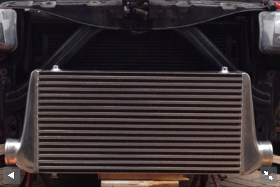

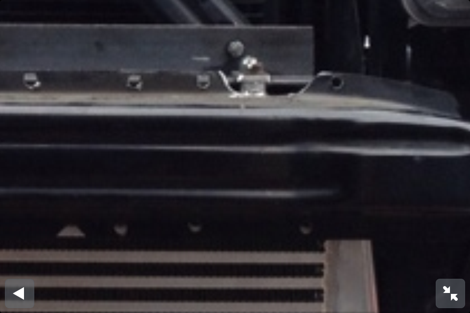

The welly cooler is still going strong mate, really happy with it. It cools best when ambient temp is around 12-13 degrees and pulls like a train.

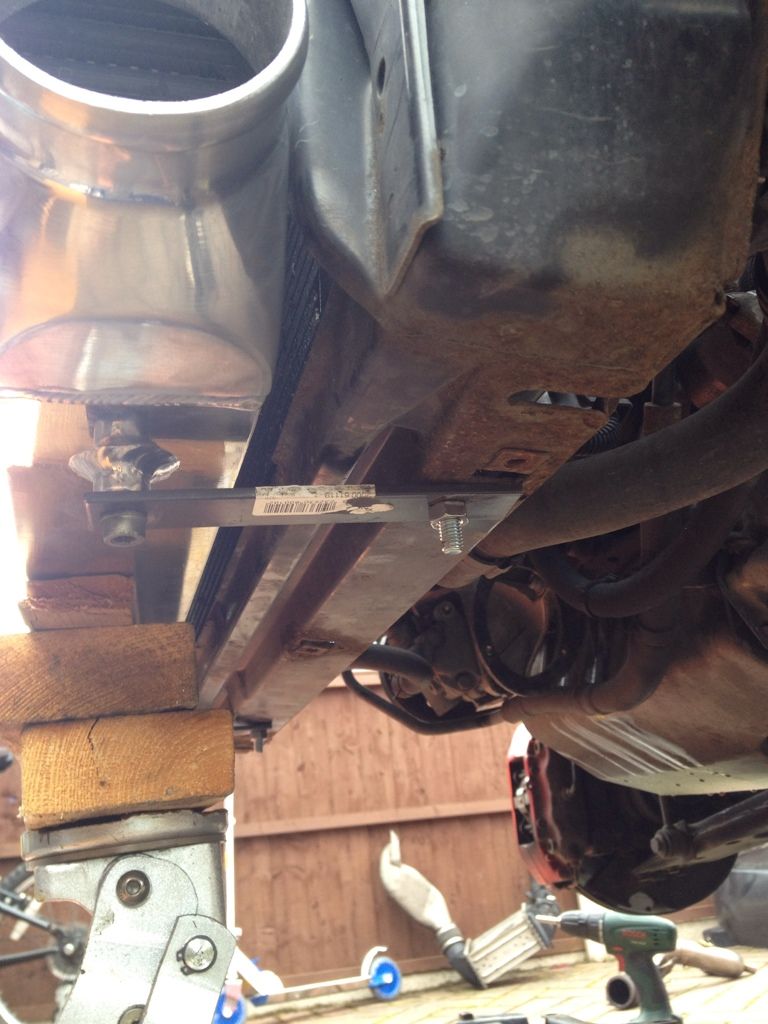

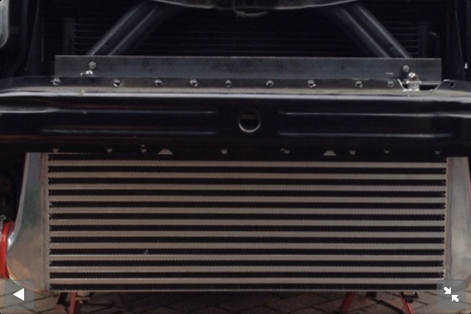

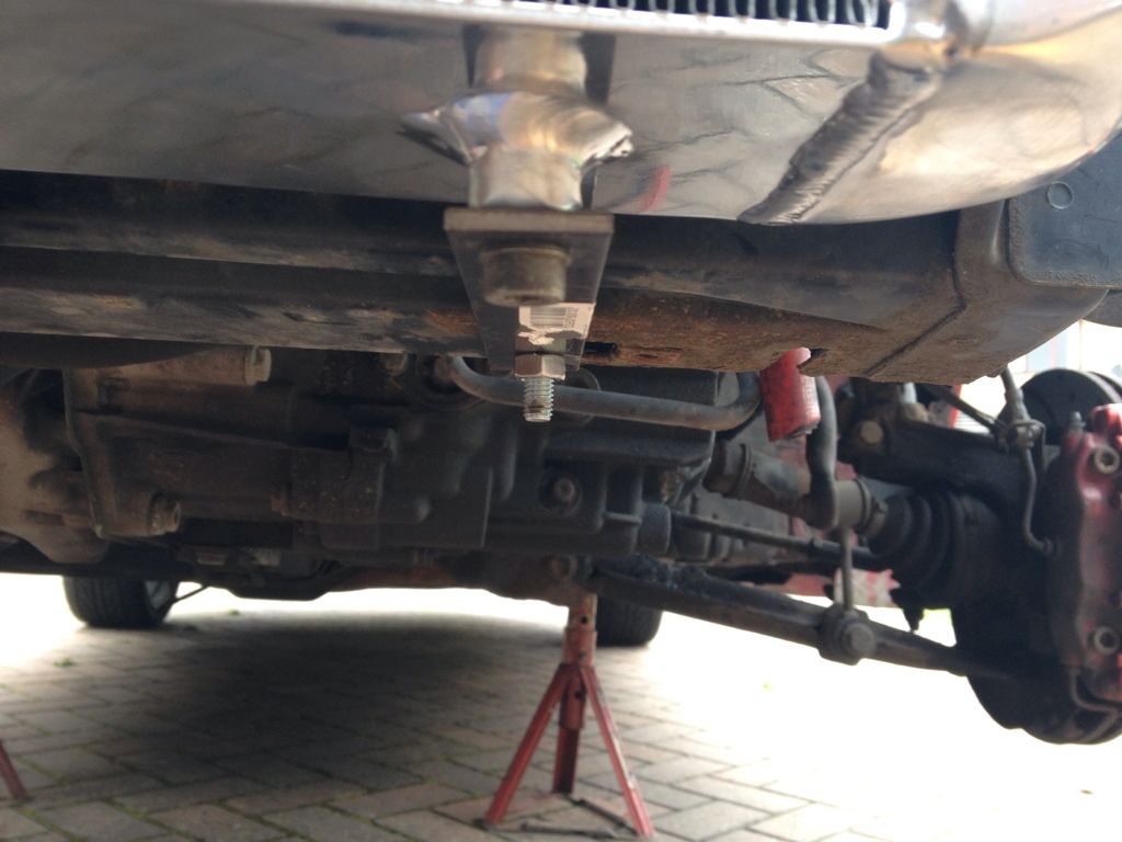

When I mounted mine I went to B&Q and got a length of box section. It bolts onto the cooler and then drilled into the centre support in front of the rad, the v shaped bit and bolted the box section to that. For added support I put 2 bars on the bottom and mounted them under the car.
Give me a sec ill look for pics.
Edit: found some pics of the mountings

I have a 225 inlet mani so yes it would be the same route, what piping kit are you looking at? I got a universal one and made those fit.

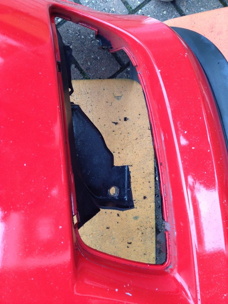

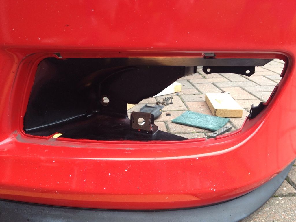

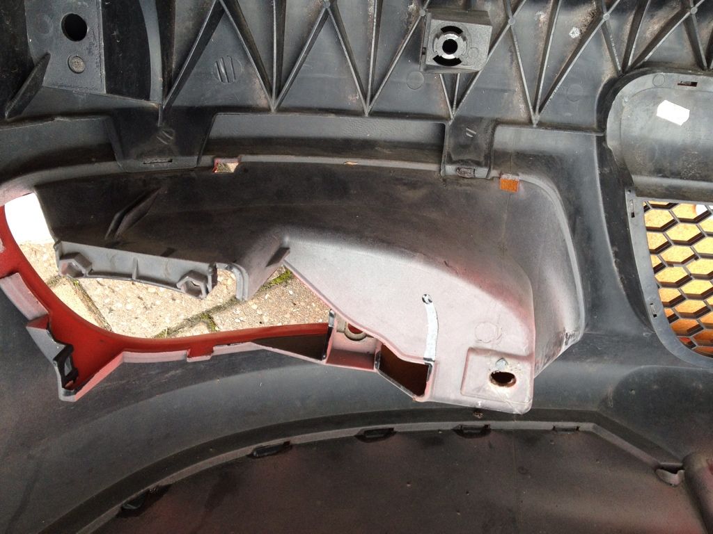

You need to trim the bumper by the fog light mountings but it is possible to keep the mounts and your fogs.
Nice info and photos,I've also got a wellycooler and custom pipework ready to go on and I'm looking for photos of the bottom mounts for the core,anyone got any more photos?

The trimming of bumper required.

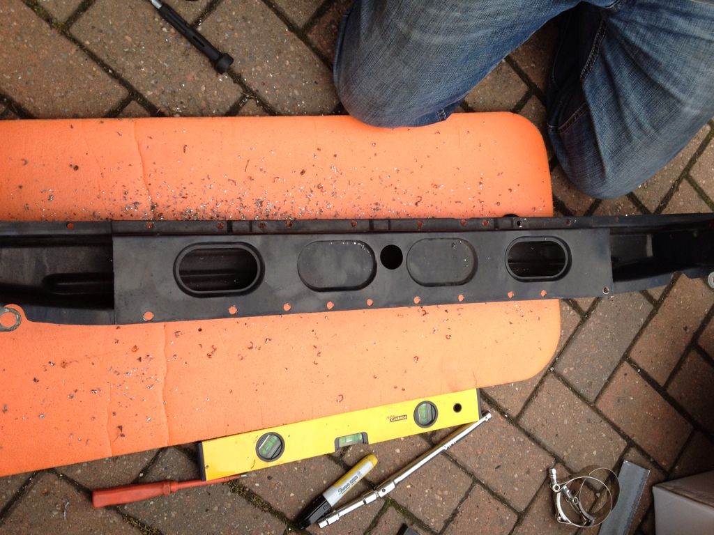

Trimming of crash bar. Once you've drilled the spot welds out you can take the back panel off and you shouldn't really need to trim it then.
