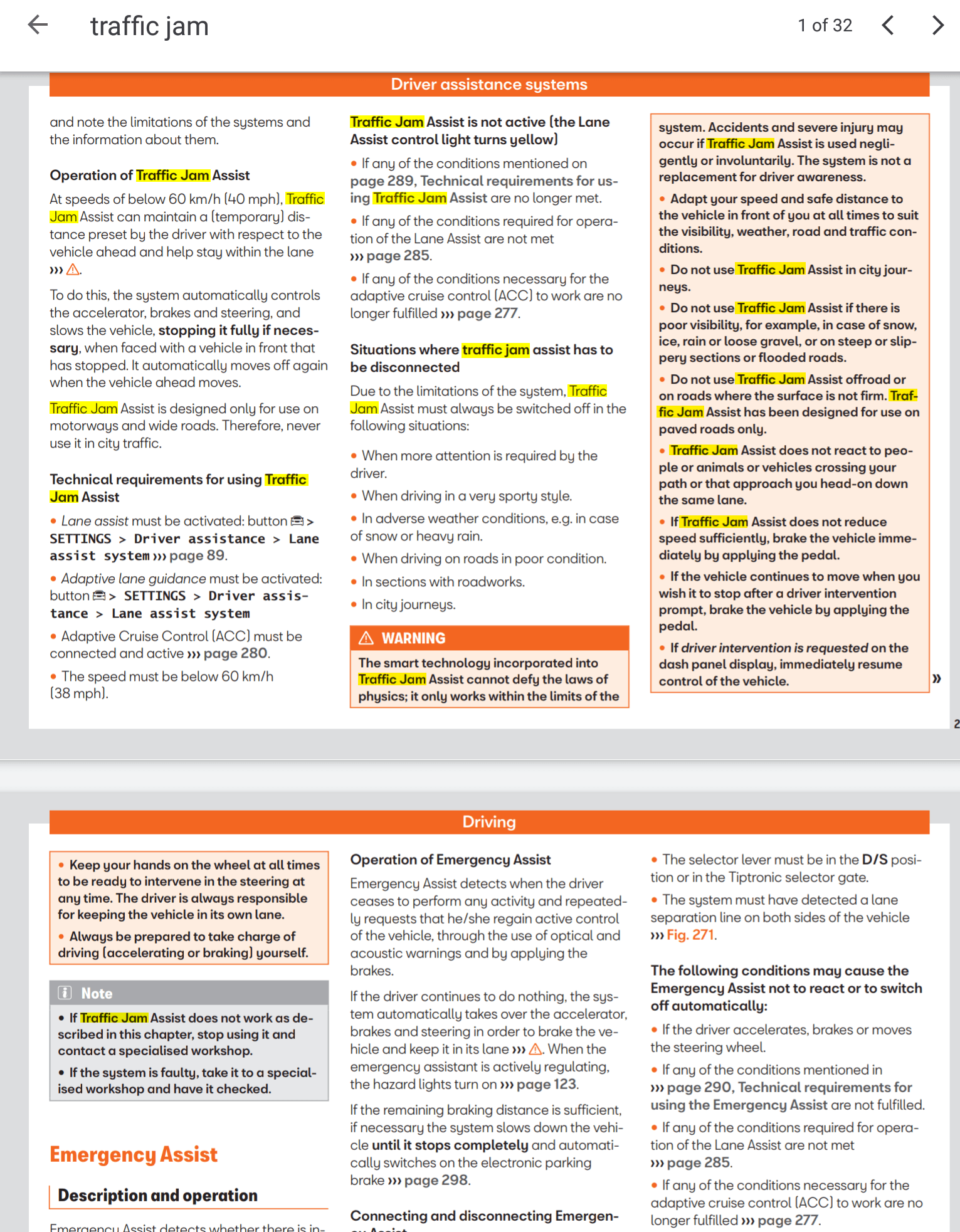

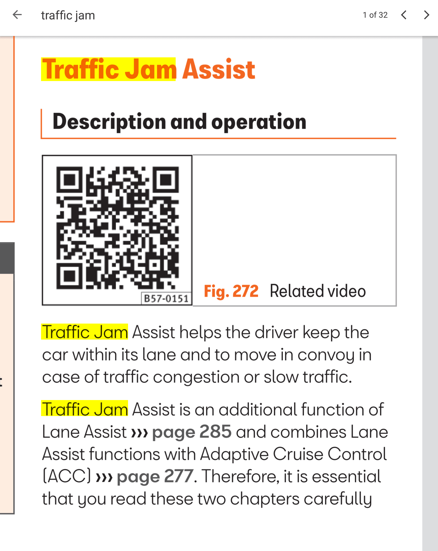

I've got the adaptive cruise control & lane assist, but I don't know if its a different module than the traffic jam assist? Whats the difference, if yes.
I noticed that lane assist works at speeds 60 km/h+, so basically works on highways only, cant find the function of traffic jams situation
Thanks
TJA is used on DSGs... it will take you thru the gears. Take you down to stop in a queue and off again when the queue moves. I've got it, only used it once ?. Prefer to drive the car myself. I can see on a regular commute with heavy traffic it has it's uses. An addition of functionality over and above lane assist and ACC.
There are Seat demo videos somewhere (link above doesn't work) have a Skoda one.
Well yea, so I basically have it by default since I have ACC and DSG. But its scary tbh.
