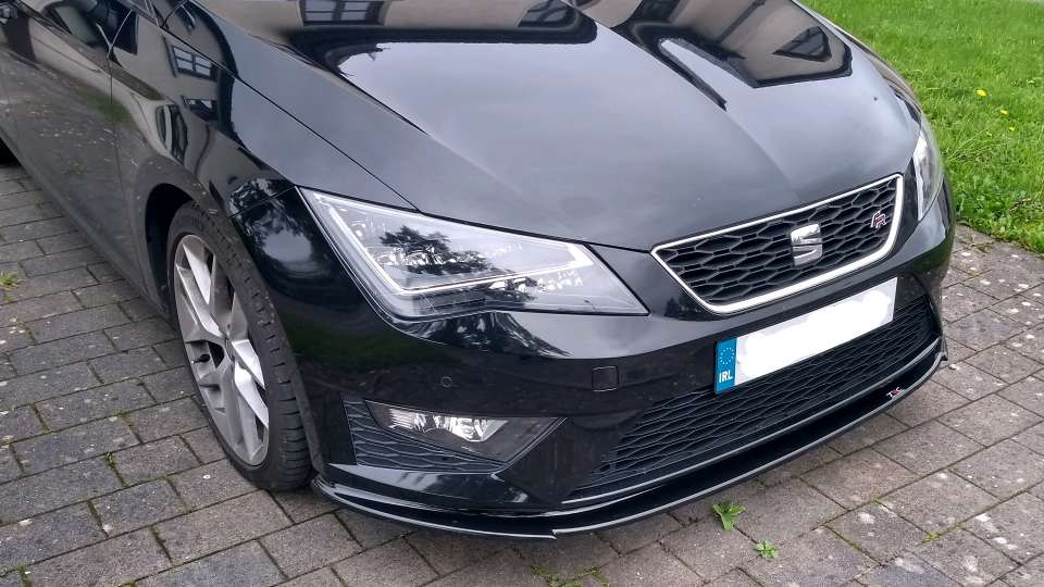

Finally got it fitted, it took me and a friend just over an hour. I didn't take off the bumper, but did use a small bit of double sided like was suggested. This helped a lot with the alignment, before drilling.
To get at the bolts, I removed the main under tray and the small under tray/guard , also 2 screws out of the wheel liner to get at the edges. It wasn't that difficult, just fiddly with those washers and nuts. I lightly clamped the nut into some vice grips, to guide it over the bolt threads. This made it so much easier in the narrow spaces.
Cheers everyone for the help.
MiTz
Jul 23, 2018
125
39
Car needs a wash, but here's some pics.
