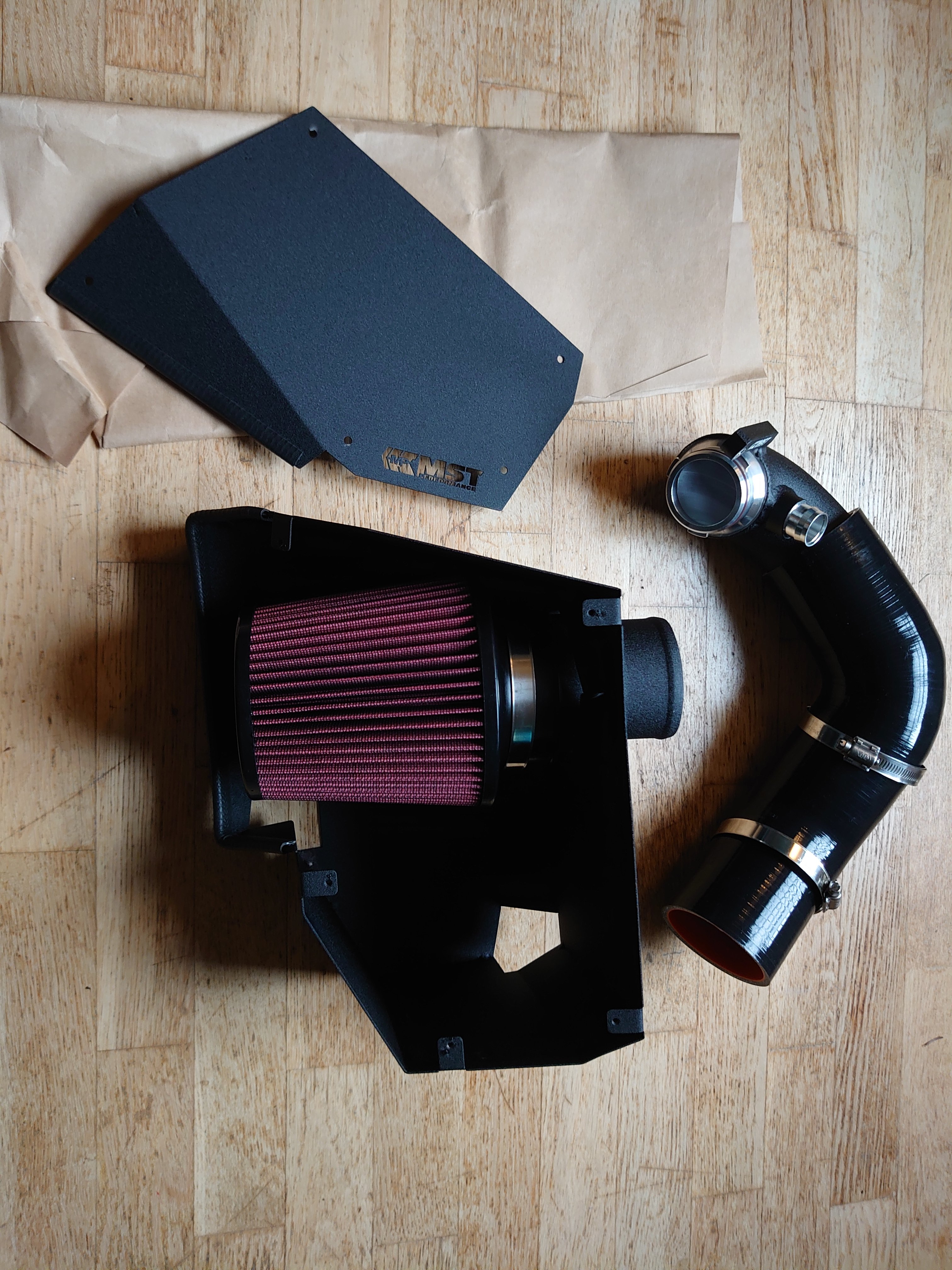

Haha OK many thanks, will give it a go tomorrow when I get the kit :)

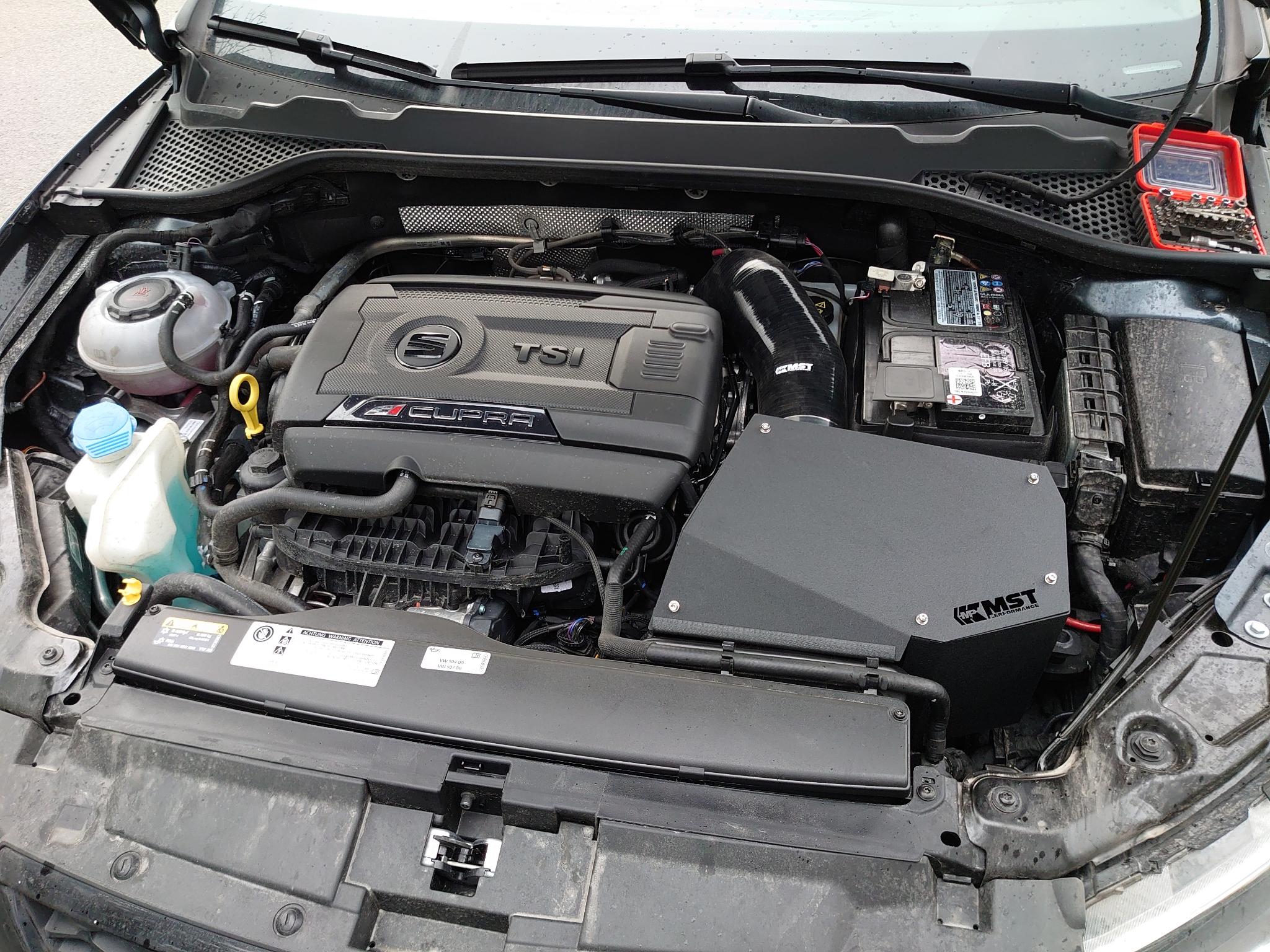

Oooh shiney.

Looking good - I have one of these ready to fit too. I'm not sure it will do as well as a full R600 on temperatures but as linked above, looks like it flows a little better and it cost me much less than a full Racingline intake would.
