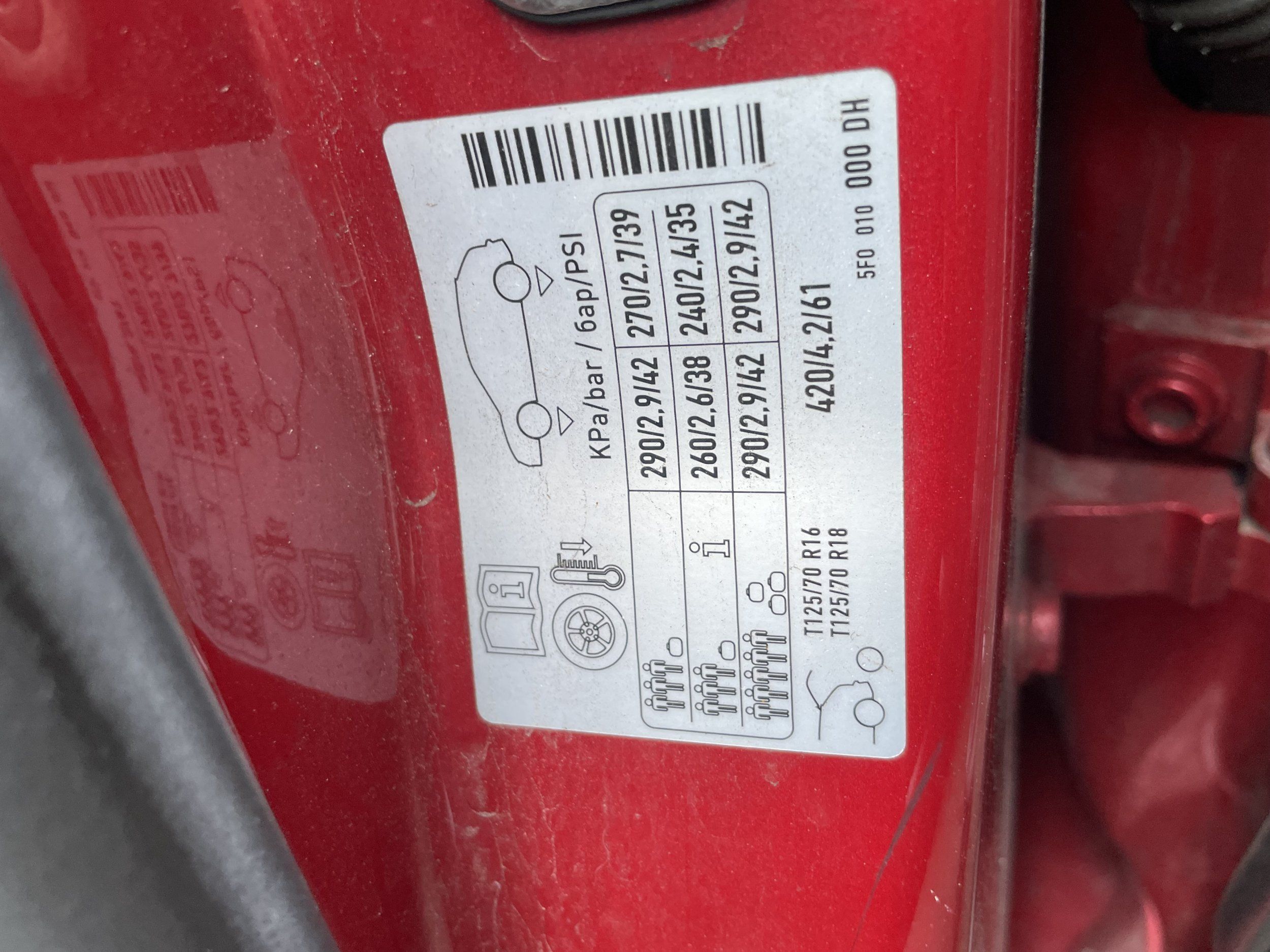

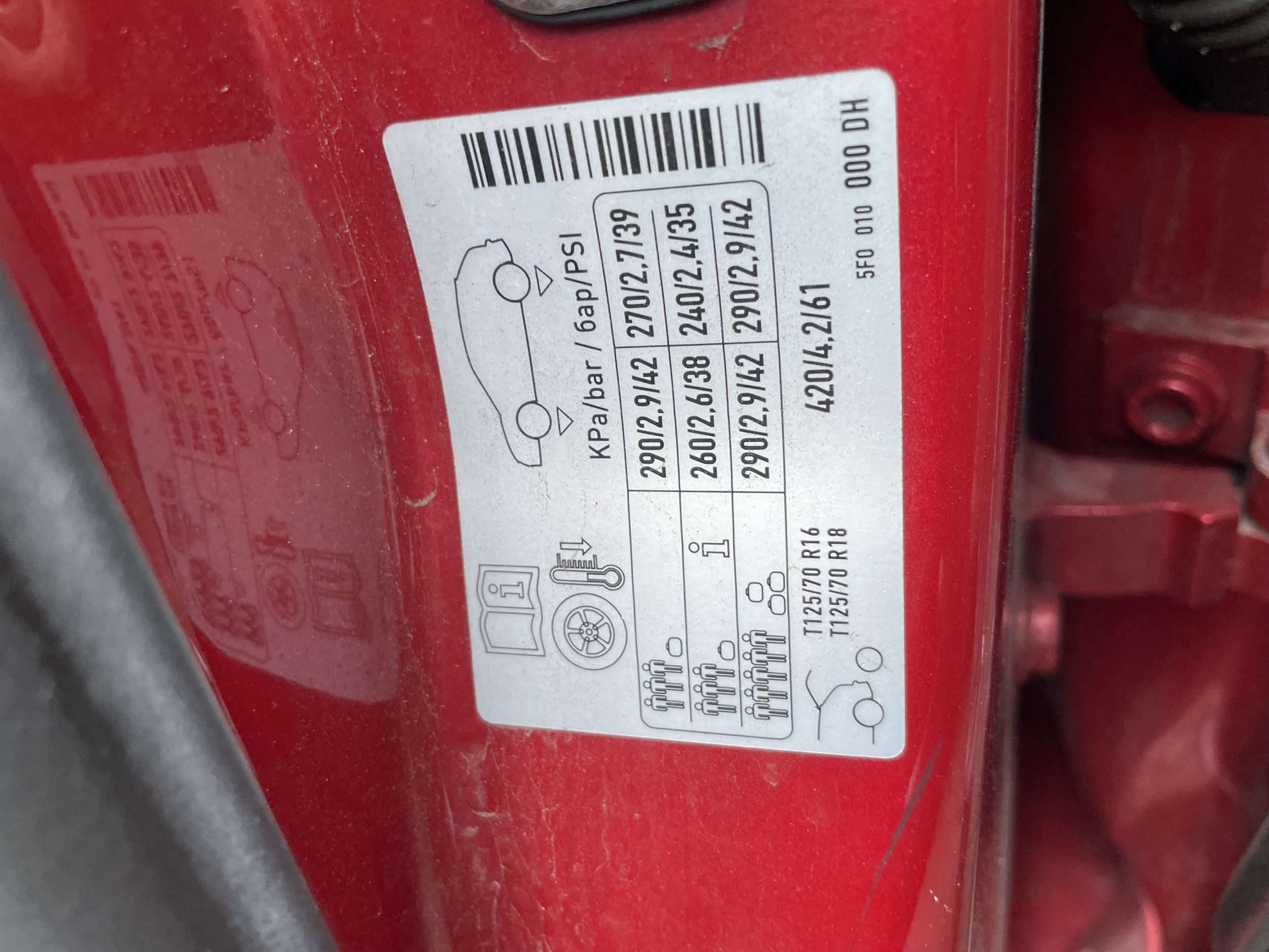

So I figured I'd check my tyre pressures today whilst on dinner at work, so naturally I checked the tyre pressure sticker on the passenger door, I will give the spec of the car for context, 2019 Seat Leon ST Xcellence Lux 2.0TSI DSG 190ps, this car comes with 225/45/17 tyres as standard, first of all I always thought low load and regular driving being set at 2.9 bar on the front and 2.7 bar on the back was always a little bit over the top and quite a lot higher than I expected, so I typically stuck with the 2.6 front and 2.4 back recommendation, I figured I'd try the 2.9 out to see if I preferred it or not, but then I noticed something my tyre size isn't actually listed here and from memory it doesn't list tyre pressures in the owners manual it simply say how to check and fill the tyre and to consult the sticker, but again the tyre isn't listed here which I find peculiar, so before I drive home and ruin a perfectly good set of tyres or kill them outright, are we in agreement that 2.9 bar and 2.7 bar is pretty high especially for 17" wheels?
-edit I think I've answered my own question, the tyre pressures stated below are for a spare wheel? am I correct? if so again 2.9 bar seems high to me.
So I figured I'd check my tyre pressures today whilst on dinner at work, so naturally I checked the tyre pressure sticker on the passenger door, I will give the spec of the car for context, 2019 Seat Leon ST Xcellence Lux 2.0TSI DSG 190ps, this car comes with 225/45/17 tyres as standard, first of all I always thought low load and regular driving being set at 2.9 bar on the front and 2.7 bar on the back was always a little bit over the top and quite a lot higher than I expected, so I typically stuck with the 2.6 front and 2.4 back recommendation, I figured I'd try the 2.9 out to see if I preferred it or not, but then I noticed something my tyre size isn't actually listed here and from memory it doesn't list tyre pressures in the owners manual it simply say how to check and fill the tyre and to consult the sticker, but again the tyre isn't listed here which I find peculiar, so before I drive home and ruin a perfectly good set of tyres or kill them outright, are we in agreement that 2.9 bar and 2.7 bar is pretty high especially for 17" wheels? View attachment 52778
The seemingly high 2.9 front / 2.7 rear tyre pressures is to reduce rolling resistance so max mpg / min CO2 emissions can be achieved and I dare say that’s what Seat will have used for official mpg / emissions testing.
2.6 front and 2.4 rear will be the ‘comfort’ tyre pressure setting for up to three passengers and their luggage - the middle of the three sets of figures on your tyre pressure sticker. The ‘i’ alongside the settings indicates there’s additional information - or there should be - in the owner’s manual. Setting pressures at 2.6 / 2.4 as opposed to 2.9 / 2.7 shouldn’t be an issue (they’re published manufacturer’s figures after all) but will probably result in a small increase in fuel consumption and emissions.
-edit I think I've answered my own question, the tyre pressures stated below are for a spare wheel? am I correct? if so again 2.9 bar seems high to me. View attachment 52778
No - your spare is 4.2bar!
2.9/2.7 is your eco setting, and 2.6/2.4 'normal'
Older cars had a 'comfort' setting more like 2.2!
I mistyped mate, I meant to say "-edit I think I've answered my own question, the tyre sizes stated below are for a spare wheel? am I correct? if so again 2.9 bar seems high to me"
Yeah I saw the 2.2 bar in google images and thought wow!
Just surprising how much difference is in this model.
I typically use 2.6/2.4 which you are correct states comfort setting in my manual, but I figured I'd give 2.9/2.7 a go since I've had it remapped just to see if there is much difference.
