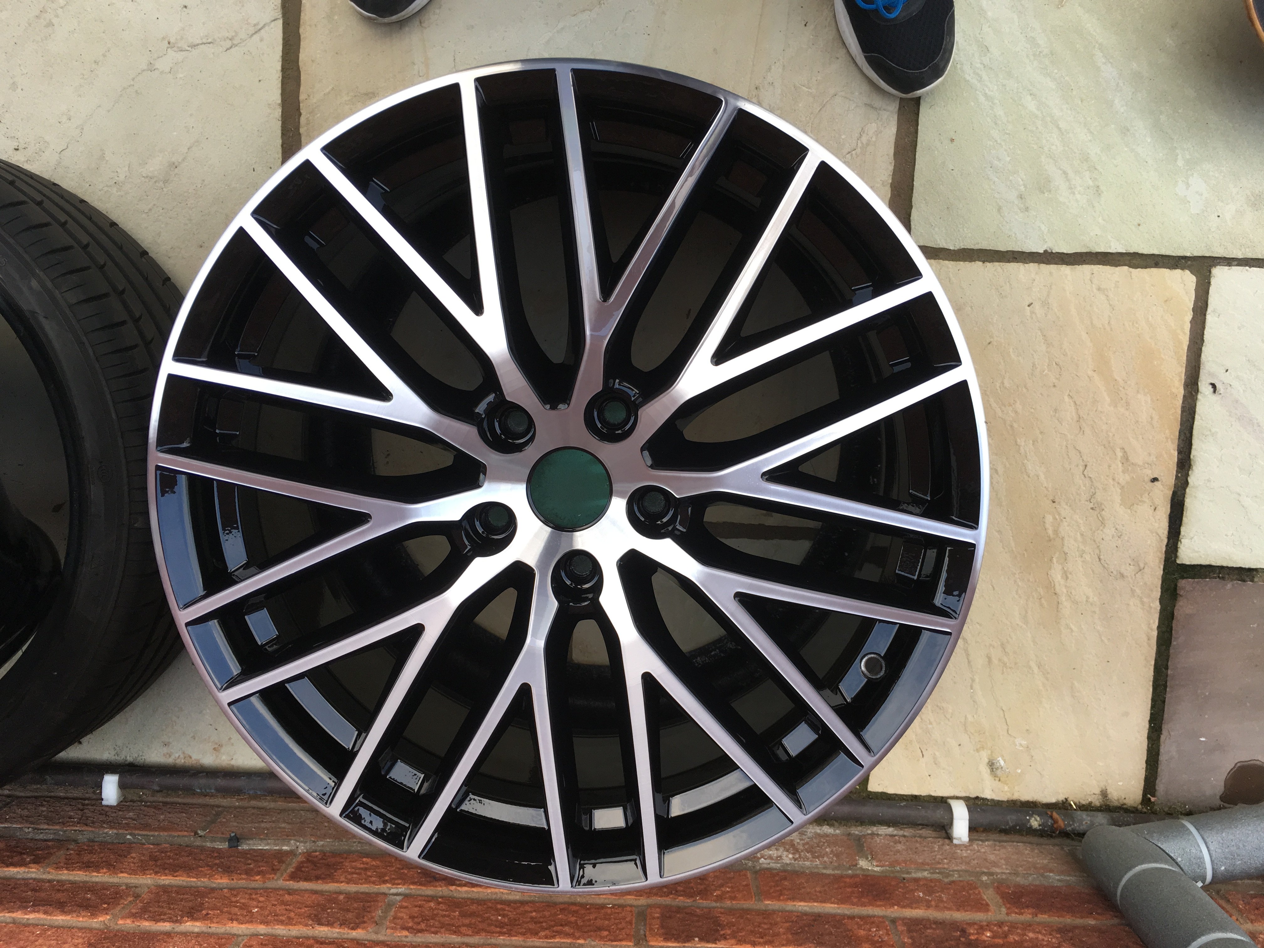

Thank you for clarifying - right time to get the new tyres on
Looking tidy
