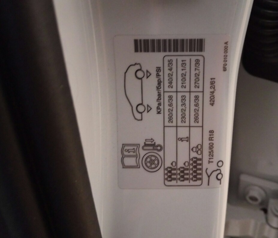

Hi all,
I found the label for tyre pressures, but what makes me confuse is that a label of "as I assume" lower temperature tyre pressure seems to be less pressure than summer!
As I remember from physics classes, air volume increases with higher temperatures and decreases with lower temperatures.
So then what is supposed, to have higher air pressure in winter and less pressure in summer.
Please guys correct my info.

The pressures shown as 33 psi front and 33 psi rear are the "comfort" settings for medium load (& will increase fuel consumption slightly)
The pressures shown as 38 psi front and 35 psi rear are the "normal" settings for medium load
The pressures shown as 38 psi front and 39 psi rear are the "normal" settings for full load
All of which should be inflated on cold tyres

I think you meant 33psi in front 31psi in the rear for the "comfort" mode.
So which one you think is the best for the car in general (comfort or normal)?

Tyre pressure is a personal thing - I tend to find the sweet spot by trial and error based on the following factors:
- manufacturer specifications (right value will usually be between their minimum and maximum)
- body roll (under inflated tires roll more, over inflated tires grip less)
- tire wear (under inflated tires wear the edges more, over inflated tires wear the center more)
All these are personal and there is not one value that fits all - the values on the sticker are references.
Some people that drive only around the city might favour a less inflated tire, since it masks bad roads, but someone who enjoys performance or does long trips where economy matters might go more towards a more inflated tire.

Take it this is for the 17 and 18 inch Ibiza rims? Me personally I found 36/34PSI 'like Goldilocks' just right...on my 215/40 R17 tyres...You can start with the 38/35 and deflate as necesarily. This is assuming like me you have the handheld pressure gauge.

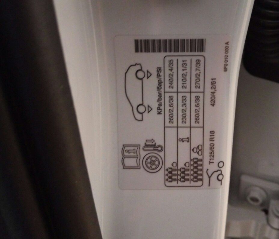

Hey, is that the front right door? I’m still looking for my tyre pressure sticker... Thanks,
