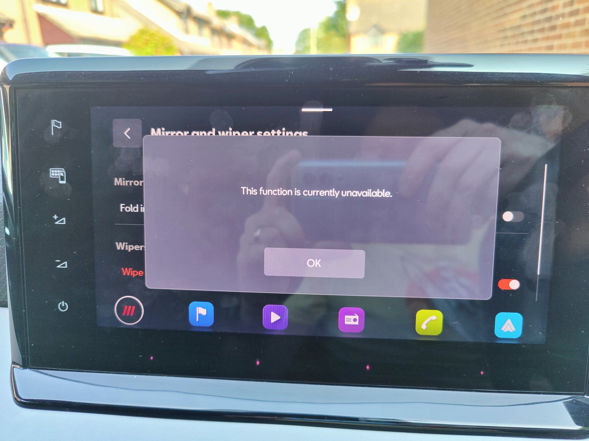

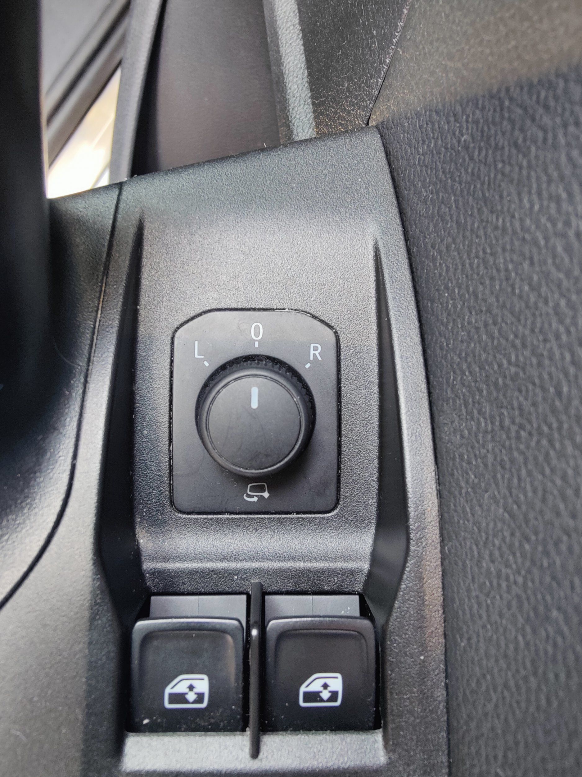

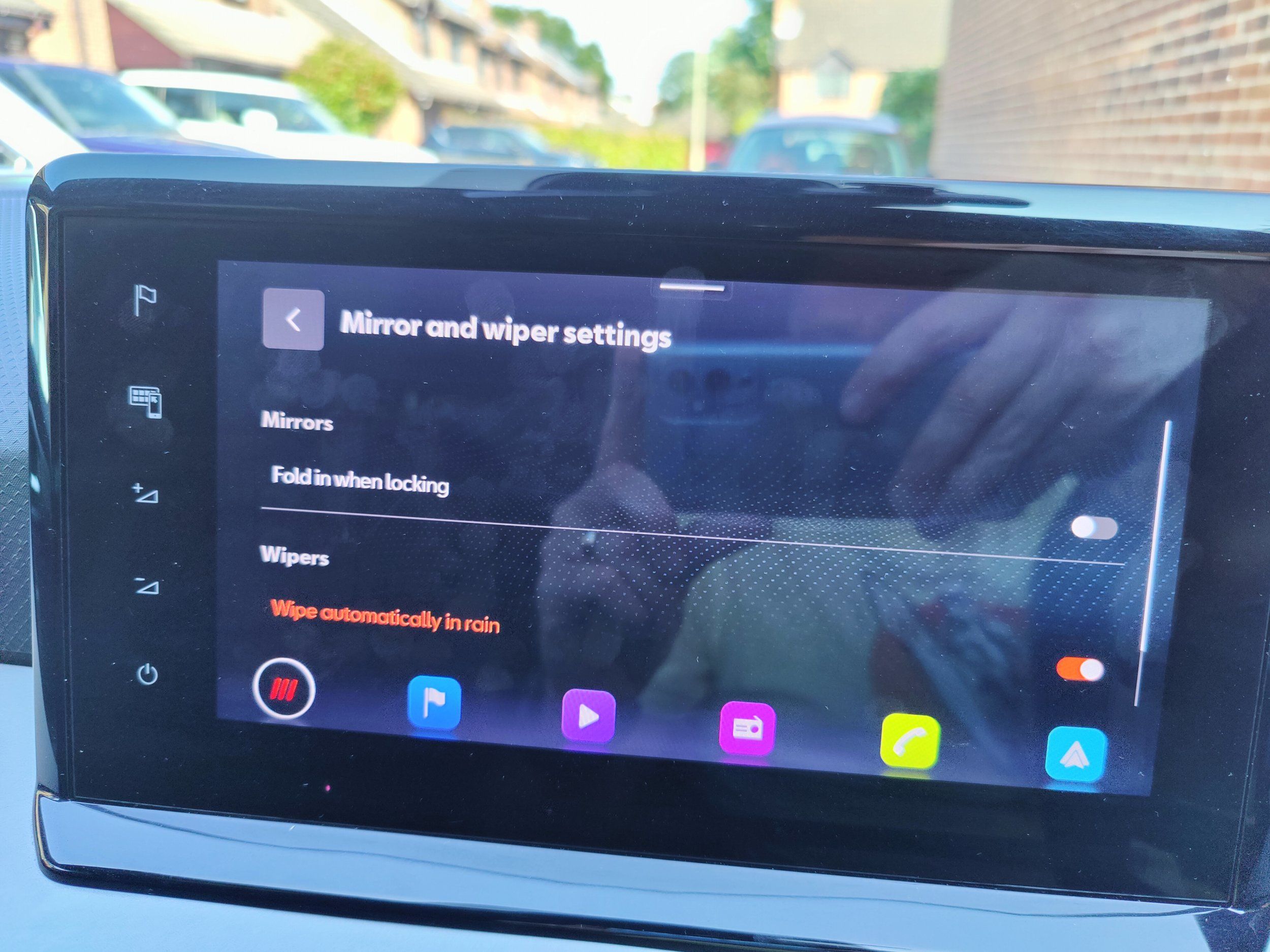

I have a 2024 UK-spec Ibiza mk6 in Xcellence trim. The car has power folding mirrors, and in the infotainment system settings there is an option to fold the mirrors in automatically when locking the car. However no matter what I try I can't get this option to enable. I just get an error whenever I try that says "The function is currently unavailable". I am able to fold in/out the mirrors using the knob on the drivers door so the folding action does work, I just cant seem to get this option to enable. Anybody else have this issue and/or know how I fix it?

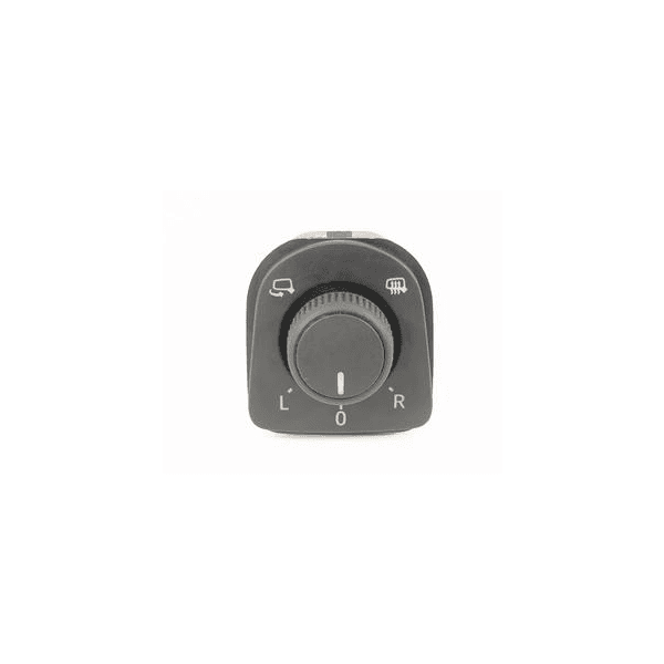

Do you have the knob on the driver side with the mirror icon? It should look something like this? If you take a picture and show us what that is currently set to, we might be able to help further.

I did try the window button hold as you suggested, but unfortunately nothing happens and the function still cant be enabled. My issue seems to present differently to that mentioned in similar posts, in that in those cases the function can still be enabled/disabled in infotainment (where such an option exists), but just doesn't work. In my case I can't even enable the setting to fold the mirrors on lock, so it's kind of expected that they then won't, whether automatically or with the manual hold of the key fob.

I have two ideas. The first is to force restart the multimedia system or reset the multimedia system to factory settings and test it. Otherwise, read out the error log.
How do I restart and reset the multimedia system? Where do I find the error log?
Press and hold the radio power button until the system has restarted. Read the error log with a reputable diagnostic tester
