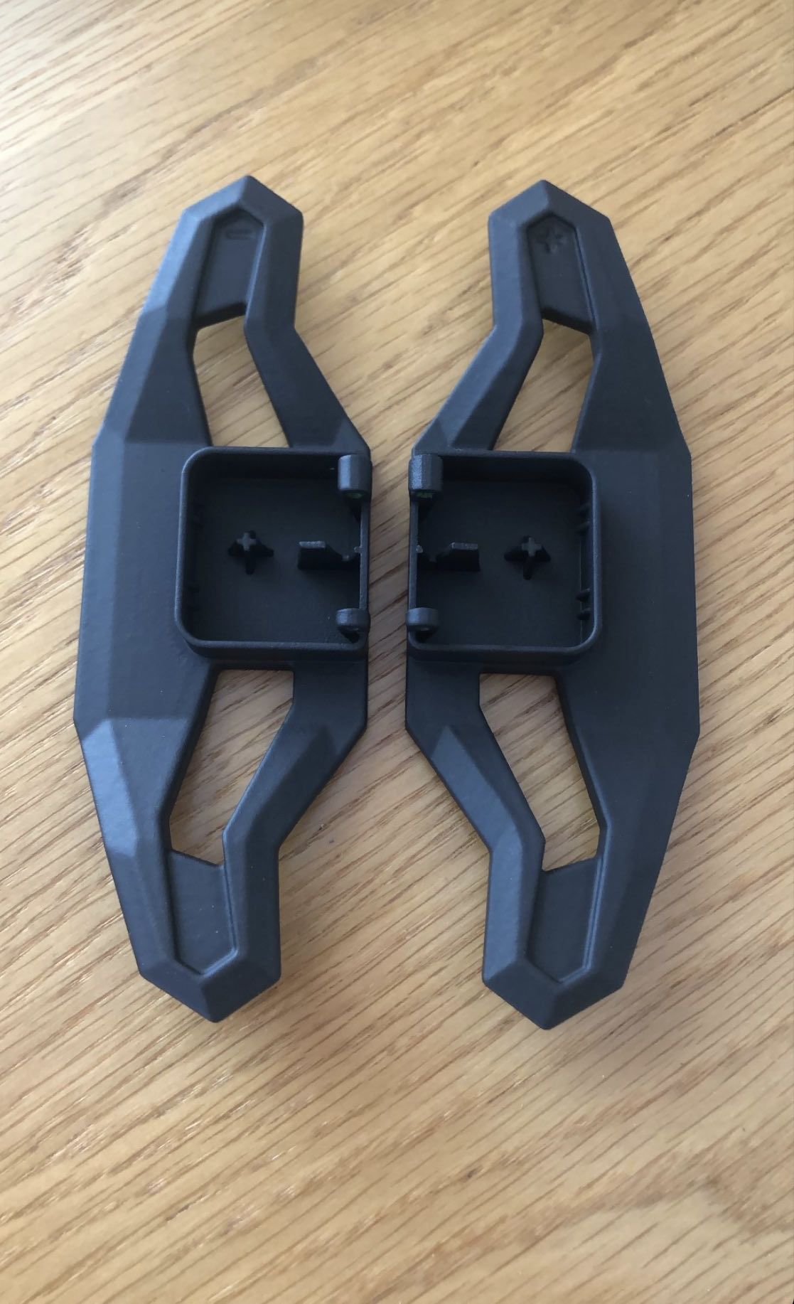

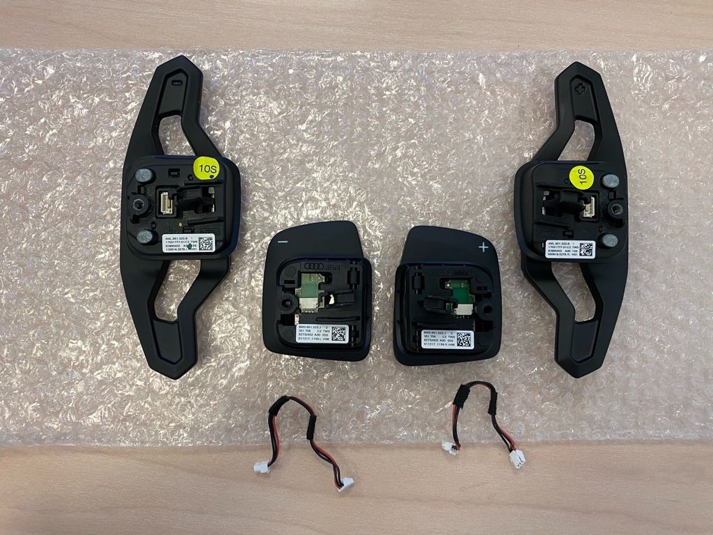

Here are some photos I found of the paddles in question

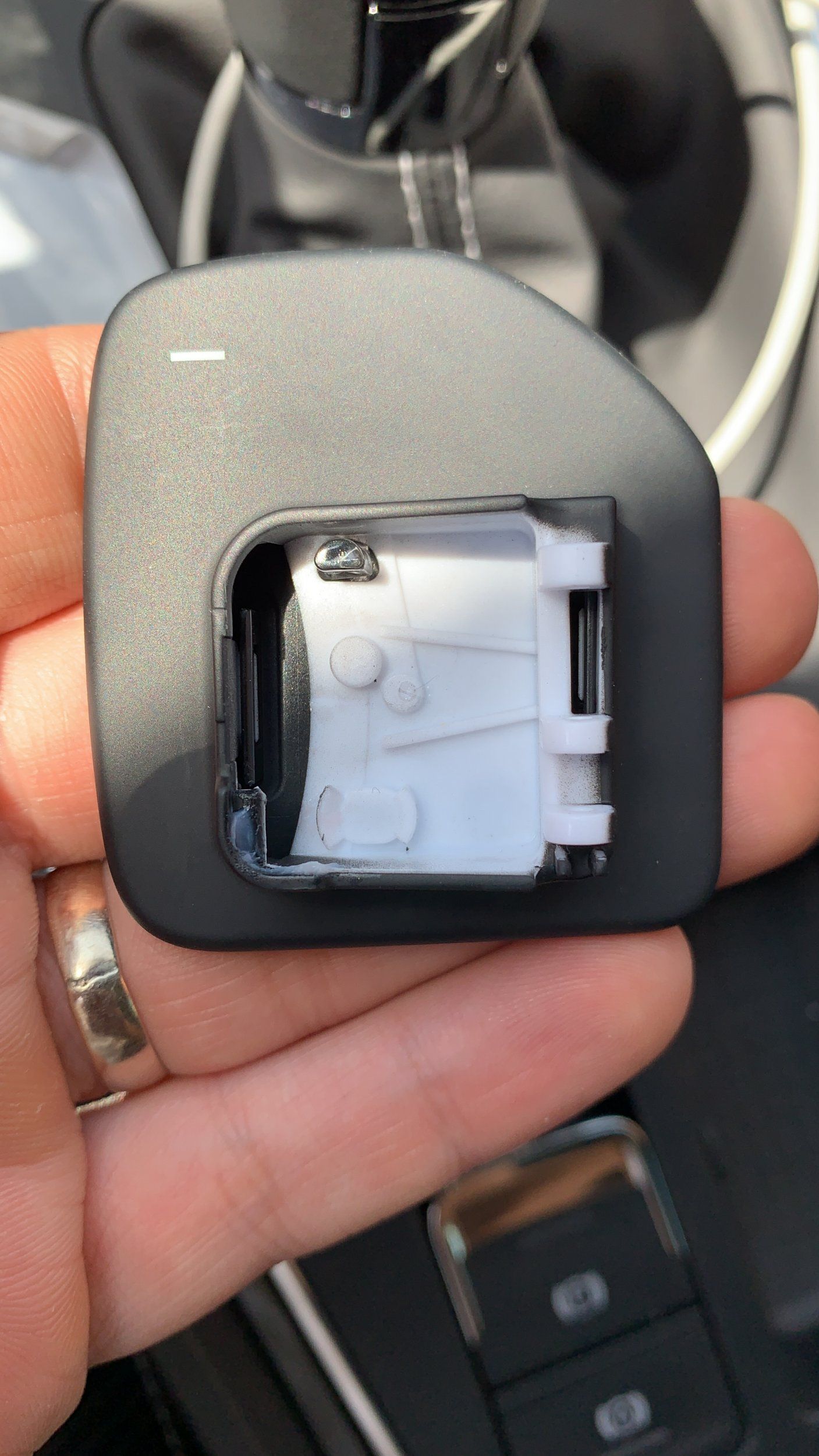

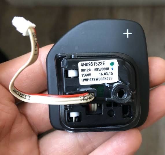

And here are photos of paddles found on a Cupra 290
(I don't remember where i got the first pic from, sorry for missing credits but the second pic is my own paddle)

I've lined the paddles up in Photoshop, and the bases are a bit similar but not identical, so they will indeed not fit. Not sure if there's a way to DIY this paddle onto the existing mechanism though

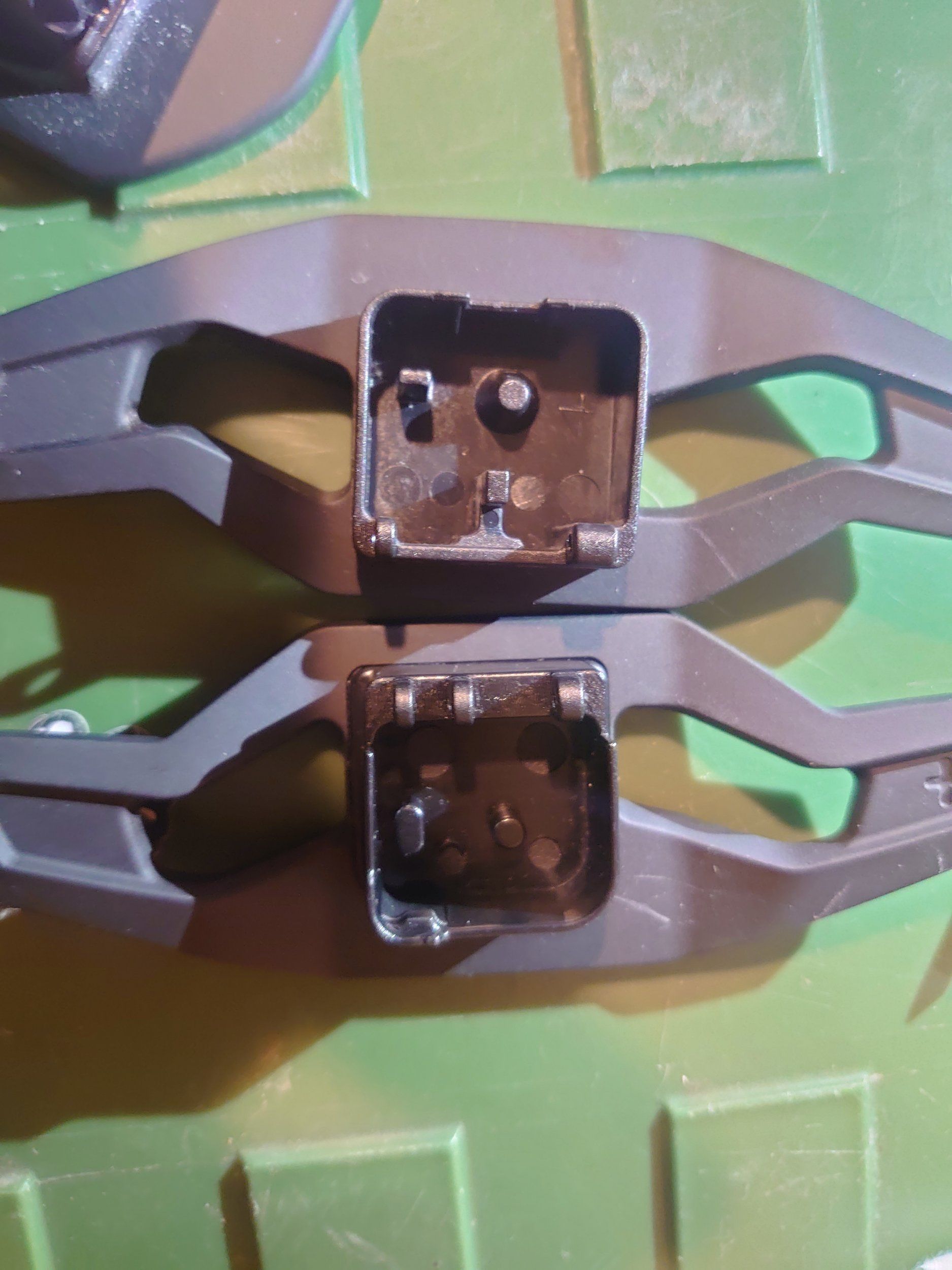

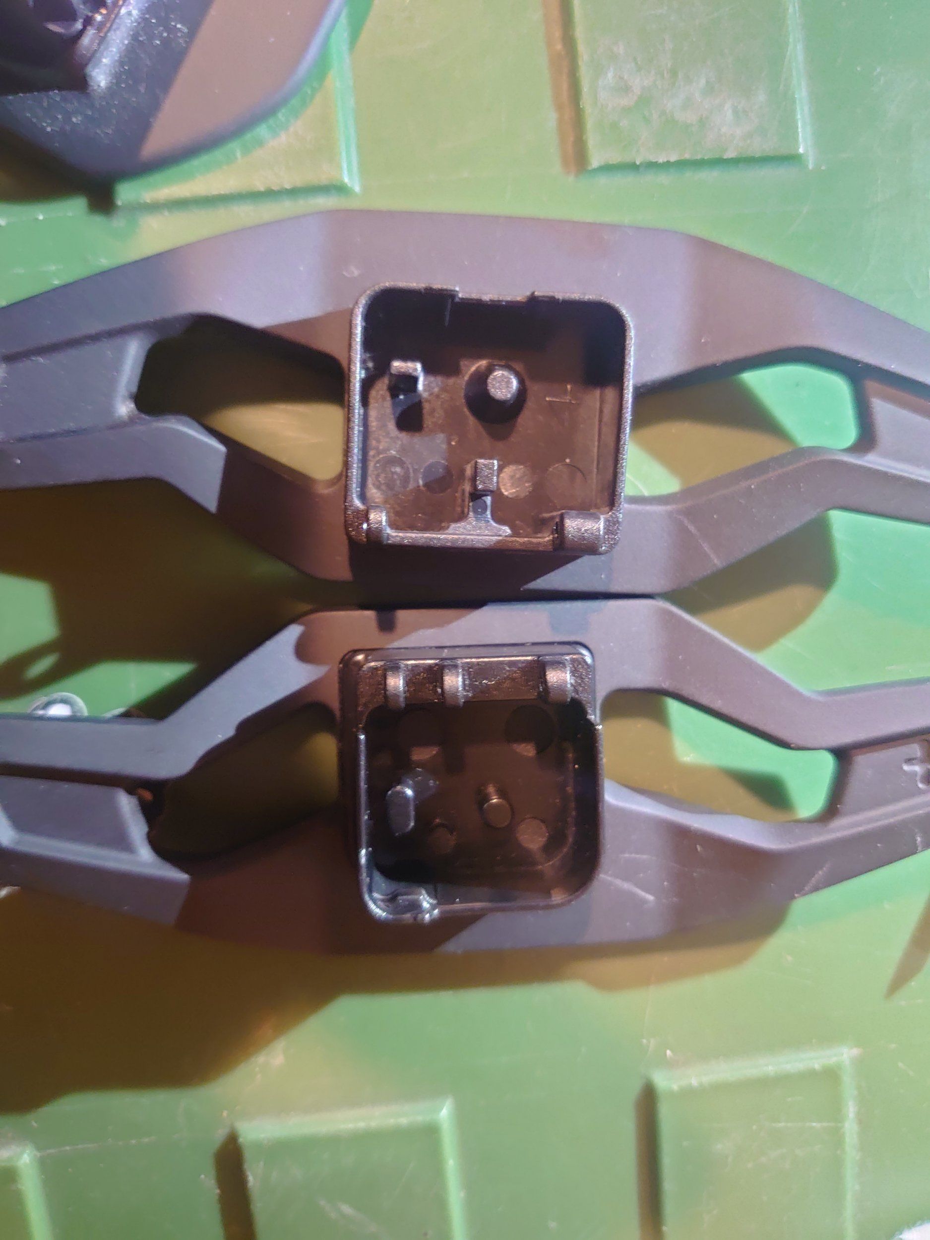

Good news and bad news.
The good news is .. it would fit.
The bad news is: i got 2 different paddles... One has the wrong type of hinge. The top one is wrong, bottom one is right.
And then there's an additional challenge: the pin isn't as easy to get out as it should be. There's only 1 hole, instead of 2, so you can't push it through. I've read some posts about people cutting a small notch into the pin/axle so they could wiggle it out.

I'll try this as soon as the replacement paddle has arrived.
By the way, I'm pretty happy about the quality and feel of the Urus paddles. They feel kind of heavy, cold and smooth.
Check this topic, we're not the only one with this issue ;-)

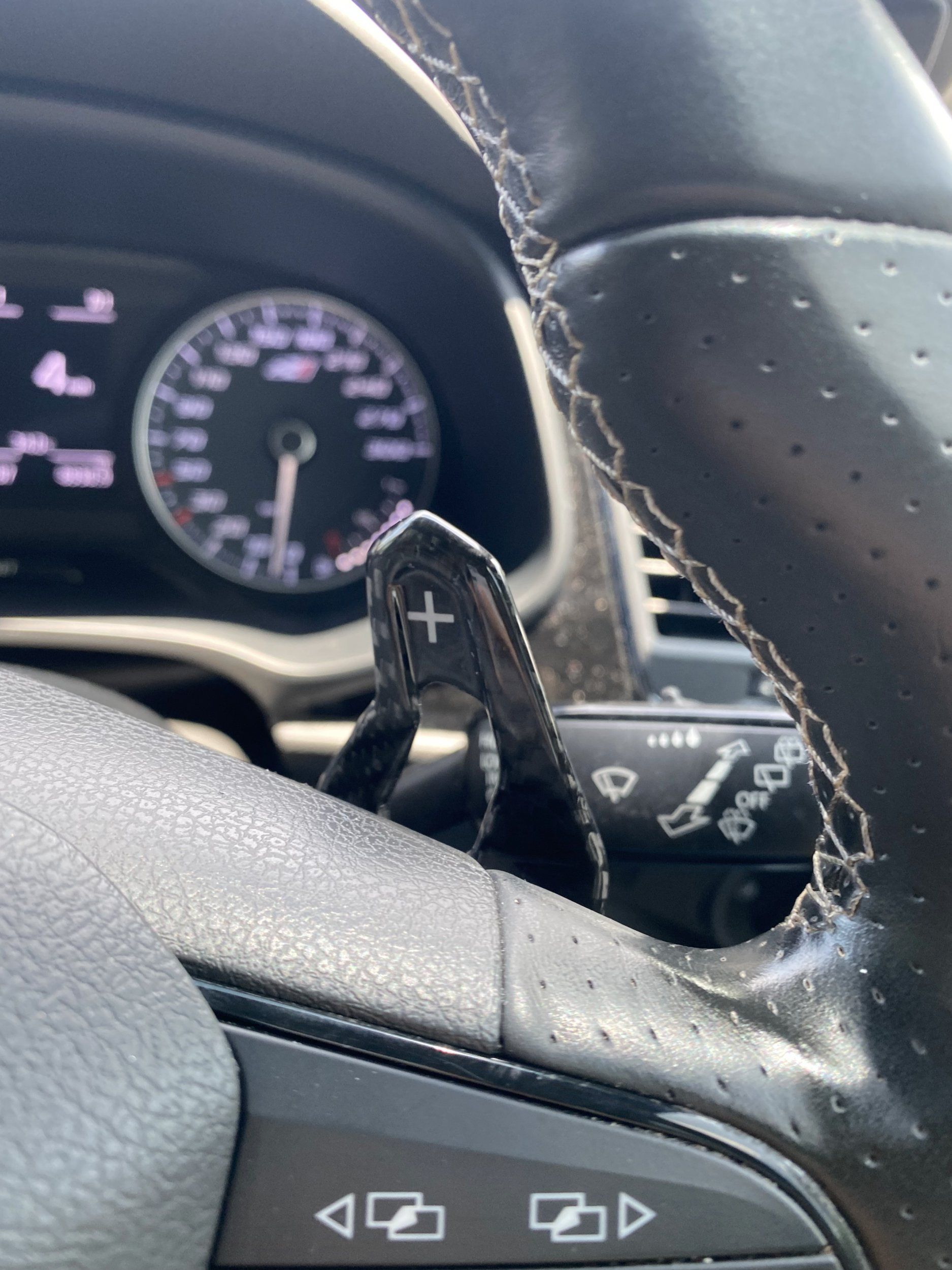

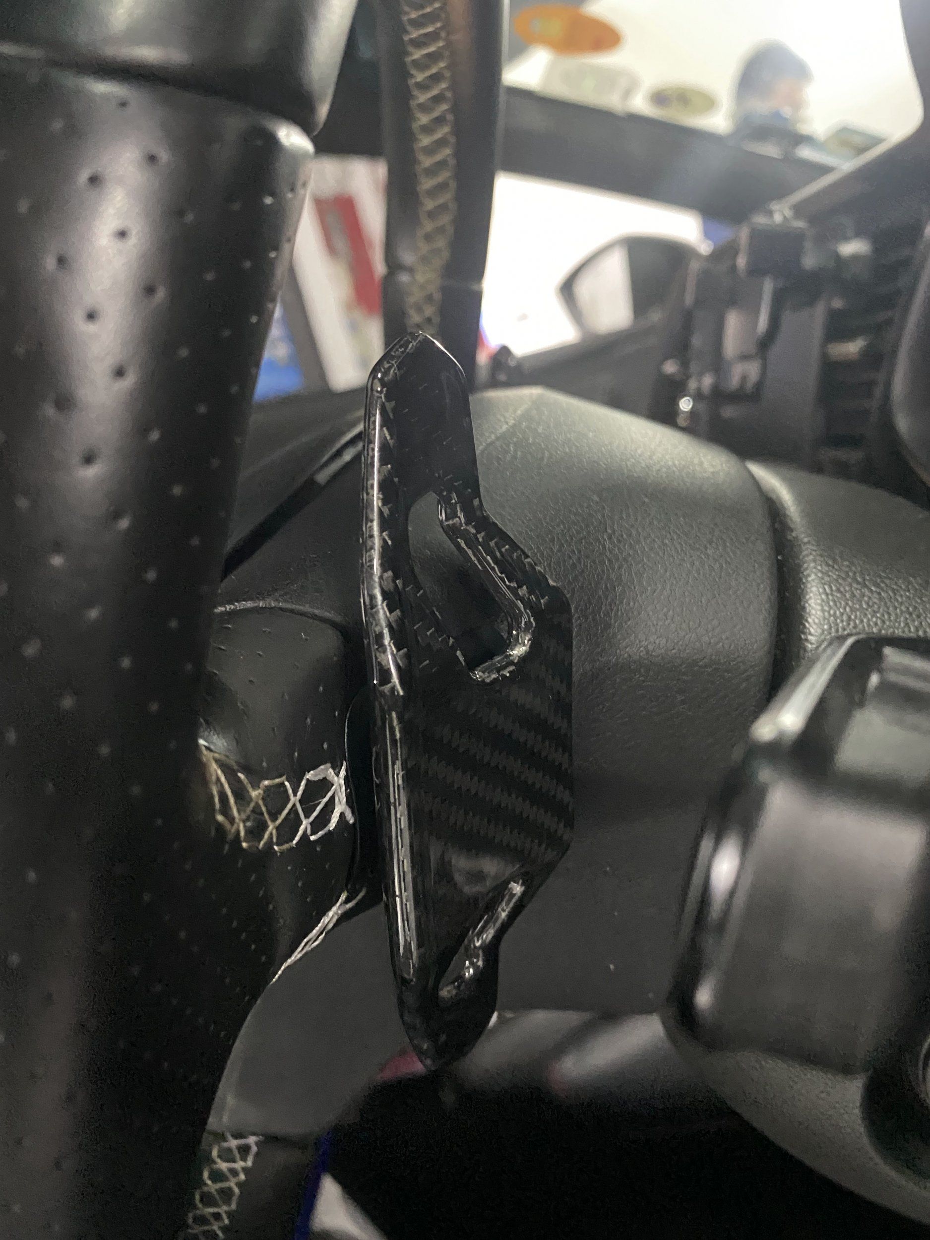

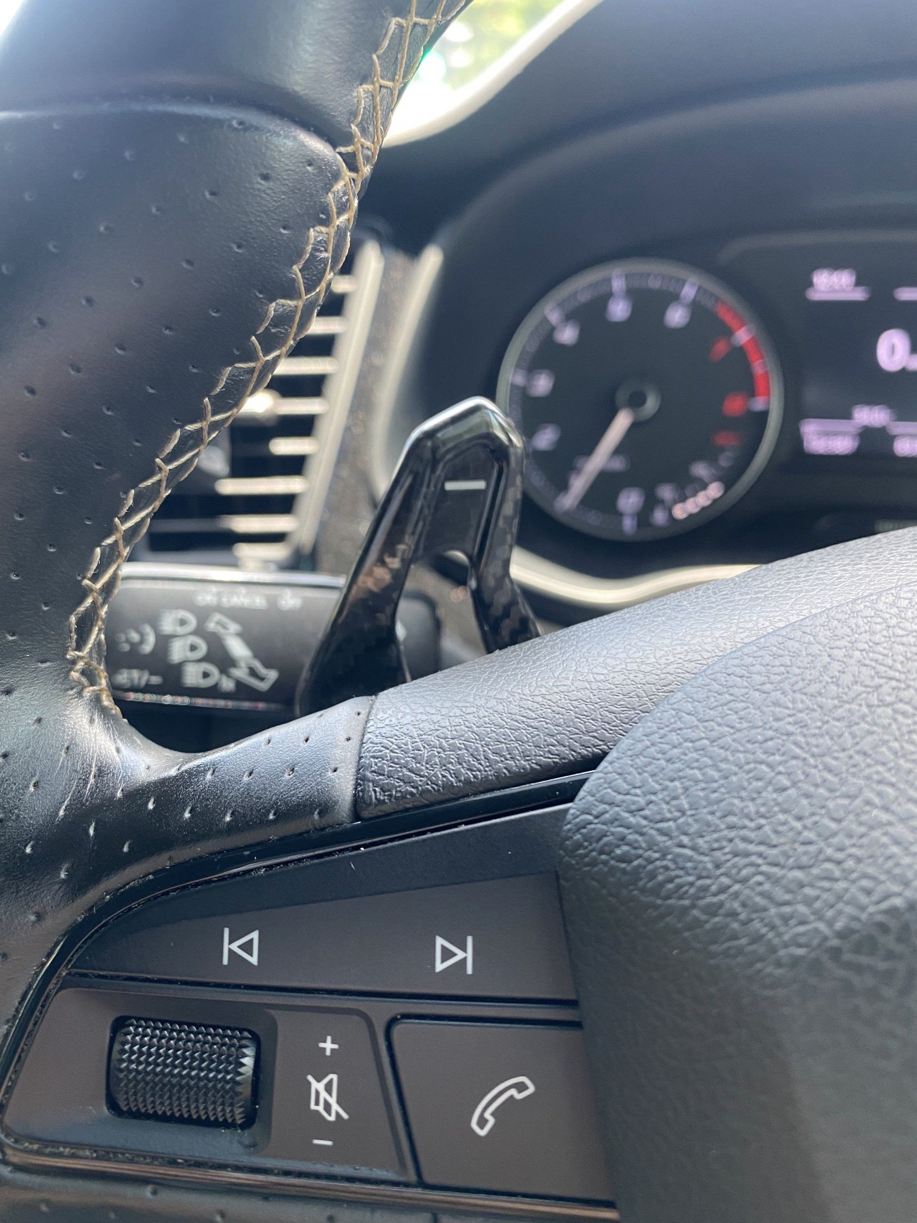

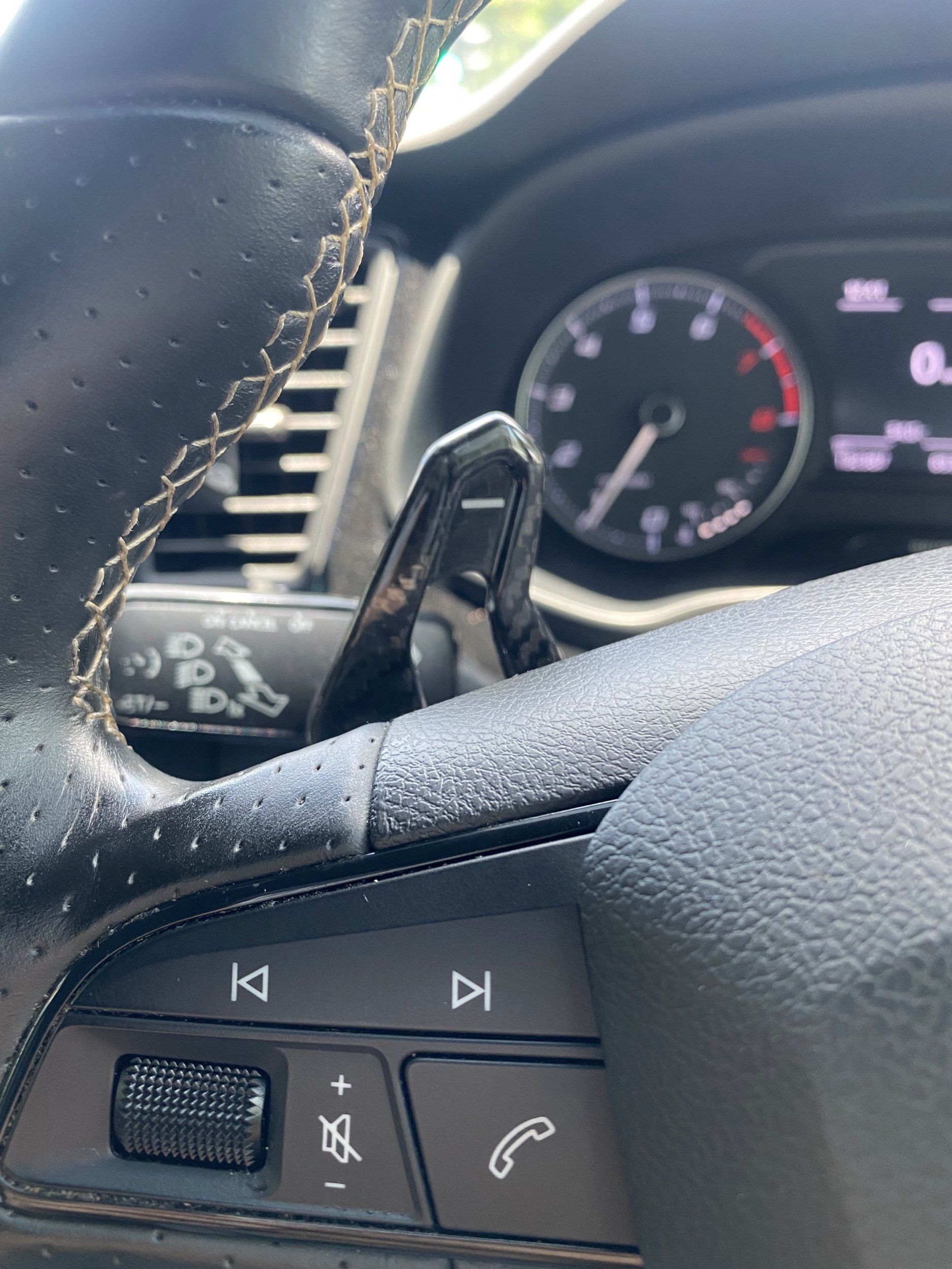

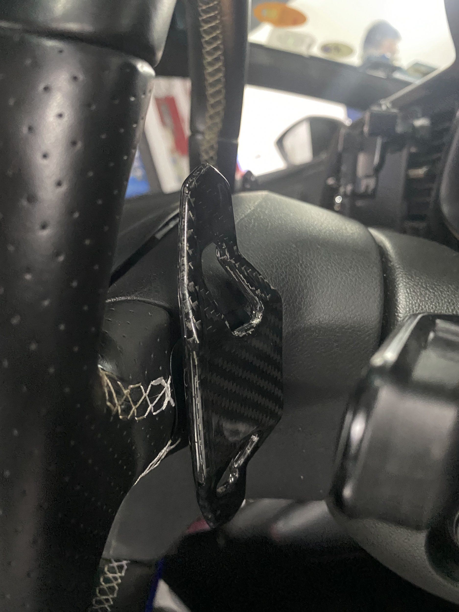

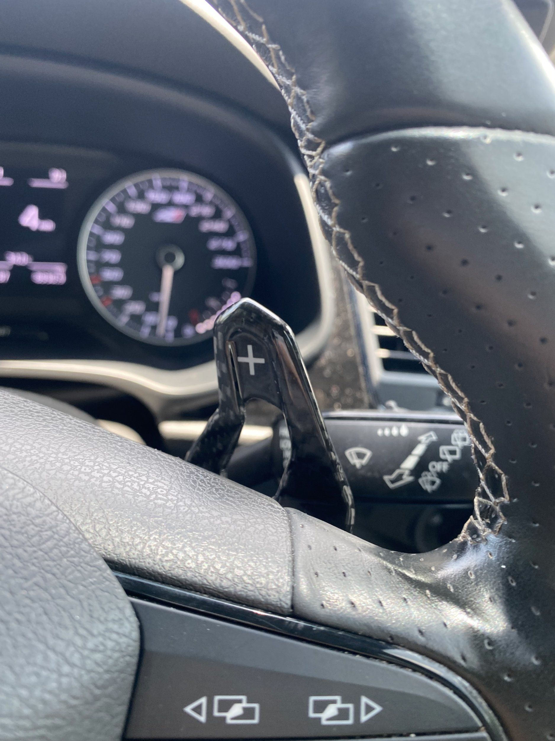

Here you go!
Select Style C (Correction) when buying the aliexpress ones. I went for the carbon ones.
