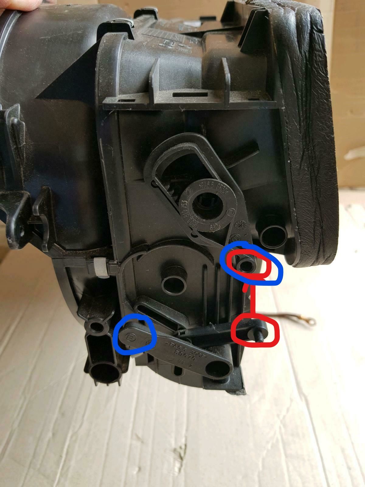

Bit of a necro however, I've been trying to figure it out for three days and it is driving me mad :banghead2

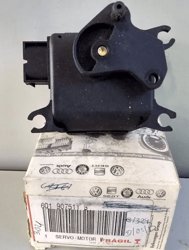

If anyone who has replaced the lever type variant used on Climatronic equipped cars recalls:
The V71 motor in this case looks pretty much like this:
While the flap assembly, that is moved by this motor looks like this:
The purpose of the hole in the motor plate is obvious however, things become much less obvious when it comes to the lug in the motor plate...
Most of the confusion is cause by the fact, that the illustration in the official repair guide (Erwin) appears to be partially mirrored.
The hole displayed in the illustration is not only way too large but also in the wrong position to allow sufficient movement for the motor plate. The smaller hole (at roughly two o'clock in the picture) is closer to the right size however, the whole structure for whatever reason, is inverted in the technical drawing...
The picture of the flap assembly is from a site selling salvage parts however, the one present in my car is identical for the mentioned parts.
To make matters even worse, Erwin / ELSA has no information whatsoever for Ibiza 6L when it comes down to the heating system...
Luckily, the same components are used e.g. in VW Polo and Skoda Fabia and some of the information could be scraped from there.
So the question is, which one is the right hole? :cheeky:
Ok so the red circles, the bottom arm that sticks out goes in to the back of the red one at the top circled.
Then the motor goes in to the blue ones circled.
Hmm...
I don't think the method you describe would be even possible.
If that would be the case, then there would be no way to attach the motor itself to drive the flap mechanism.
I found a russian guide which specifies a similar workflow (for a VW Polo) as the original service guide however, even that fails to show which one is the right hole :banghead2
https://www.drive2.ru/l/451673055572263305/
Sorry my bad it's been a while since I did this, the two red circles are where the motor goes in to.
