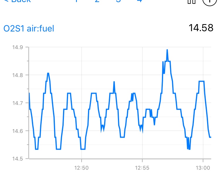

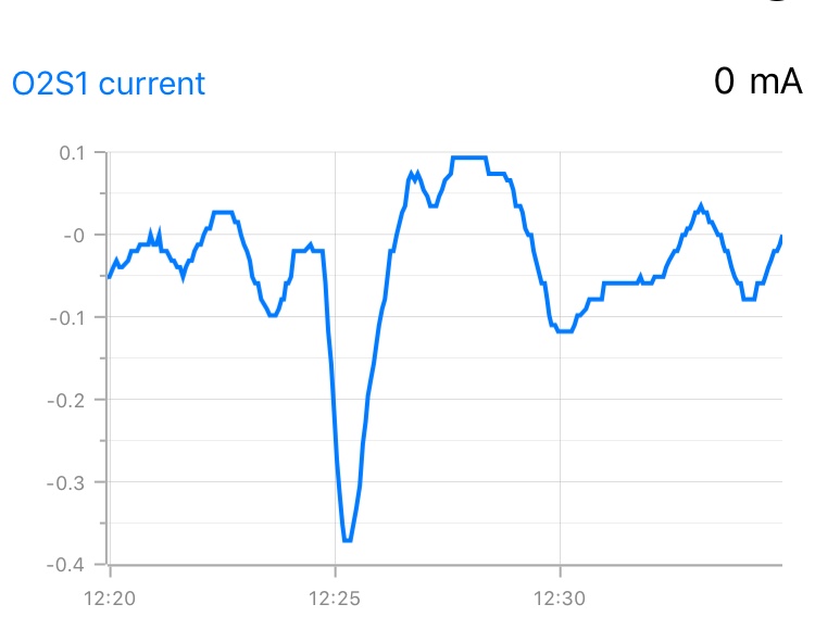

Im currently trying to get to the bottom of an issue with High long term fuel trims (+20% give or take) which is showing my car running extremely Lean, struggling with this as the A/F ratio looks ok and o2 looks ok...

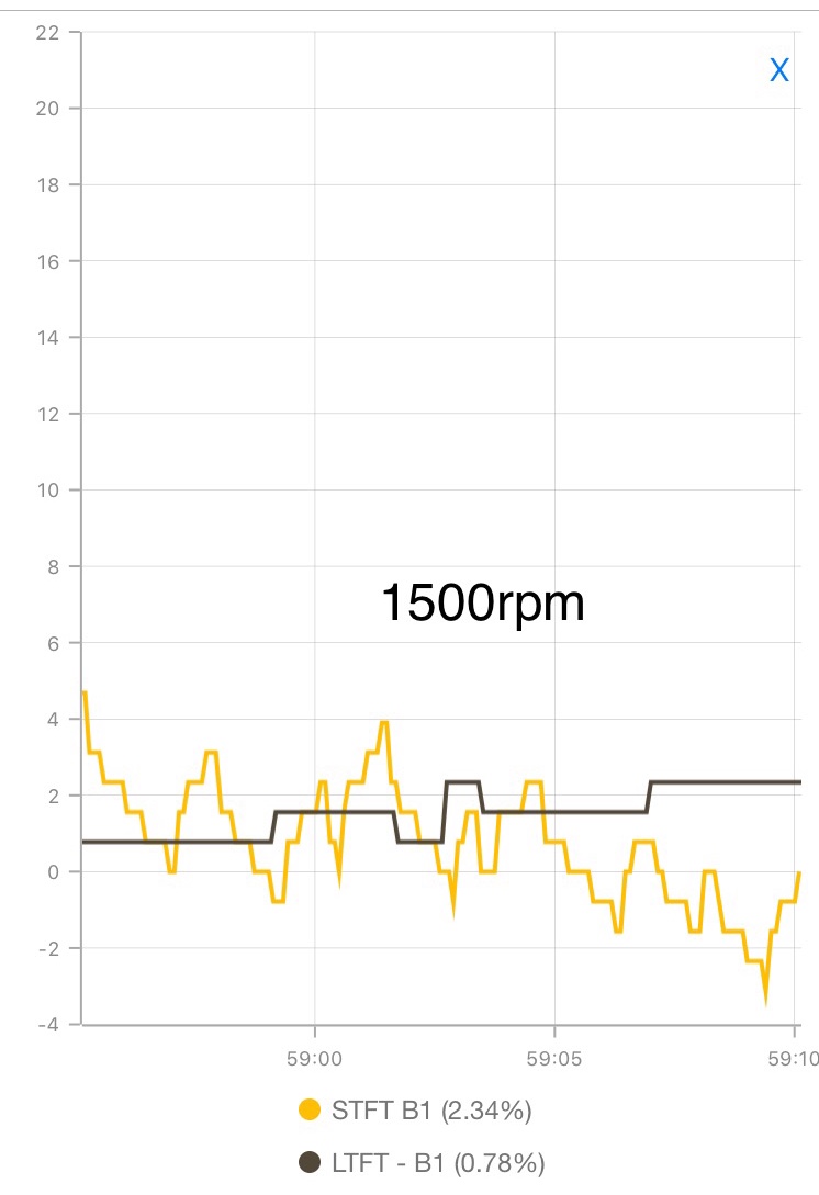

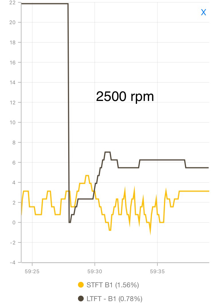

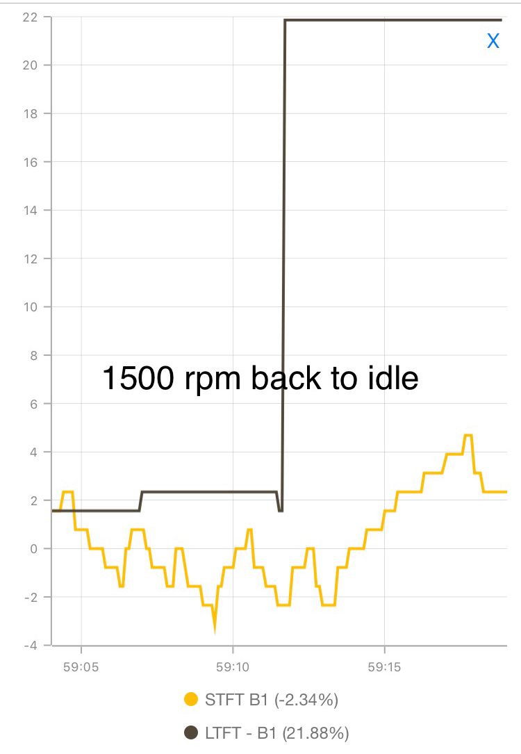

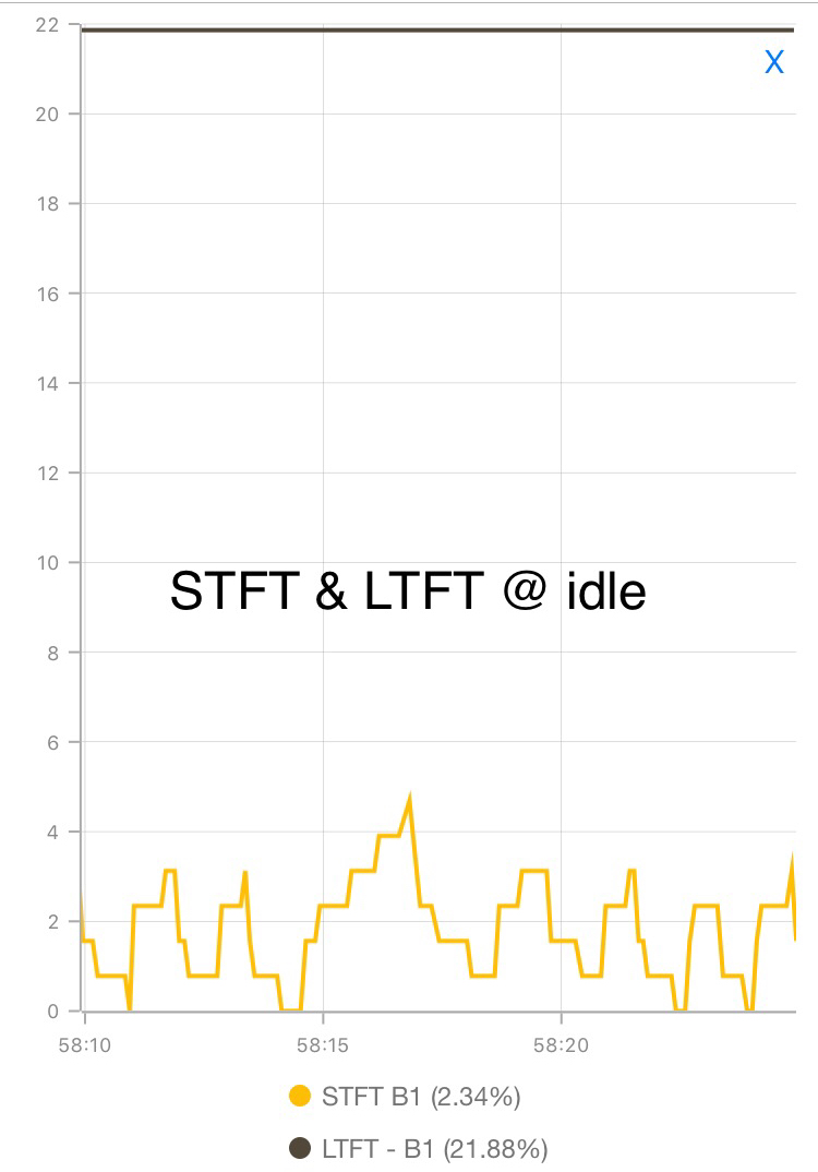

  • High LTFT on idle of 25%
  • When revved at 1500, 2500 the trims go back to normal
  • STFT are fine

  • MAF is fine
  • o2 sensor reading is bang on
  • Air fuel mix is nearly bang on

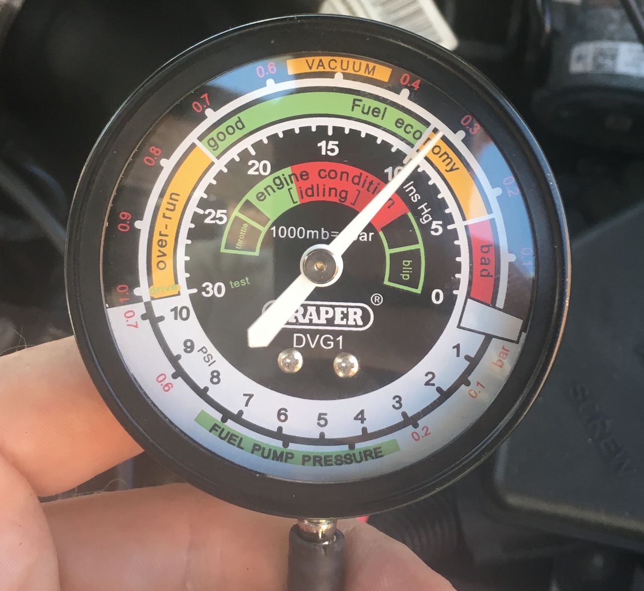

Ive just undertaken a Vacuum test and the results are worrying
At idle (pictured)
8-10 Hg fluttering between the 2
At 1500 rpm
Drops to 3 Hg, increases to 17Hg drops to 5 Hg then settles back to 8-10 Hg
At 2500 Rpm
Drops to 3 Hg, increases to 18 Hg, drops to 5 Hg then back to 8-10 when idling
3000 rpm is the same
Its at a garage for further diagnostics tomorrow but i want to arm with as much information to shorten lead time before its rectified as much as possible
