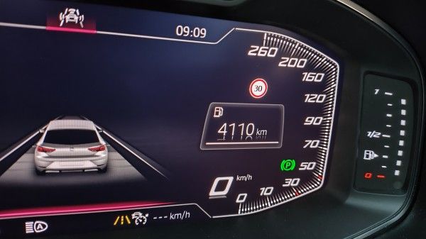

I have just had a virtual cockpit fitted to a 2017 Leon, and have a issue with the fuel gauge, and range seems to be slightly out.
With the old cluster, the fuel level used to drop in segments and then the single segment used to turn red when the low fuel indicator came on.
Now the segments drop until I get to 2 segments remaining, it then drops straight to a single red segment when the low fuel indicators comes on

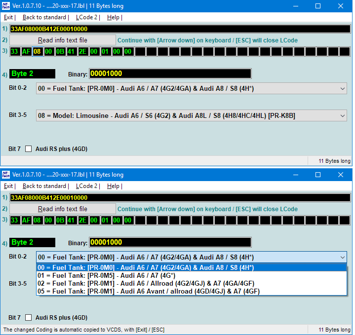

Using VCDS I can see Controller 17 Byte 2 has 8 choices for fuel tank type. Mine was set to 2 and I have now tried setting to 3 instead.
Does anyone know what the 8 different choices refer too?
I am hoping to match the capacity of my fuel tank (2.0TDI 150BHP) with one of the choices if possible, failing that I guess the hard way is to try each one in turn.

I haven’t scanned the car for a while so had a quick check:
Bit 0-2: 00 Tank Characteristic Curve, Variant 1
Bit 3-6: 38 Vehicle Variant, Variant 7
2.0 TFSI Cupra ST 4Drive 300 ps (55 ltr petrol tank). So you can discount Variant 1.

It's shame that VCDS does not give labels to the Tank Type Byte 2, it just lists Variants 1 to 8 which tells you nothing.
The tank shows full and seems to drop OK as fuels is used, but it will only drop to 2 bars and then will drop to a single red bar.
This seems to me to indicate that the guage is not calibrated properly. I have seen this https://forum.obdeleven.com/thread/6098/fuel-level-sensor-reset
On checking it is at -12.8 which is the factory default.
I was hoping that there is a proceedure to calibrate the cockpit to the fuel sender, but have drawn a blank so far.

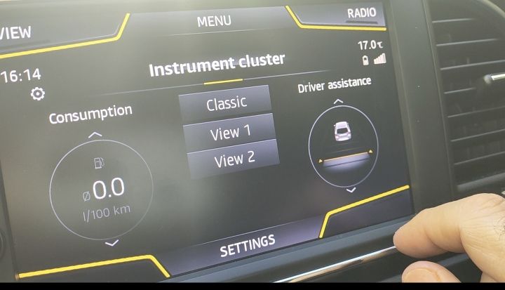

Hi @Damo H
I have a question for you, since we both made the same retrofit.
With the original VC, I had the option of choosing G-meter on the instrument cluster settings (from the infotainment screen), to place it at the center of the dials, and save this preference in one of the two (three on some units) available sub-views.
After I replaced it with Rev A unit, there's no G-meter among the options anymore. There's no problem on Sport HMI, I still can see the G-meter there, as before. Also, all of the other options are still available.
Just to be clear, I attached the photo of the related infotainment screen.
What is the case with your setup?
Was the G-meter option available before, is it still available?

I can't recall as never used it, and not had the car over 18 months now.
However I did have more views than in your screen. I had Classic and 3 personalised view options. I remember that as I had 3 of my own setups for different circumstances that I used regularly. So looks like something is up already.
Thanks for your response. I was hopeful to get some pointers 'cause there are not many people who did the same retrofit. Anyway, I'll keep looking :)
As for the personalised views, I asked around and it looks like the number of those is dependent on the infotainment unit version. Some lower models have two, others have three and an Auto setting also.
