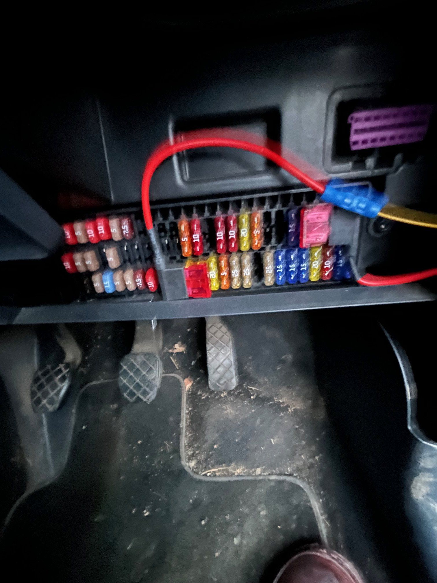

Hi, I own a 2014 ibiza 1.4 tsi fr act and I’m trying to locate the windscreen washer pump/ motor fuse.
Can anyone help please - I’ve tried online research bit I’m struggling.
The unusual wiring is due to my dashcam
Rear and front wipers are working.
Thanks for any advice !!
John
I had to replace this a couple of nights ago, it's fuse 23, 7.5 A, I didn't have a 7.5 so I put a 5A in and it works fine, I have ordered more fuses so I can replace it with the right one though.
