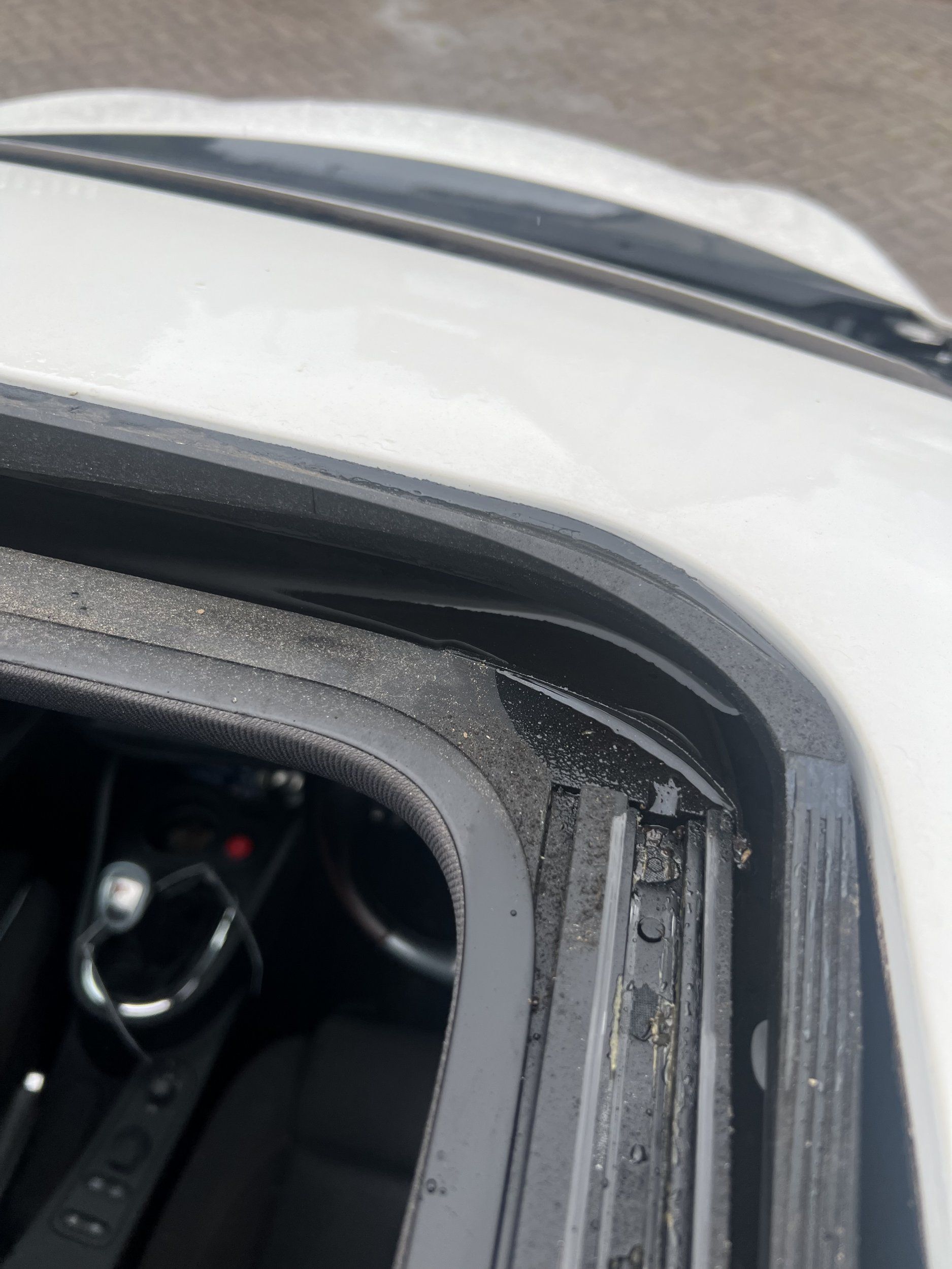

Hi guys had water run down my drivers side pillar next to windscreen into drivers footwell I took off the A pillar trim and pulled the drain tube off at the bottom and water came flying out everywhere lol.
Where does the drain tube actually come out is it under the wing or under the scuffle I had a look at the scuttle and can’t see it unless it’s right in the back ?
does anyone have a fix for this ?
Oh, those net curtain hanger things, like a flexible Bowden cable outer work well for poking
