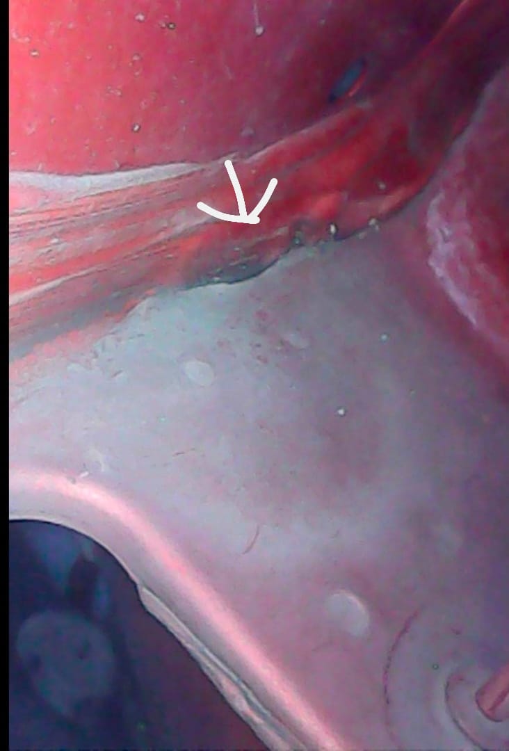

After pulling some trim off and using a boroscope, I can see the water is coming from the far front right hand side of the car, infront of the drivers door.

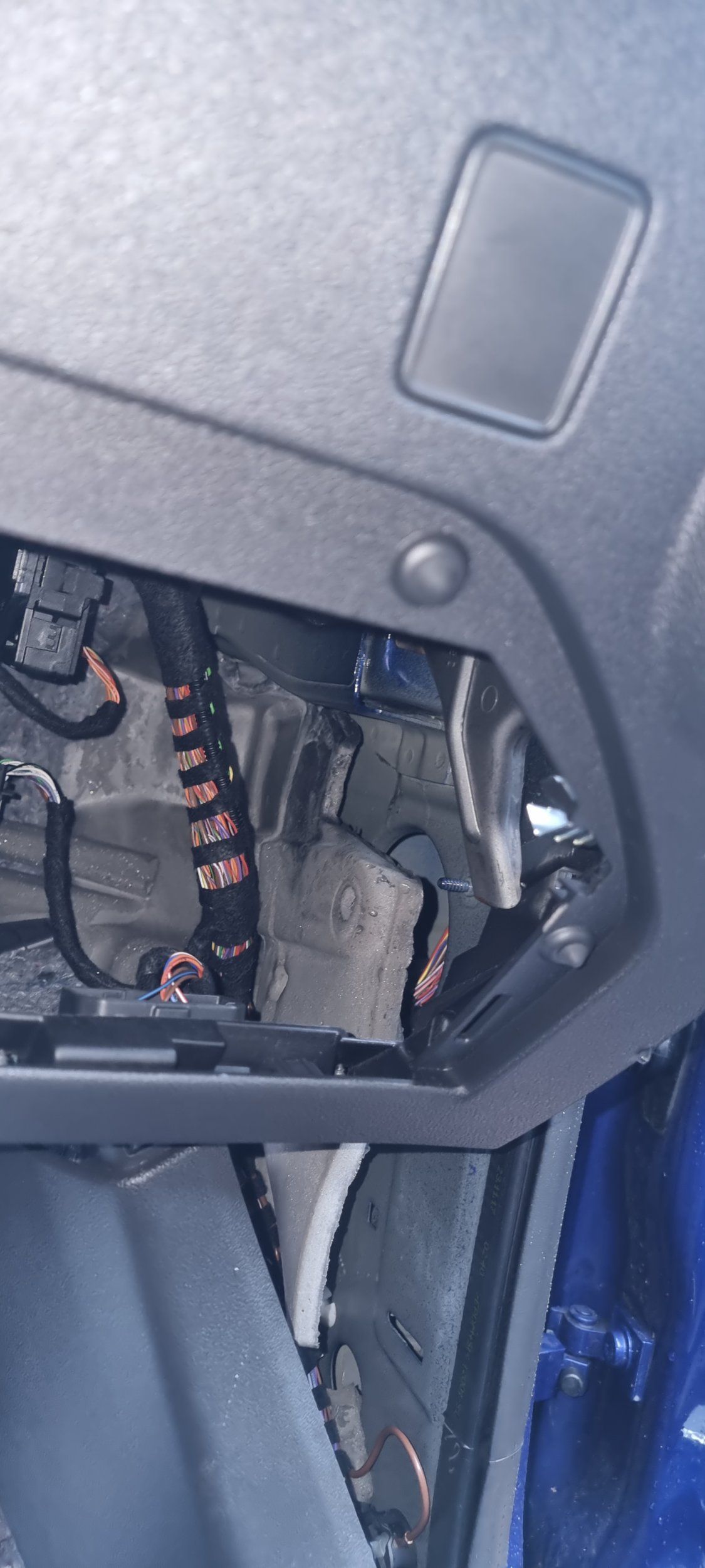

I've found where water is entering the cabin.

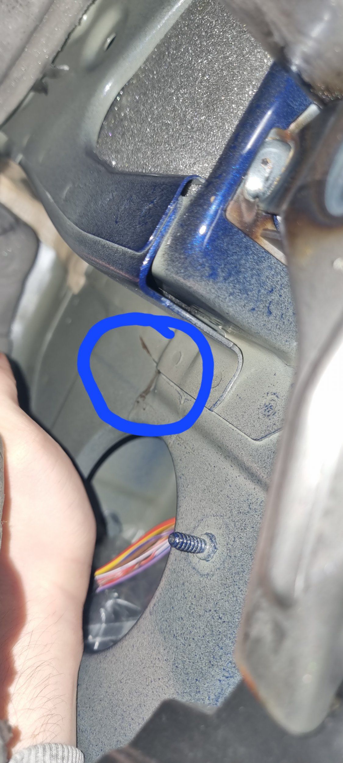

I've removed the storage box from below the lighting controls (where the right knee of the driver would be) and these photos were taken through that gap.
If I was to seal this, water would just find another way in, so I don't really know where to go from here

If that is a split you've circled I would be very tempted to just smother the area with some silicone, just to get you out of a hole, and when the spring/summer comes I would investigate further if it doesn't work.
Maybe when it's dryer get a watering can and add some sort of dye to the water and try and find the ingress.

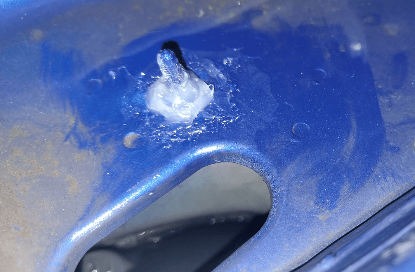

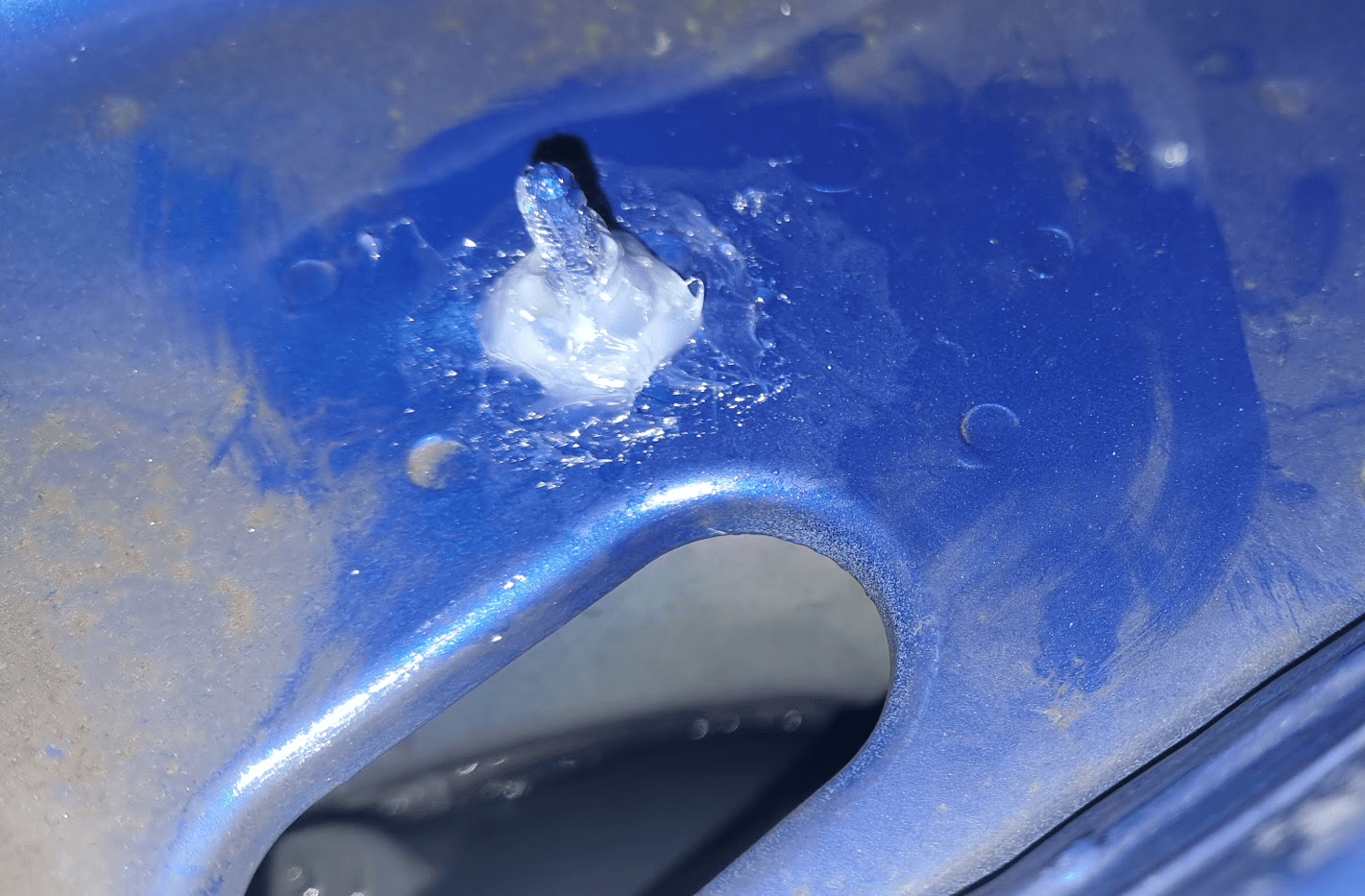

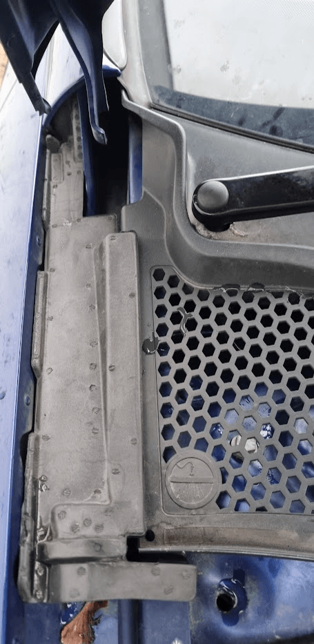

I THINK I've found and fixed it now. It seems to be a rivet causing the problem under the scuttle panel.

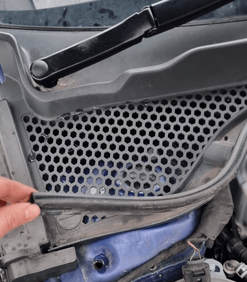

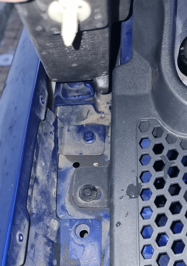

Once it finally stopped raining, I was able to find roughly where it was leaking by aiming a hose at specific parts of the car, starting as low as I could get and working my way up.

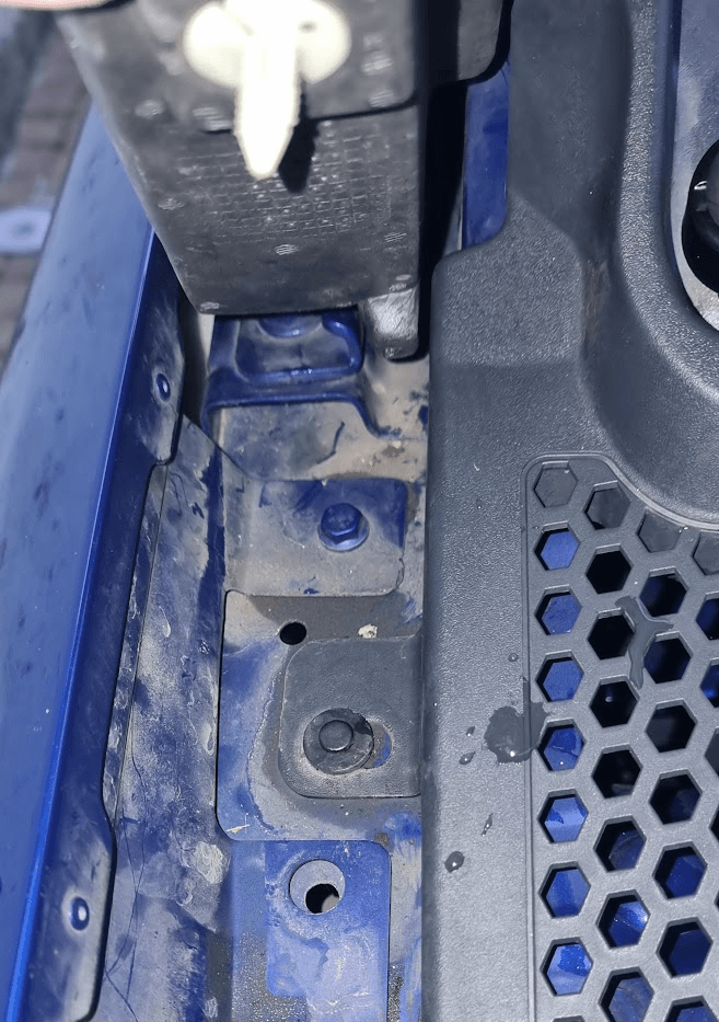

This led me to the area directly under the wipers, and under the scuttle tray, where there is a large drain hole.
Next to this drain hole, there is a rivet, which is where I believe the water is coming in from.

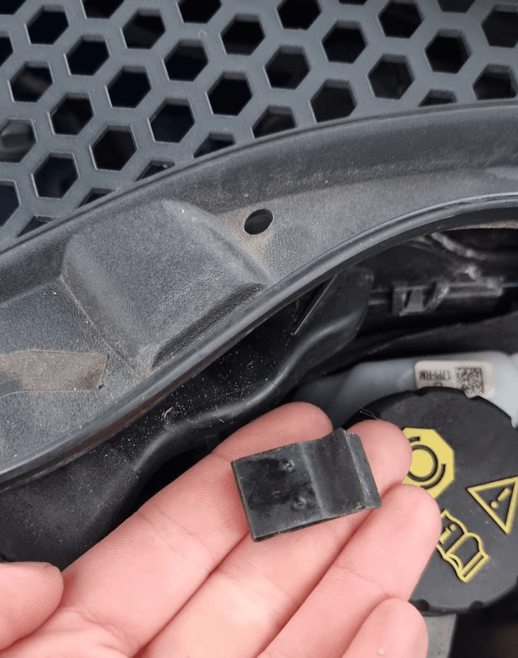

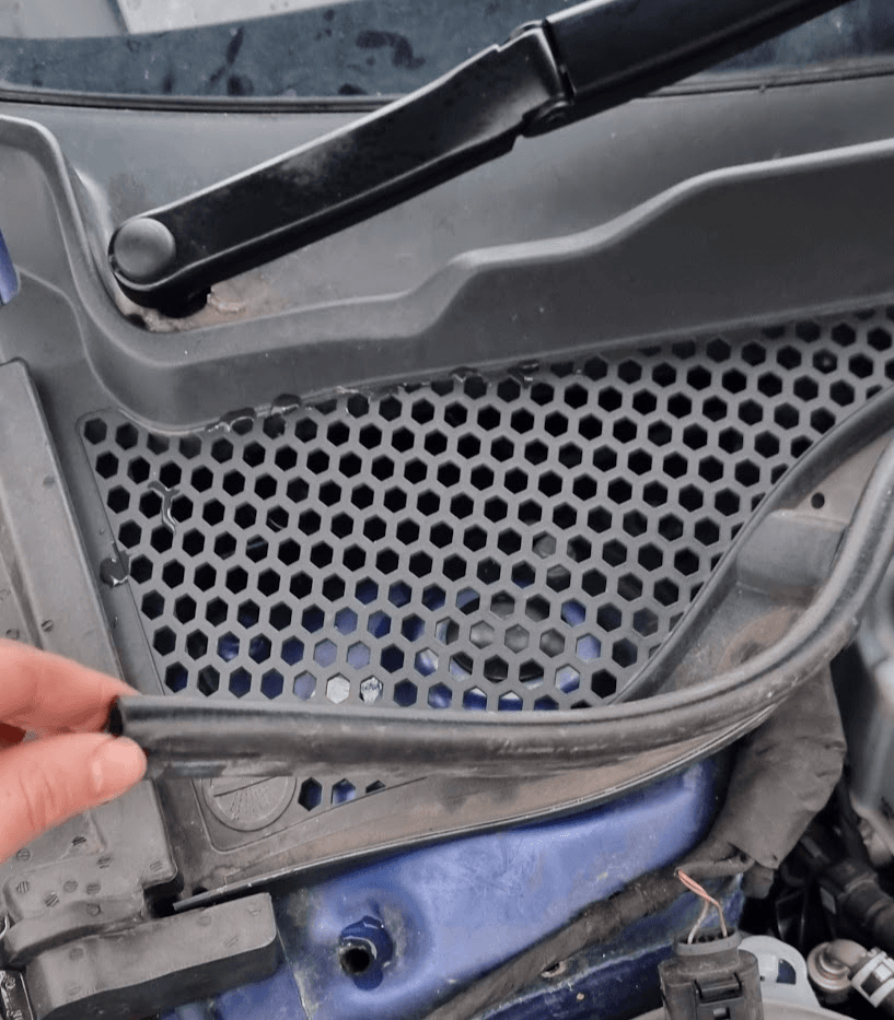

To get access to the rivet, I had to get under the bonnet and remove the rubber seal on the scuttle tray
Then lift up the foam piece at the side

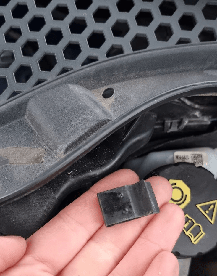

Under the foam, there is a plastic clip, which I removed with a specialised trim removal tool, but I'm sure this could also be done with a flat headed screwdriver.
There are then a further three other clips along the length of the scuttle tray which can be removed by hand, or with a flat headed screwdriver if they're stuck.
After that, it was just a simple case of cleaning off the rivet and smothering it in Flomasta external leak sealant that I got from Screwfix. This stuff can be applied to we surfaces as well as dry, which makes it ideal for sealing leaks in the winter.
I did a quick test and it doesn't seem to be leaking anymore, but the next rainfall will be the real test. Wish me luck, and I hope this helps somebody else out in the future, because with all the research I've done into this, I haven't seen anyone that's suggested this as a potential issue.

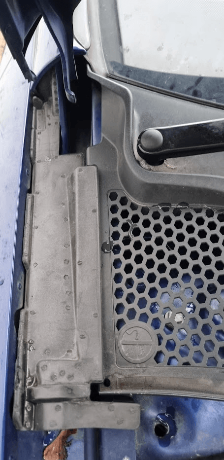

I've tried one last ditch effort to seal the area underneath the drain hole under the scuttle tray. Someone on the golfmk7 pages seemed to have a similar leak, so it's worth a shot https://www.golfmk7.com/forums/index.php?threads/water-leak-in-passenger-footwell.370645/page-3
I've done what's suggested in post #33, but I doubt it will help because neither side has seam sealer there but only one side is leaking, but we'll see.
If not, it looks like it's off to the dealer, because even though I hate their over inflated prices, they do deal with these cars day in day out, so will know its weak points before they even set eyes on it.
