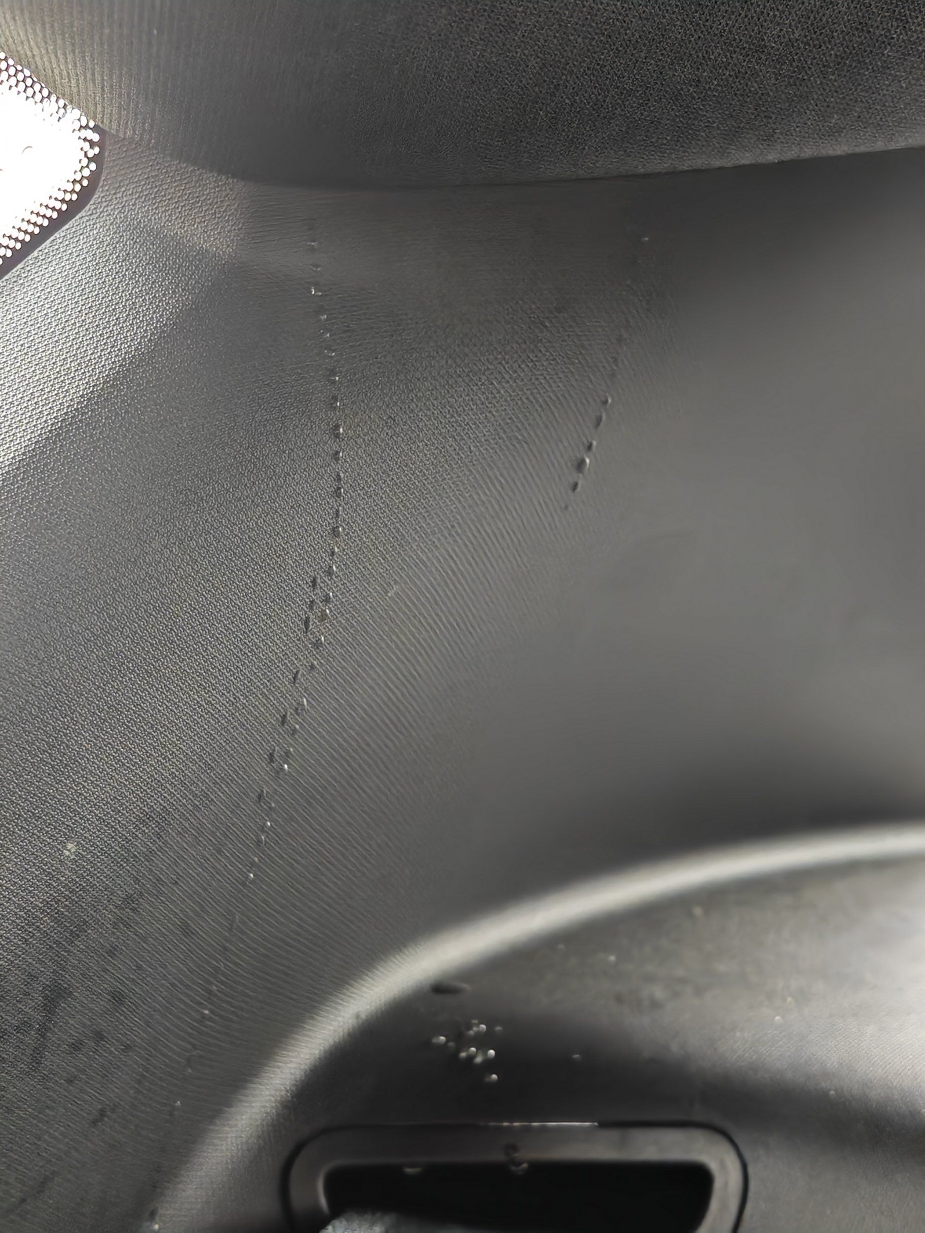

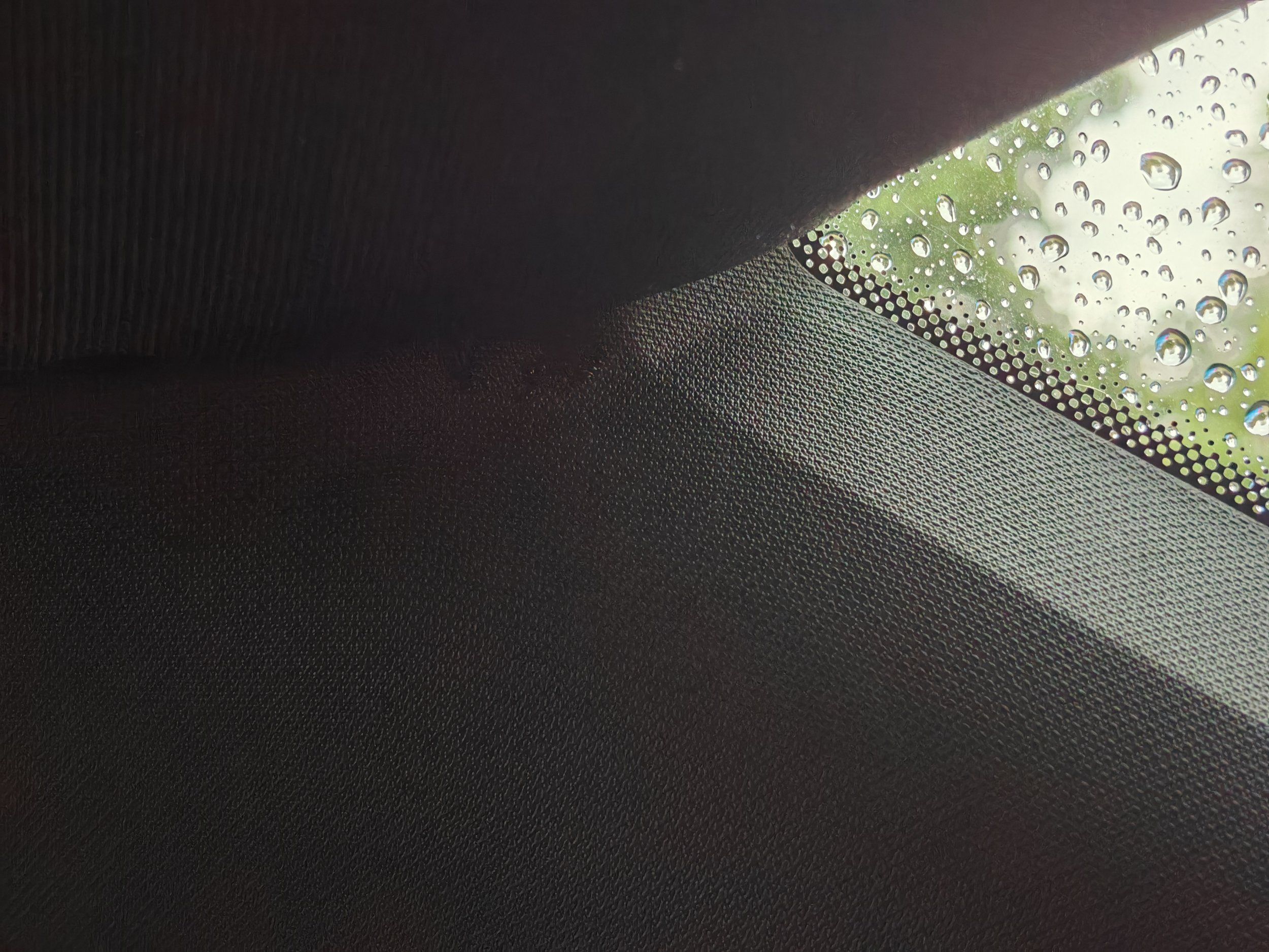

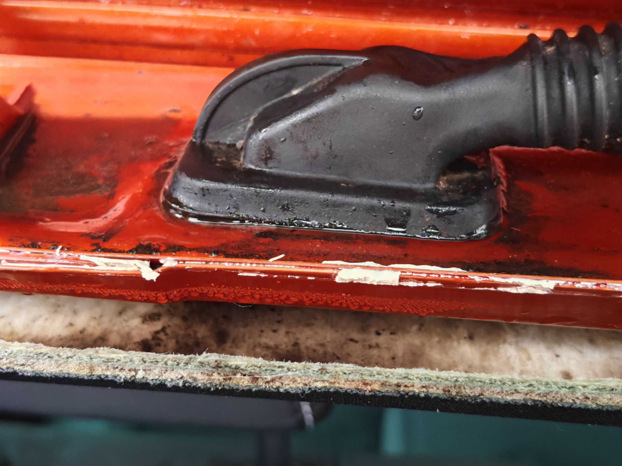

Hi all I know people have said about the boot floor puddles. I have a problem with left rear passenger seat soaked and the roof liner is wet near boot opening! I've pulled the liner down and as you can see in the pictures water is getting in from somewhere! Washer jet works properly so it's not that. The rear passenger window seals inside aren't wet so I'm stumped. Any ideas?

I would think it's water getting past the seal where the cable trunking meets the roof panel.

Yep, ? hopefully I've sorted it! I went over to my brother's who used to work for Audi and he said it had been super glued before and come unstuck! So we super glued it and used silicon to seal properly.
