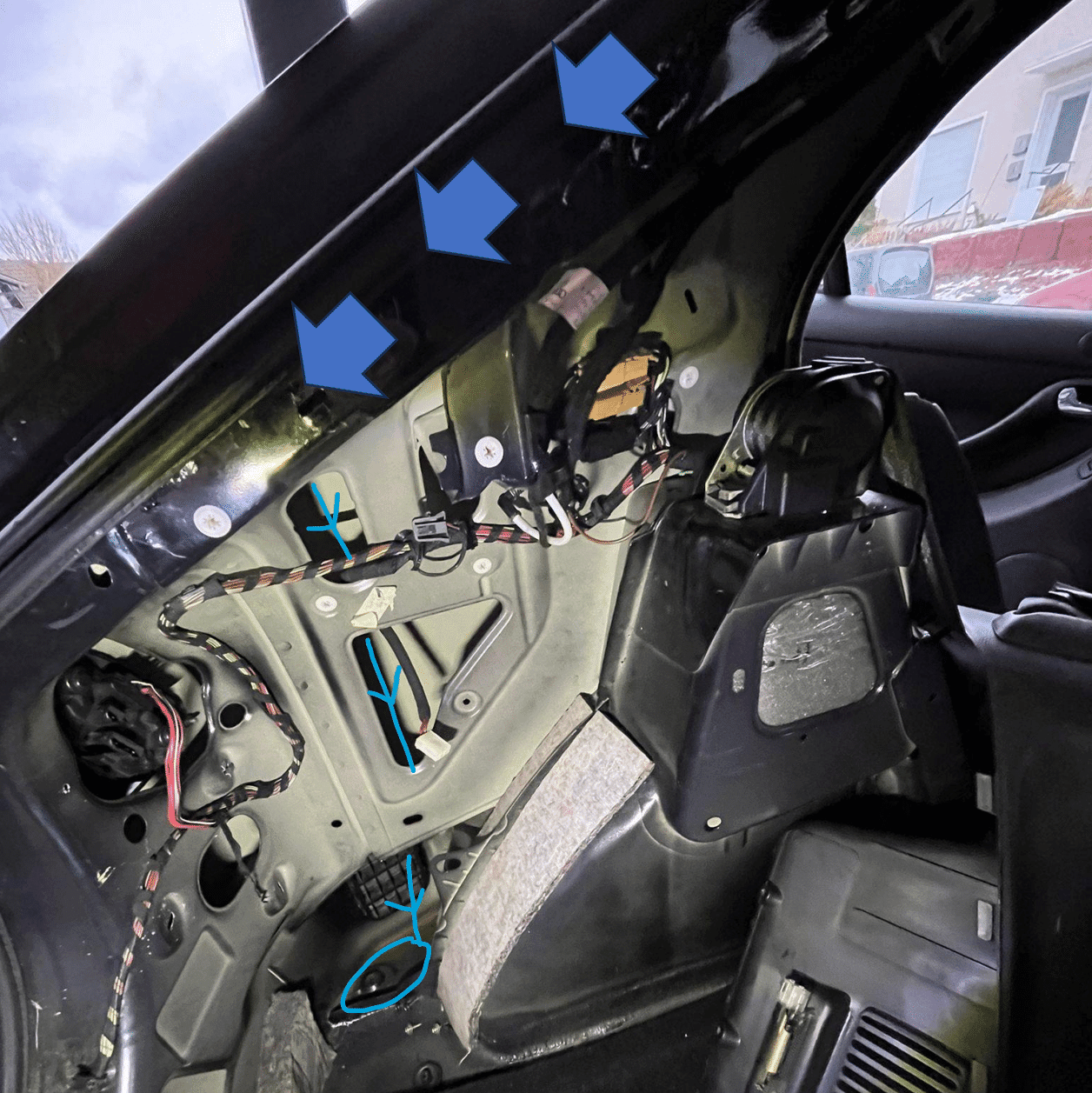

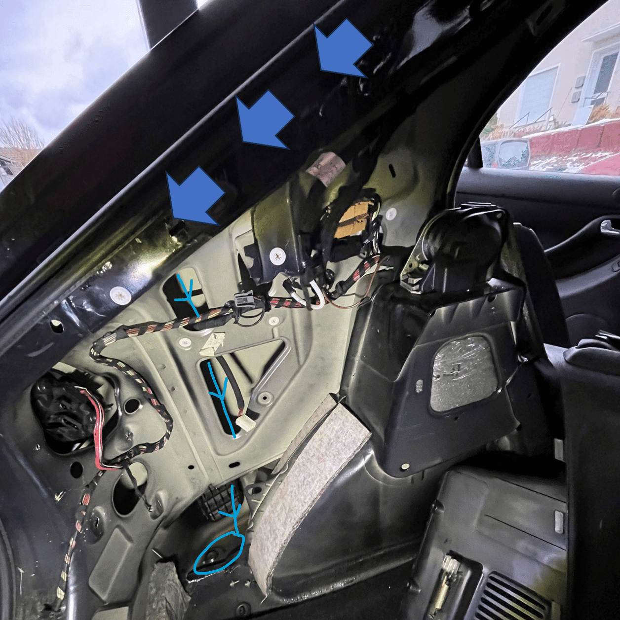

I have checked the washer lines ... they seem fine. Headliner is dry and no disconnected lines in sight.
This image shows the path of water ingress inside the car. The blue arrows indicate the direction the water takes on the inside of the pillar (Holm), tracing the vertical flow downwards. The blue lines mark the areas where the water runs along the inside surface of the outer side panel. At the bottom, the water collects, pooling in the lowest section near the floor.
You’ll know it if that connection is leaking , you wrap it in some tissue to see if it is slightly.. use a hose and run water outside and see if water runs in
