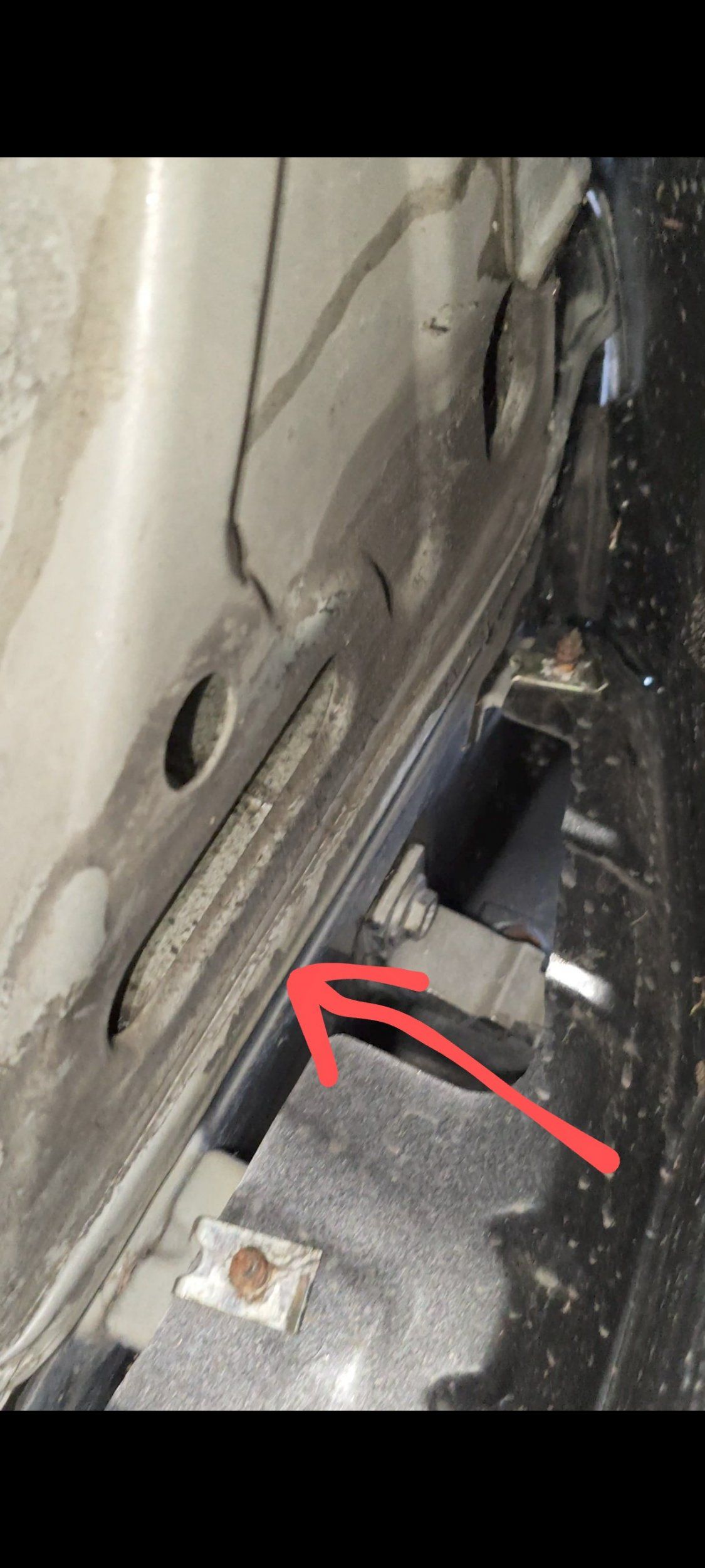

Front passenger side wheel liner was removed today. It was Raining so couldn't really do much without getting soaked.
Photo attached is from behind the passenger side Wing with the foam removed.
I suspect water is getting into what appears to be some form of cavity for unknown reasons.
I will remove the entire Wing tomorrow and see what's happening there.

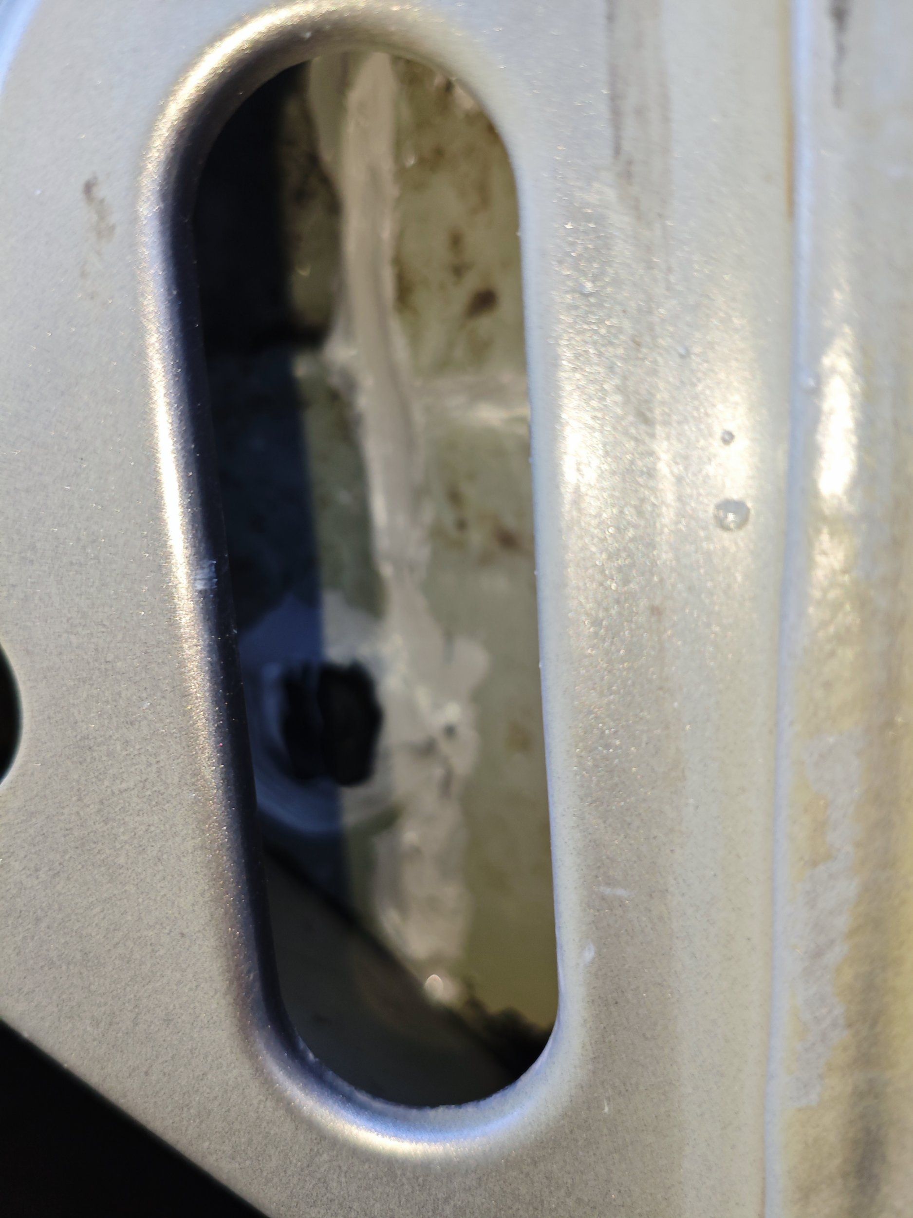

For me it was water getting through the gaps between the panels making the drainage hole(s) either side of the windscreen above the front wheel arch, see picture in post #24 and fix #28 it has been dry since, also think this is more likely to affect 2018 models, used dyed water and white tissue inside to trace where the water was getting in. Although reading other forums before there are hundred of places it can get in as mentioned above, good luck!

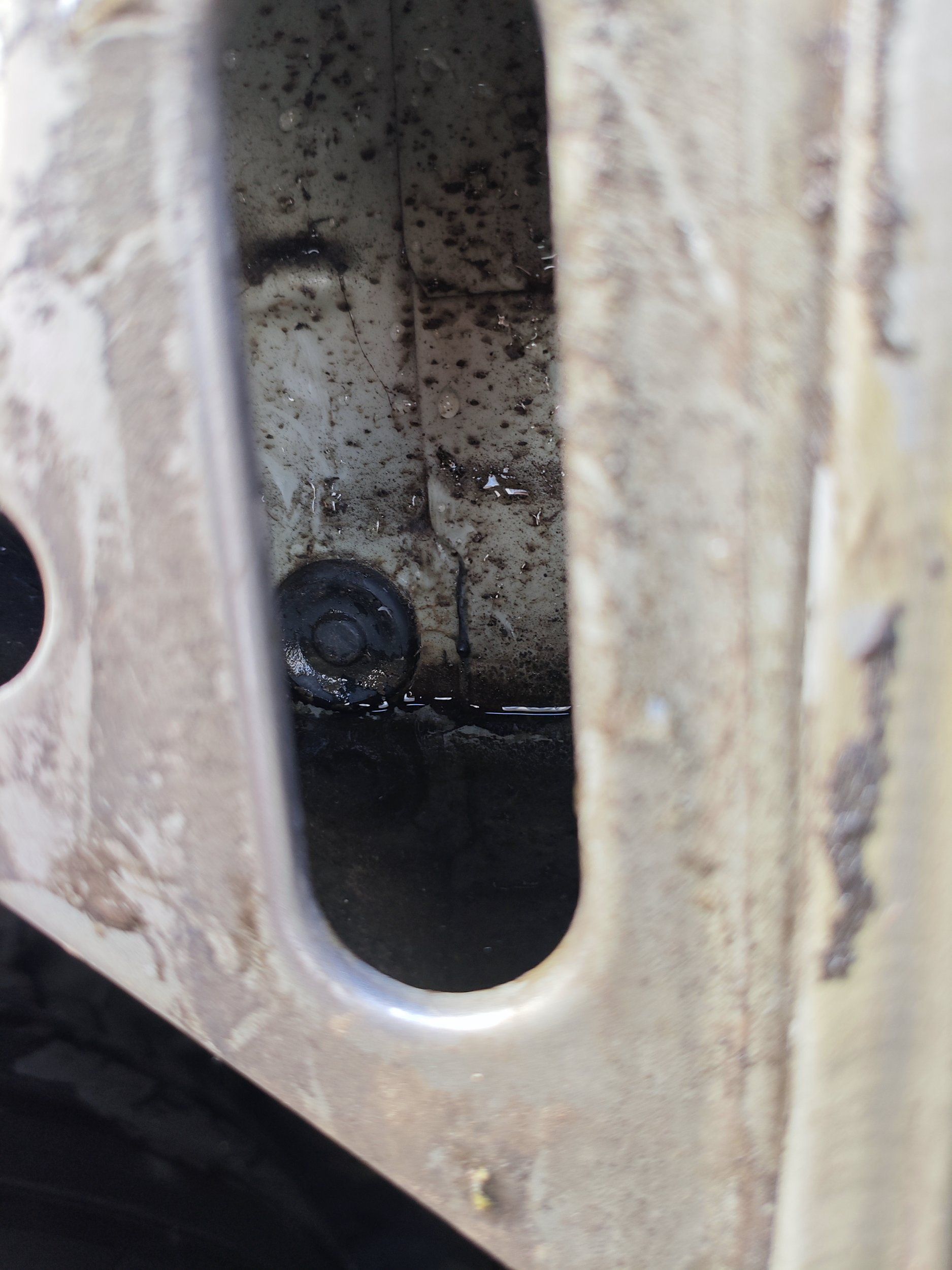

Front passenger wing taken off. Couldn't really see much to be honest.
I found a cavity which wasn't draining at all. It was all gunked up, I doubt this was the problem to be honest.
The leak occurs literally half an inch just above the grommet.
Sealant added and hoping for the best now.
